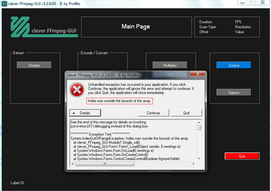

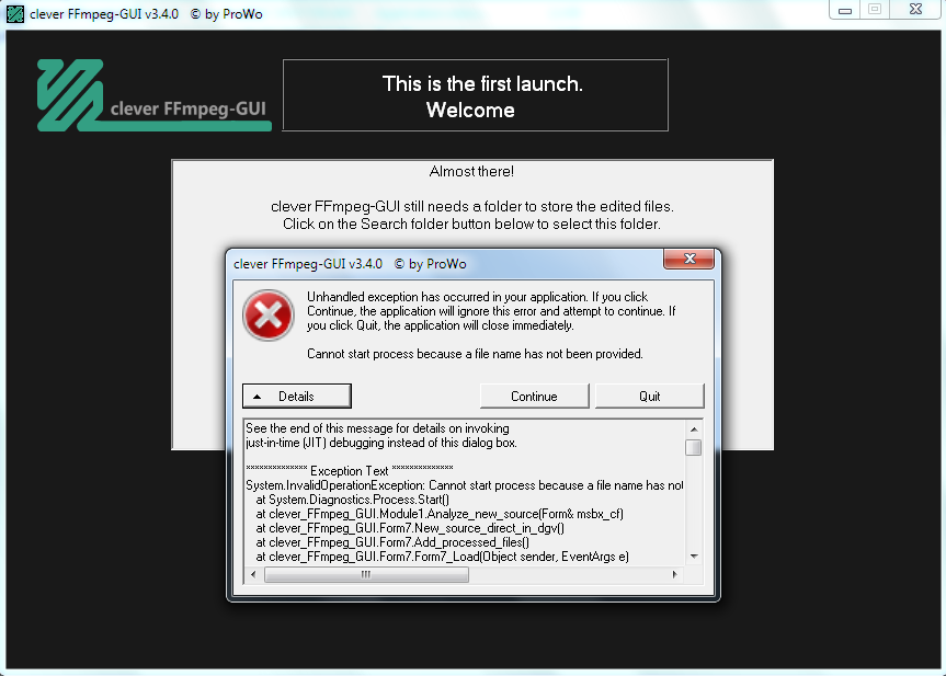

  7. @ProWo I was just wondering why I might be getting these Unhandled exception errors when I go through the initial start up of adding the ffmpeg bin folder & target folder, when the Unhandled exception error pops up & I press continue, it goes straight to the Multiplex screen & the "This is the first launch. Welcome" dialog box screen remains for some strange reason, I've tried using the latest ffmpeg 7.1.1 Static & Shared builds here https://forum.videohelp.com/threads/414767-ffmpeg-7-0-1-and-Windows-7#post2769089 which is where you had suggested I try as Windows 7 no longer supports Static or Shared builds officially only Essentials builds which is problematic with your program as we had discovered previously when certain functions didn't work properly, I've also tried the latest v3.3.9.05 Beta with the same Unhandled exception error, not quite sure what has possibly changed since I last used one of your Betas from around September or October of last year.
    [Attachment 86349 - Click to enlarge]
    [Attachment 86350 - Click to enlarge]
  8. Originally Posted by oniiz86 View Post
    1) Delete the file portable.config (in the folder with clever-FFmpeg-GUI.exe).
    2) Restart clever FFmpeg GUI.exe and follow the instructions (The programm ask for the bin folder with ffmpeg.exe, ffprobe.exe, and ffplay.exe in).
  9. Originally Posted by ProWo View Post

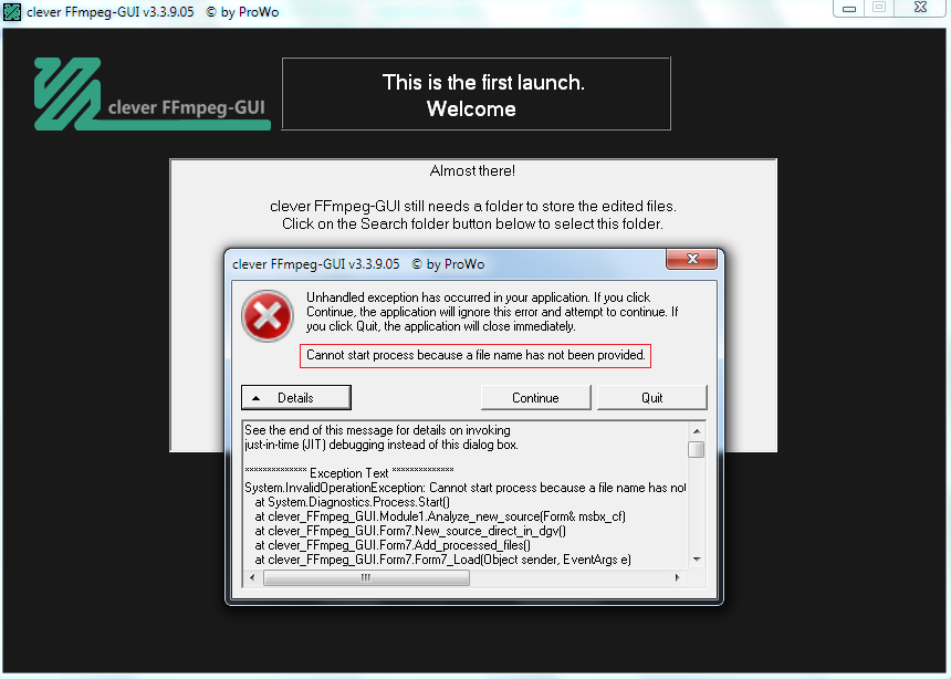

    Yeah I've tried that unsuccessfully, this is the error with v3.3.9.05 Beta, it mentions "Cannot start process because a file name has not been provided."
    [Attachment 86351 - Click to enlarge]
    I wish I held on to that previous Beta of yours, don't quite remember the version I had from around September or October as it was working fine with the non official FFmpeg builds for Windows 7, I guess it may have been something in your code that you have changed since then that will now no longer work with Windows 7.

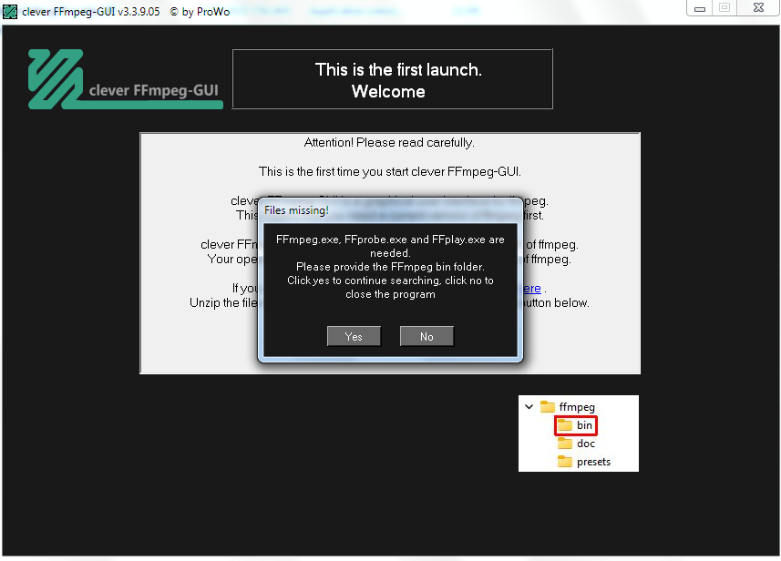

    I've tried to use the program but it appears it won't let me when I try to add a source file, another Unhandled exception error pops up with this message "Index was outside the bounds of array."
    [Attachment 86354 - Click to enlarge]
    Is the debugging text information of any help from where I click the "Details" button?
  10. Originally Posted by oniiz86 View Post
    Do you have this files in your ffmpeg bin folder?
    ffmpeg.exe
    ffplay.exe
    ffprobe.exe?
    You are the first to report such a problem.
    I have just tried it again and it works as expected.

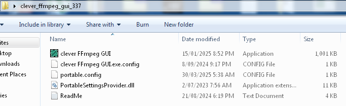

  11. Originally Posted by ProWo View Post
    ffmpeg.exe
    ffplay.exe
    ffprobe.exe?
    Yes those files are in the FFmpeg bin folder, is it possibly something that was changed in your code that Windows 7 no longer accepts, what exactly do these error messages "Cannot start process because a file name has not been provided." & "Index was outside the bounds of array." mean?
    [Attachment 86355 - Click to enlarge]
  12. Originally Posted by oniiz86 View Post
    No idea, but retry with the static version, where only the 3 files are in the bin folder.
    EDIT:
    Read on in the thread, there seem to be problems with these ffmpeg builds.
    EDIT2:

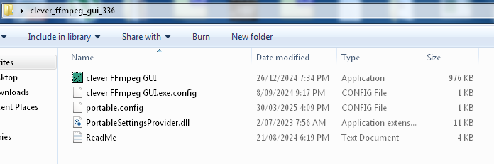

    Try to add .exe to the 3 files. It seems they are without suffix.

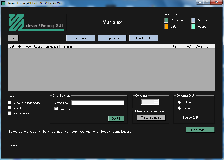

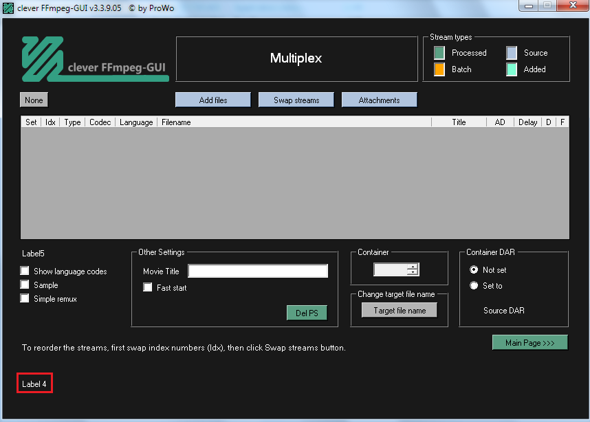

  14. Originally Posted by oniiz86 View Post
    do you know what the "Label 4" in the bottom left corner of the Multiplex screen means?
    Label4 is the label name, without info, because the program isn't fully working.
    As i said, try to add the .exe suffix to the 3 files.
    If this not works, retry with the last full release v3.3.9.

    EDIT2:
    Yeah I just tried that but it returns a "files missing!" error, I don't think the .exe suffix is necessary in this case, those 3 files have always been simply
    FFmpeg, FFprobe, FFplay & has worked with your program just fine.

  16. Originally Posted by ProWo View Post

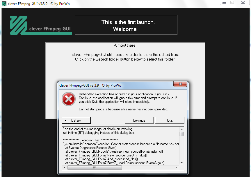

    Yes I've tried the official v3.3.9 release again & it exhibits the same behaviour, could it be something in your code that was changed from last October that will now no longer work with Windows 7?

  19. Originally Posted by oniiz86 View Post
    In the start code was changed nothing since 10/2024.
    Retry with an old version from 09/2024:
    https://www.videohelp.com/download/clever_ffmpeg_gui_330.zip
  20. Originally Posted by ProWo View Post
    Thanks so much for that, the official v3.3.0 version actually works fine with FFmpeg 7.1 Static build, would you be able to have v3.3.1 which was your official October 2024 release, what could be the issue then with your more recent builds, it's definitely a head scratcher?

  23. Originally Posted by ProWo View Post
    See here:
    https://www.videohelp.com/software/clever-FFmpeg-GUI/old-versions
    Thanks for that, I didn't realise you kept an archive of previous versions, I can confirm v3.3.0 to v3.3.6 has no such issues, something changed with v3.3.7 to v3.4.0 as I get that Unhandled exception error message that I had attached earlier, the issue is present from your January 2025 releases right up to the latest Official v3.4.0 release.
  24. @ProWo I was wondering if these changes mentioned in v3.3.7, Added "Check in reading BT_open.txt if the file exists." & "Many little cosmetics and code improvements.", perhaps the code improvements that were made has made your program with Windows 7 no longer compatible after v3.3.6? I just tried the latest FFmpeg 7.1.1 Static 64 Bit build with v3.3.6 & it works absolutely fine, so those non-official Windows 7 FFmpeg 7.1/7.1.1 builds appear to be okay, just no such luck with v3.3.7 onwards.
  25. Originally Posted by oniiz86 View Post
    With 3.3.7 I have added full portability.
    That gives me a doubt. Did you extract all files from the downloaded zip archive or just the exe?
    I think you are missing the two files:
    PortableSettingsProvider.dll and
    clever FFmpeg GUI.exe.config
    Download the latest release v3.4.0 again and
    Extract all files to the same folder where you want.
    Then start clever FFmpeg GUI.exe.
  26. Originally Posted by ProWo View Post
    I don't believe that is the case as v3.3.6 & v3.3.7 both share the exact same files, both these files PortableSettingsProvider.dll and
    clever FFmpeg GUI.exe.config are present as you can see below.
    [Attachment 86374 - Click to enlarge]
    [Attachment 86375 - Click to enlarge]
    I've just re-downloaded v3.4.0 again but no such luck the same Unhandled exception error unfortunately, this is so frustrating, not sure what is going on.
    [Attachment 86376 - Click to enlarge]
  27. Originally Posted by oniiz86 View Post
    You have PM
  28. @ ProWo
    3.3.9.05 Feedback
    App update behavior:
    When you click "Update" under "Settings & Update," only the "Settings & Update" button turns yellow when a new version is available. You have to click "Update" again to open the "New Version Available" window.
    I would expect that the "New version available" window opens at the first click on "Update".

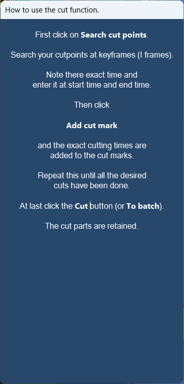

    > Formatting of Cut help, VirtualDub Help and Video preview help screens.
    When you open the Cut page, the Cut help screen disappears.
    What about this formatting?
    [Attachment 86380 - Click to enlarge]

  29. Originally Posted by ProWo View Post
    You have PM
    Thanks so much for that, I initially had no luck with your 3.4.0.01 Beta, the same Unhandled exception error occurred again but then I noticed a previously muxed file appeared in the Multiplex screen for some strange reason, so I had a look in my set Target folder & came across a PE_open & SWF text files along with previously muxed files that I had created with earlier versions of your program, I deleted those & would you believe it, the program works perfectly fine now, I tried v3.3.7 & the latest v3.4.0 also the v3.4.0.01 Beta you sent via PM without any issues at all, I'm so terribly sorry to have troubled you about this, thanks for being so gracious & very patient with a noobie like me, not quite sure why it mattered that I had previously muxed files in the Target folder made with earlier versions of your program that caused v3.3.7 onwards to falter & not work at all, anyway thanks so much again for your time.
  30. Originally Posted by Findu View Post
    Will be fixed
    Bug, will be fixed.
    Will be done.
