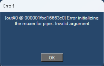

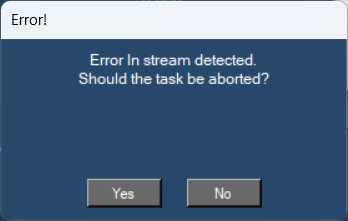

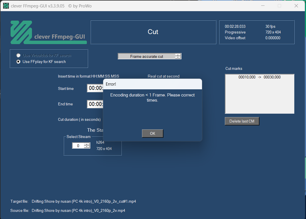

  3. When useing Frame accurate cut, and you click on Add cut mark, that button disappear.
    And it has problems with files containing more video streams.
    Sometimes stream 0 is fine, sometimes stream 1.
    Drifting Shore by nusan cut 2v.mkv
    [Attachment 86189 - Click to enlarge]
    And other errors with other sources:
    [Attachment 86190 - Click to enlarge]
    [Attachment 86191 - Click to enlarge]

    frame accurate cut is still in the experimental stage. Please use it only with h264 codec and videos with only one video stream.
    I will disable it again in the next release.
