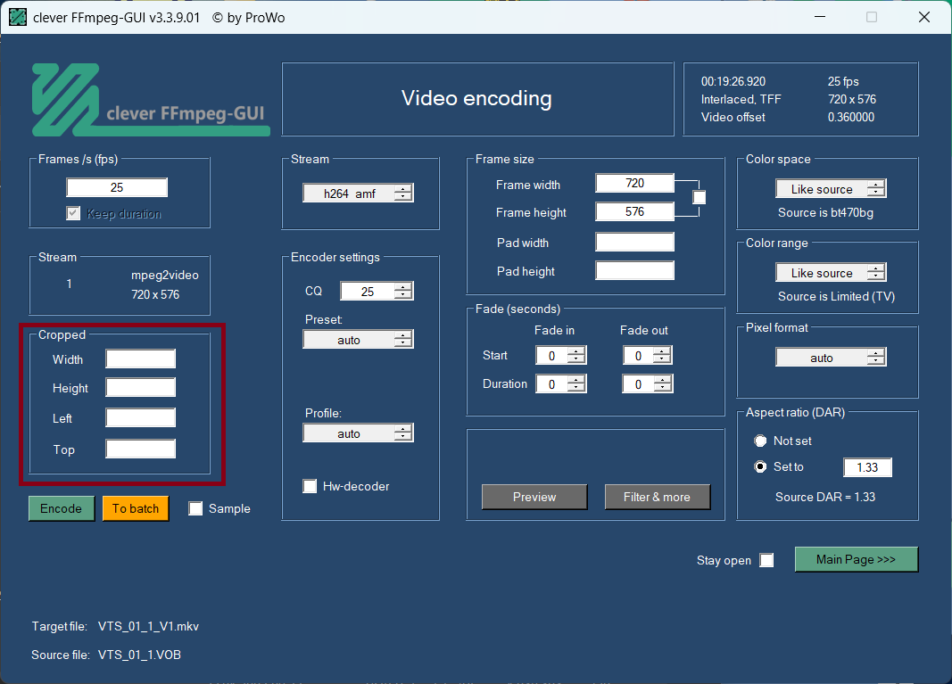

    Mapping is wrong using crop for a second or higher video stream (stream 1 and more)
    [vf#0:0 @ 000001499bad3b00] Error reinitializing filters!
    Video ---> h264_amf - Stream ID 0 from?C:\Users\Findu\Downloads\input.mkv?299958?-hide_banner -loglevel error -stats -y -fflags +genpts -i "C:\Users\Findu\Downloads\input.mkv" -vf fps=24000/1000,crop=1920:804:0:138,colorspace=all=bt709:iall =bt709 -map 0:0 -c:v h264_amf -rc 0 -qp_i 25 -qp_p 26 -qp_b 27 -aspect 2.39 -an -sn -dn -metadata:g encoding_tool="clever FFmpeg-GUI" ?C:\Users\Findu\Downloads\input_V0_#5.mkv?
    Could you post a small sample of such a video here to test?
    Stay open get reset comming from crop.
    Will be fixed.
    If I select HDR10/HLG to SDR, the preview button appear. But not for Keep HDR10 and the others. Intention?
    No, but mantaining the HDR10/HLG sidedata involves x265 params and ffplay cannot handle them, so the preview isn't available.
  2. @ ProWo
    I found the problem.
    When you get back from crop, working on stream 1 or higher, the stream resets to 0 and does not stay in the selection!!!
    [Attachment 85955 - Click to enlarge]

    When you open video stream the first time, the cropped part is visable.
    [Attachment 85958 - Click to enlarge]
    When you set crop for stream 0, switch to stream 1, the "Frame size" of stream 0 get loaded. When you switch back to stream 0 the "Frame size" of stream 1 get loaded.
    But when you click the "Cancel crops" button, it get reset to normal.
    BTW: "Cancel crops" - did you plan to keep the crops for all streams, till you click this?

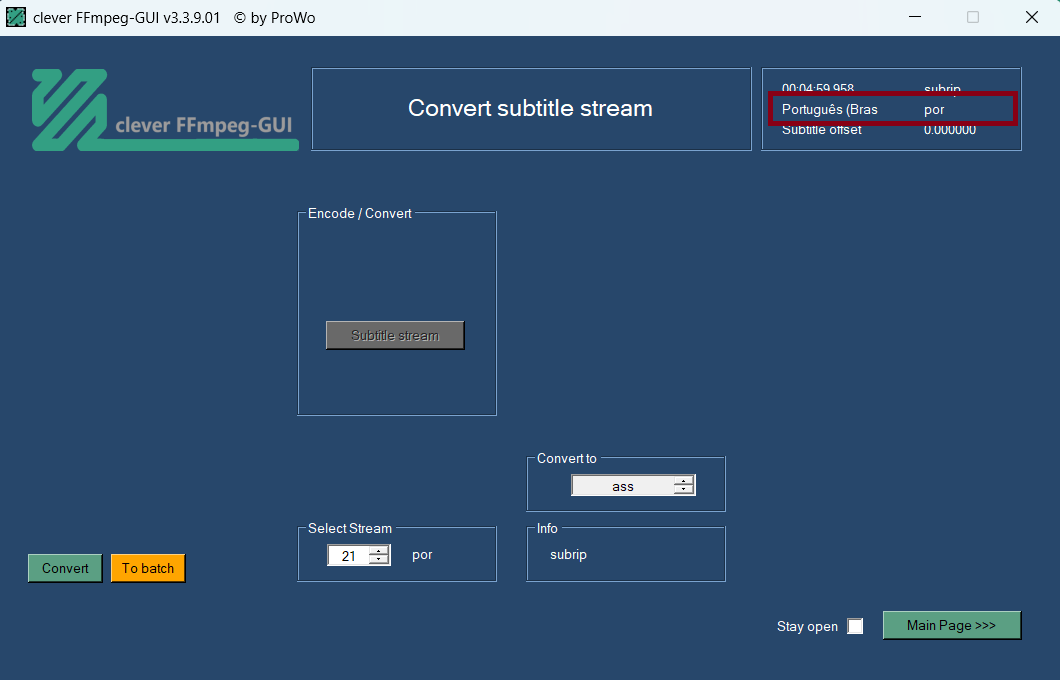

    Subtitel:
    The language title is cut too early because it looks like there is still some space left.
    [Attachment 85959 - Click to enlarge]
    Could you retain the last "Convert to" selection as it get reset to ass at app start as well.
    You have already changed this while the instance is running.
  6. Originally Posted by Findu View Post
    Bug, will be fixed.
    Already fixed in my actual beta.
    No, only the crops from the selected stream are used.
    Subtitel:
    Can't confirm this, it works as aspected for me. The last selection is saved an reused with the next start.

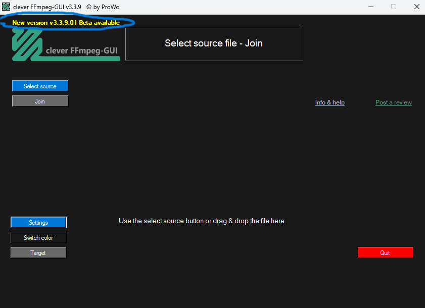

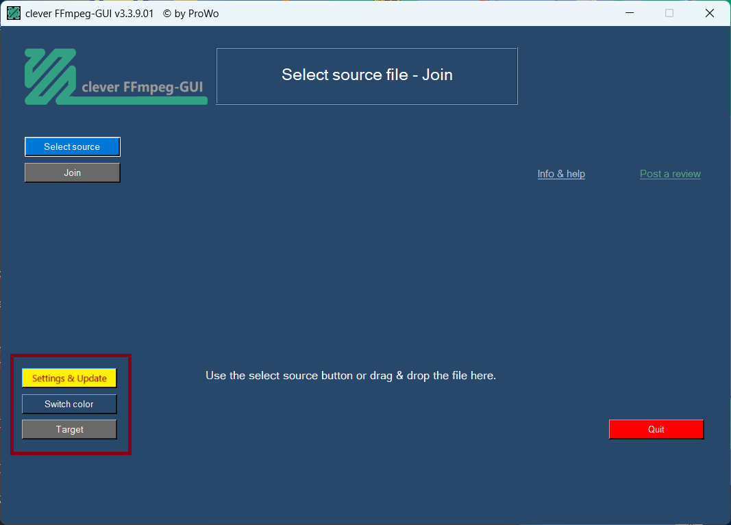

  11. Yellow update notification:
    A more subtle option would be to rename the button to "Settings & Update" and perhaps color it yellow. Both only when a newer version is available.
    [Attachment 85967 - Click to enlarge]

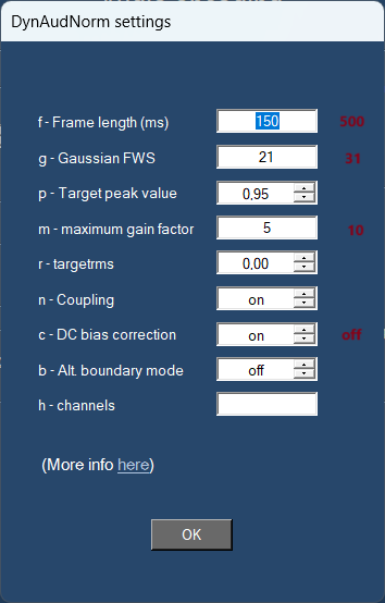

    Suggestion: I suspect that not all users know that your tool has an update function. Therefore, it might make sense to rename the Settings button to "Settings & Update".
    DynAudNorm has default values but some of yours are different. An error or intention?
    [Attachment 86037 - Click to enlarge]
    Yes, because the default values aren't optimal.

  26. @ ProWo

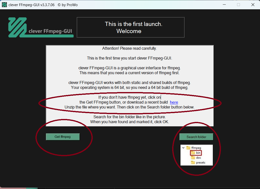

    NEW ffmpeg version 7.1.1
    Would it make sense to offer an automatic install/update (W10/11 64 bit only) for ffmpeg?
    Inexperienced users would benefit from less install/update effort and you could keep ffmpeg on one version to prevent probems.
    Experienced user can change/switch folder/versions for ffmpeg like before.
    You could use a modified first lauch page like this one: (see added text)
    [Attachment 86063 - Click to enlarge]
    After a click on the "Get ffmpeg" button, you could ask to allow the automatic download of the latest stable version into your app folder \ffmpeg\bin\, automatically extract the files and set the ffmpeg bin folder path used by your app.
    You take care for updates in the settings like you do for your app.
    But it doesn't realy matter if you don't want to waste time on it!

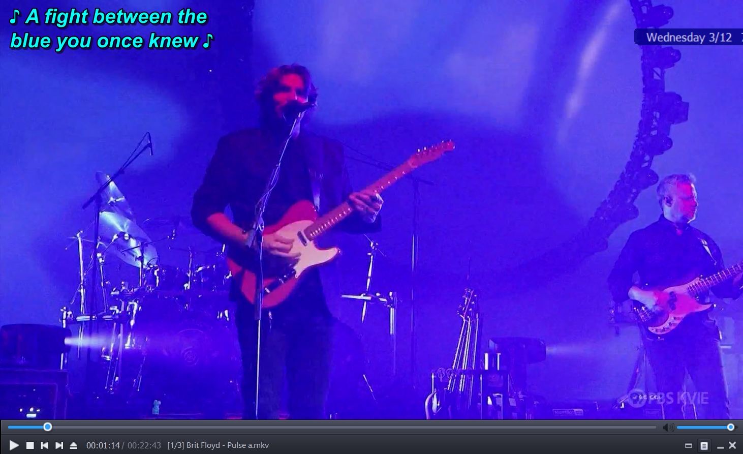

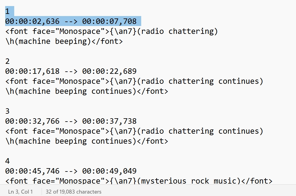

  29. Srt subtitle extracted from EIA 608/708 still retain Closed Captioning format with the "Fontface monospace" stuff. Normal srt subtitles don't have that. During playback, the subtitle stays in the upper left corner and is not adjustable like a normal srt sub. Can you fix it so it behaves like a true srt subtitle? Thanks.
    [Attachment 86073 - Click to enlarge]
    [Attachment 86072 - Click to enlarge]
