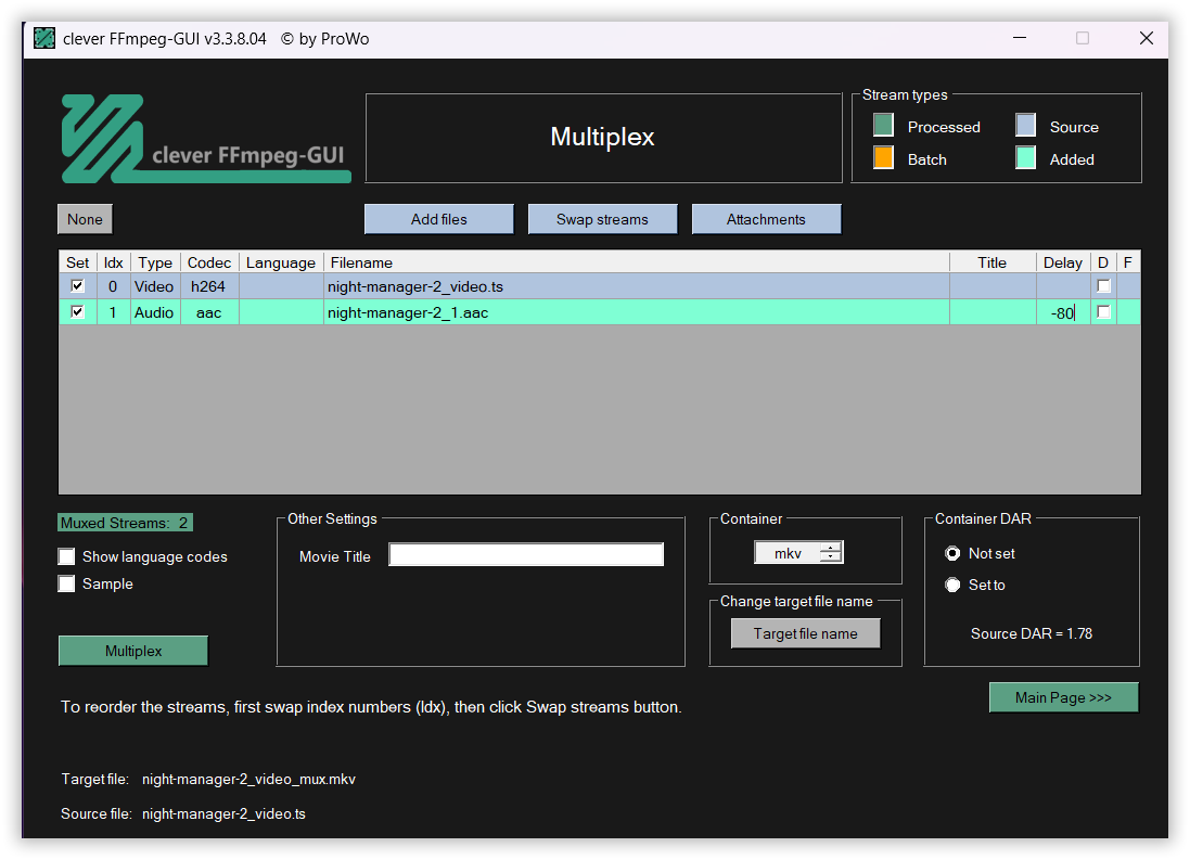

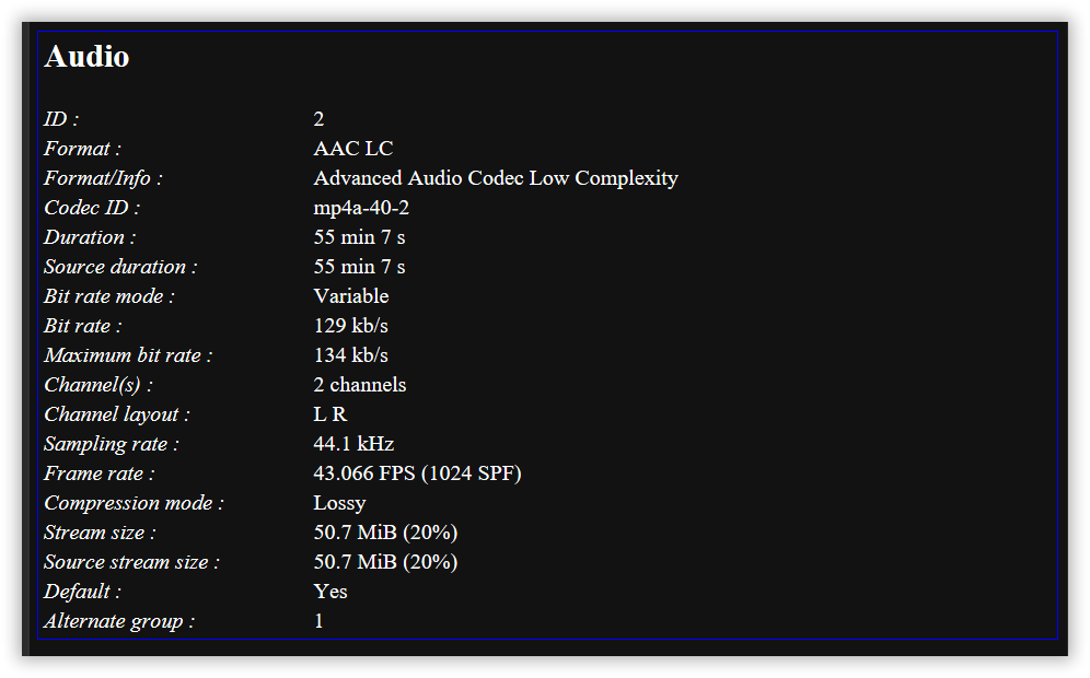

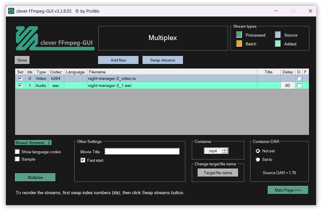

  2. issue with audio delay: i need to add video+audio (multiplex) with audio delay -80 ms. set on clever 80 but final mux file can't have delay (second shot is from MediaInfo)
    [Attachment 85678 - Click to enlarge]
    [Attachment 85679 - Click to enlarge]
  3. Originally Posted by lomero View Post
    If you need -80ms audio delay you have to set -80, not 80.
    With the mp4 container the delay is written but not shown. This is a problem with the ffmpeg mp4 muxer.
    Reload the muxed mp4 and see the video and audiostreams offset.
  4. tried also -80 and the same. no delay on final mux mp4. and yes, maybe MediaInfo can't show delay, but delay not present on final mp4 file
  5. Originally Posted by lomero View Post
    How did you check that?
    As a test mux to mkv and control with mediainfo.
  6. mediainfo can't show delay. right and understand. anyway i've try mux audio+video (with audio delay -80) and play final mp4 can't have delay
    tried also mkv as output and the same. i think need re-encode to have delay ... (also AI says this). but well if re-encode isn't necessary is better ! one work less
  7. Originally Posted by lomero View Post
    Ai is wrong, no need to reencode.
    I'll check this, when I have some time, and come back to you with the result.
  8. thanks. however already tried 80 and -80, final mp4 and also mkv. and all the same, no delay
    with re-encode
    ffmpeg -i video.ts -i audio.aac -filter_complex "[1:a]adelay=80|80[aud];[0:v][aud]concat=n=1:v=1:a=1" -c:v libx264 -c:a aac -strict experimental out.mp4
    finally delay is present

  10. Originally Posted by ProWo View Post
    Originally Posted by davidt1 View Post
    What I meant is when the program is closed and opened again, it defaults to mkv, always.
    Where (in what window) it defaults to mkv? What version do you use?
    In the multiplex window. I am using the latest stable version. Thanks.

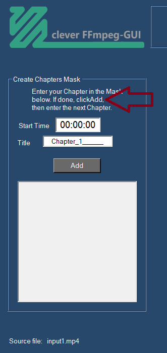

  12. @ ProWo
    3.3.8.04 Feedback 2
    Good idea to show the stream delay on the source page and put it in the multiplex grid.
    NEW smaller findings:
    The "Chapters help" window does not close when the window "FFplay play controls" open.
    The window "FFplay play controls" does not appear on the Various -> Crop page.
    I think it would be good if the chapter preview included the information for I/P/B frames.
    A space is missing between clickAdd at the Chapters page.

  17. Originally Posted by Findu View Post
    It is not supposed to, it is covered by the ffplay controls help as long as ffplay is active and is available again afterwards.
    That makes no sense here either, the video preview here only serves to display the crop result.
    What for? The preview in chapters is used to find the chapter times, you don't need this information for that.
    Will be fixed.
  18. Originally Posted by lomero View Post
    mediainfo can't show delay. right and understand. anyway i've try mux audio+video (with audio delay -80) and play final mp4 can't have delay, tried also mkv as output and the same.
    Not true, with mkv it works fine (tested!), with mp4/mov not.
    Will see, what can be done for mp4/mov.
  19. Originally Posted by ProWo View Post
    for me mp4 container or mkv is the same. and i also did a test (before posting here) and for me the final mkv had no audio delay. with code on my post#1628 finally i have delay. but re-encoded needed. i will do more tests
    edit: again another test just now. and i confirm, muxed on mkv delay still not present ... here clever shot
    [Attachment 85705 - Click to enlarge]

  24. @ProWo
    since final mkv with audio delay work for you but not for me try with my video, just 5 min. already set on mux audio delay -80, but as you can see audio is not sync with video. try yourself to add delay, without re-encoding
    https://files.videohelp.com/u/287921/night-manager_mux-0001.mkv
  25. Originally Posted by lomero View Post
    @ProWo
    Insert -1450 as delay into the aac row and mux to mp4 or mkv.
  26. Originally Posted by ProWo View Post
    wonderful work great. how did you get 1450 ?

  28. Originally Posted by lomero View Post
    VLC Player, Tools, Track Synchronization, Audio Track Synchronization.
