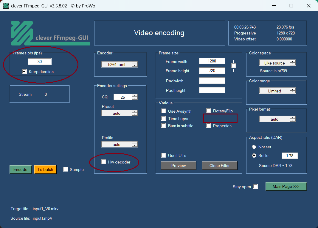

    Is here multiplexing required as original audio is limited to factor 2 and generally make less sense like original subtitles?
    Could you center the tow fps elements as it looks nicer.
    Maybee also move the checkbox in front of the Hw-decoder text.
    Does the red box area in filter also contain a function?
    The HDR checkbox (for HDR sources only). I'll will move it down.

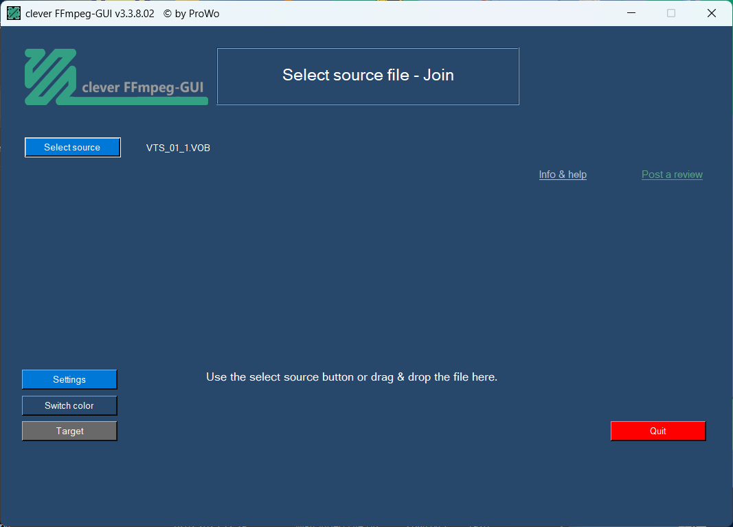

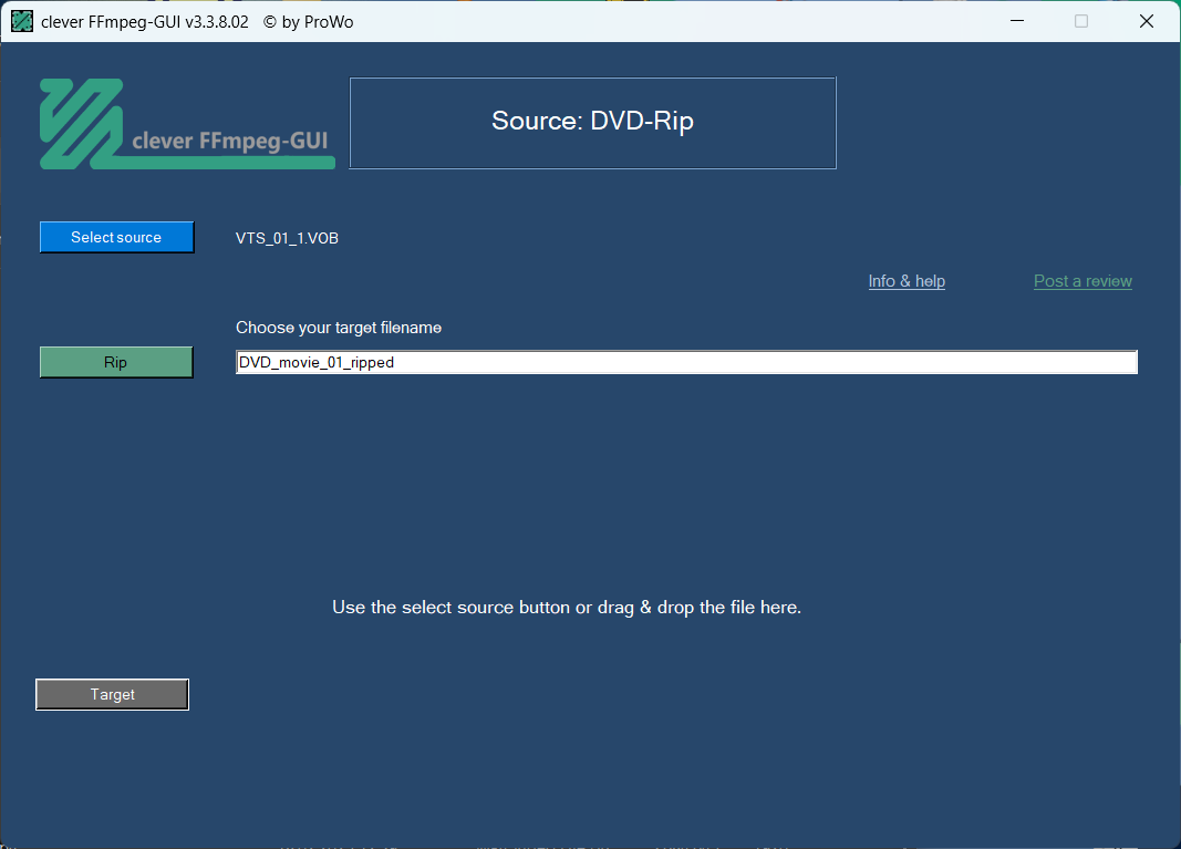

    When you drop a vob to the Desktop Icon and click Yes, the rip section does not get loaded.
    [Attachment 85593 - Click to enlarge]
    The rip page could have a Quit button. Otherwise you need to x the app or start ripping and Abort, if you change your mind.

  7. Originally Posted by Findu View Post
    DVD handling:
    When your source is a vob and you click Source on the Main page, the "Pssible DVD source" window pop up, with click on Yes, the rip section does not get loaded.
    This happens, if the DVD is copy protected.
    clever FFmpeg-GUI cannot handle protected DVD's.
    I could implement a message for this case.

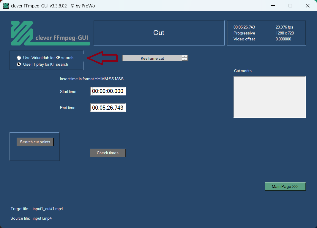

    When you select "Use VirtualDub for KF search" and you dont complete that, the selection remain. It better fall back to use ffplay.

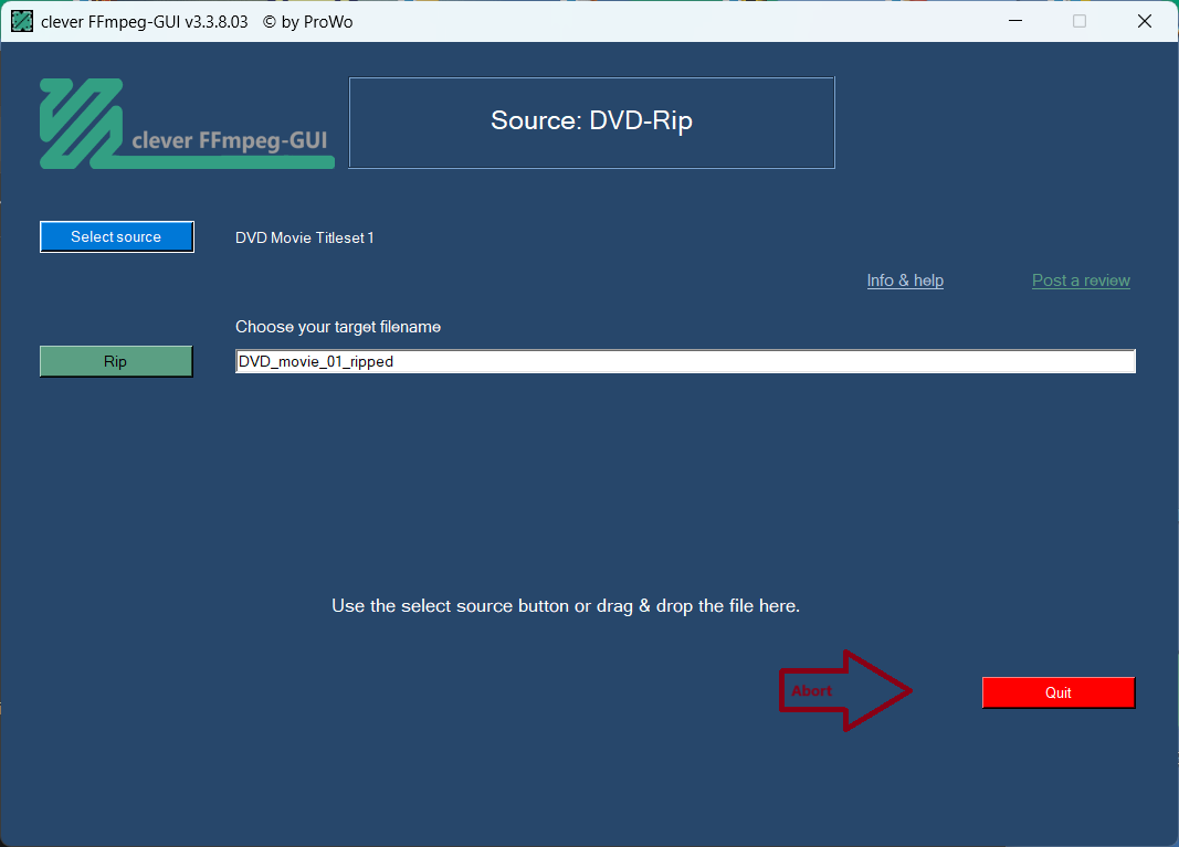

    DVD handling:
    Now, the Rip section is loading when you drop files to the desktop icon. Also when you get back from the Main page. Ripping also works.
    Working longer with it, it make more sense to Abort instead to Quit. Sorry!
    [Attachment 85658 - Click to enlarge]
    When you get back from the Main page and click Yes than Rip, Quit dont change to Abort.
    Will add a fallback to ffplay in the event that the search for virtualdub2 is aborted.
    DVD handling:
    Can you explain the process in more detail?

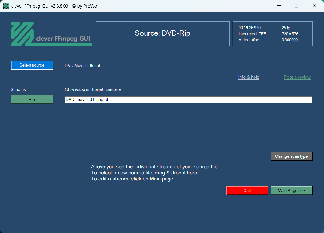

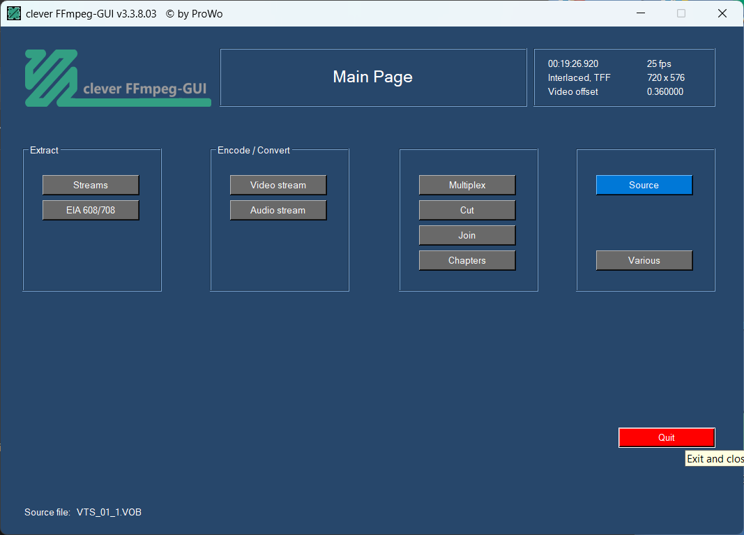

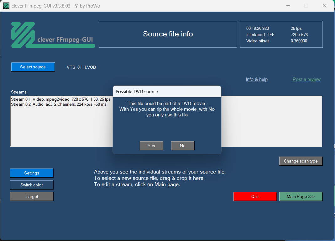

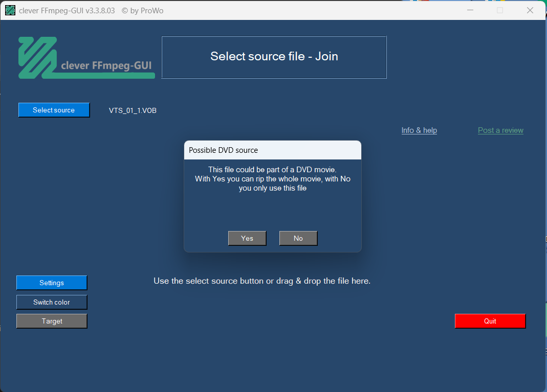

    When your source is a vob, your at the Main page, click Source, the window for full or partial rip appear, you ckick Yes for full rip and have the Quit button in the bottom right corner, when you click on Rip the Quit button should change to Abort to abort the ripping process.

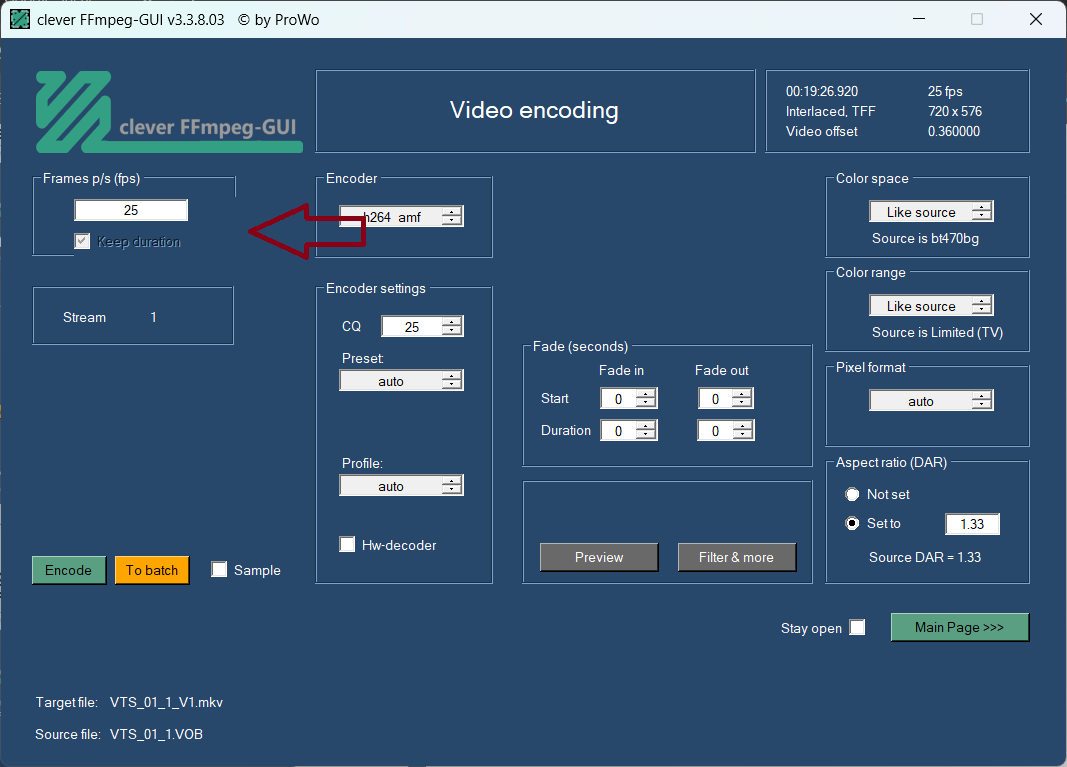

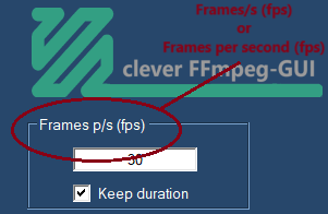

    Littet text mistake. fps is frames per second. So it is Frames/s.
    [Attachment 85662 - Click to enlarge]

    I can't reproduce that here.
    To get to the main page at all, the vob file must first be analyzed.
    If I then click on main page and then on source, I get back to the start page with the analyzed and still loaded vob file.
    No query opens and no rip is possible unless I select a new file.

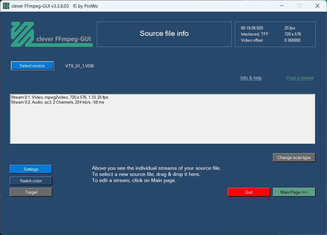

  20. > I can't reproduce that here.
    Strange! Fo me, the query opens.
    Here again the full path:
    Drop file to the desktop icon
    [Attachment 85663 - Click to enlarge]
    click No
    [Attachment 85664 - Click to enlarge]
    click Main Page
    [Attachment 85665 - Click to enlarge]
    click Source
    [Attachment 85666 - Click to enlarge]
    click Yes
    [Attachment 85667 - Click to enlarge]
  21. Originally Posted by Findu View Post
    Using your code: The video plays centered, including the text box with the actual frame details. The text box is equal for W10/11 64 bit.
    OK, then on your Win10 computer is missing arialn.ttf font. I'll change this font to segoeui.ttf.
  22. Originally Posted by Findu View Post
    click No
    click Main Page
    click Source
    click Yes
    You're right, this will be fixed.
