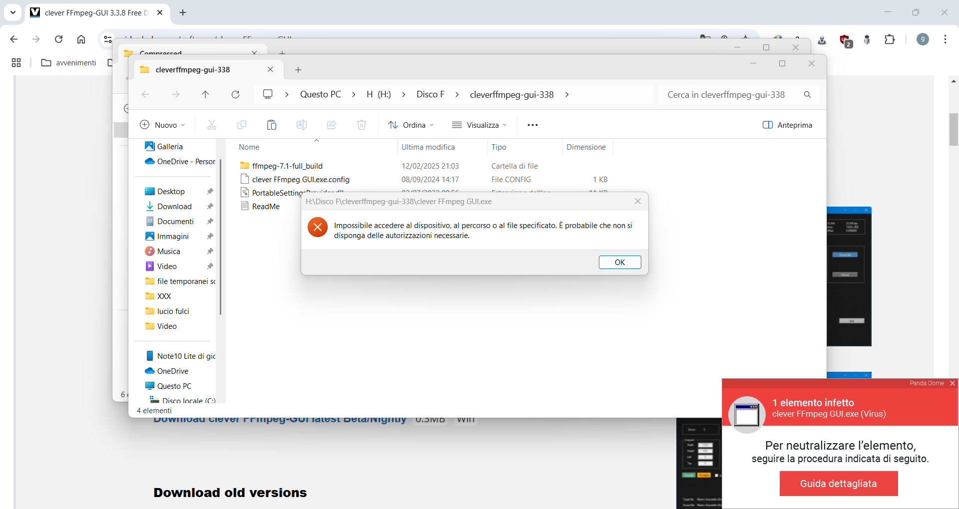

  6. Image
    [Attachment 85438 - Click to enlarge]
    Hi Prowo.
    When I try to install after downloading and extracting the files I get this screen. Where am I going wrong? It didn't happen before.

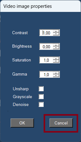

  7. @ ProWo
    3.3.8 Feedback
    Thanks for adding the grayscale filter (-vf hue=s=0) and to align the two buttons on the Video encoding page.
    Unfortunately, the grayscale filter cannot be deactivated when it has been set once. Only when you leave the page.
  8. Originally Posted by jopavirando View Post
    Hi Prowo.
    You do not have write permissions in this folder, so you cannot extract the files here.
    Give yourself write permissions or unzip the folder somewhere else.
  9. Originally Posted by Findu View Post
    This is a bug (missing reset) and will be fixed soon.

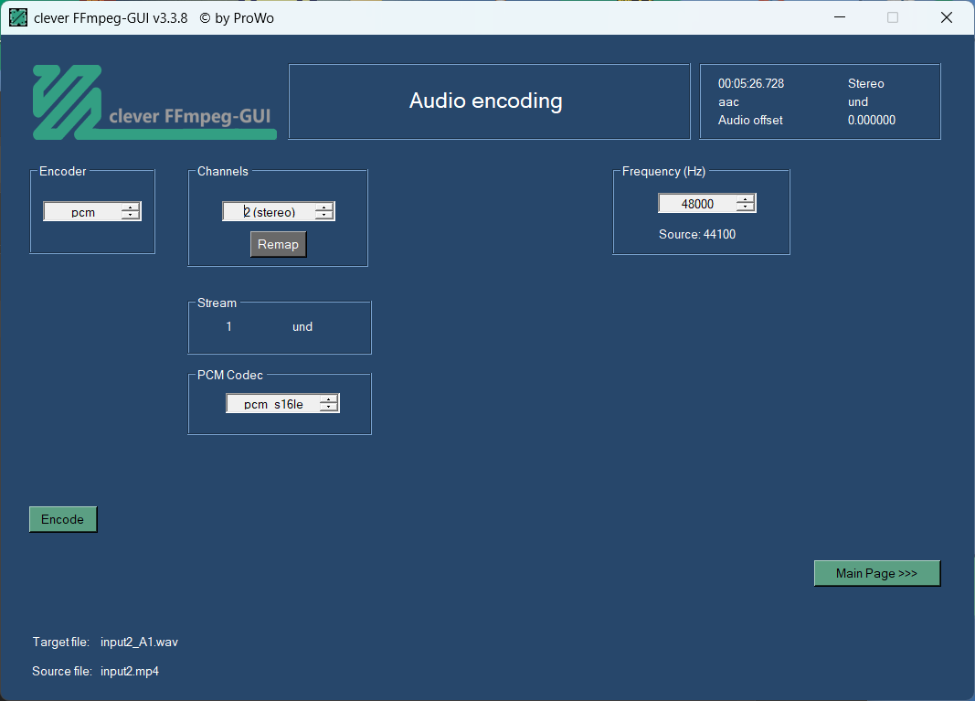

  10. @ ProWo
    3.3.8 Feedback 2
    Audio encoding -> Channels, switch behavior
    Channels contain:
    Join channels
    Split channels
    8 to 6
    8
    7
    6
    5
    4
    3
    2 (stereo)
    1 (mono)
    When the Encoder is other than pcm and the Channels are 8 to 6, with the next click up, the Encoder switch to pcm with the number of source channels but that page has missing options.
    [Attachment 85441 - Click to enlarge]
    I would expect to see pcm and Split channels after a click up from 8 to 6.

  14. Originally Posted by Findu View Post
    I'll change this behavior in the next beta.

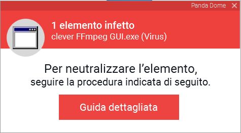

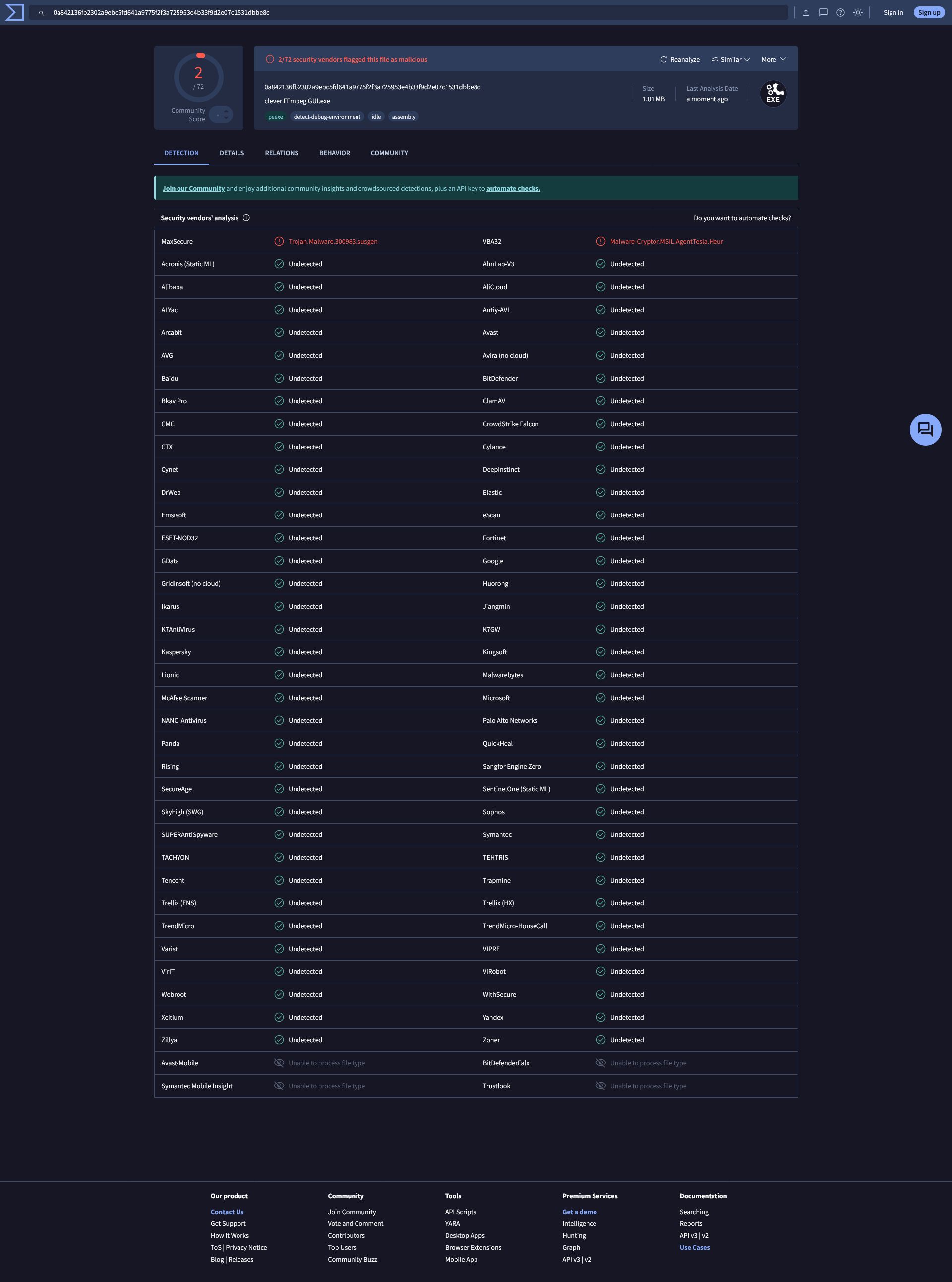

  15. Originally Posted by jopavirando View Post
    By the way: Your Panda Antivirus is wrong, the file does not contain any virus.
    Also: If you have Windows 10 or 11 as your operating system, you don't need any other antivirus program apart from the built-in Defender, which has become really good in the meantime.
    [Attachment 85457 - Click to enlarge]
  16. Originally Posted by ProWo View Post
    so if during installation i block Panda it should work. I will try, Thanks.

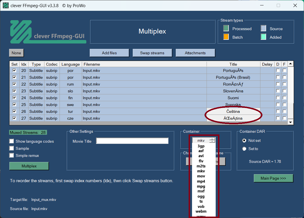

  17. @ ProWo
    3.3.8 Feedback 3
    Changes in UTF-8 text after muxing?
    When I copy Čeština in the title box and multiplex, the generated file and text show up as ÄŒeÅ¡tina
    [Attachment 85468 - Click to enlarge]
    Question: Does your GUI support drop down lists like this ugly self painted example?
  18. Originally Posted by Findu View Post
    This is a bug that has not yet been fixed, but I have discovered the reason.
    The problem so far has been that this error does not exist in my developer environment and only appears in compiled form; so far I have not noticed it.
    In any case, the data is written correctly to the video file. You can check this by playing the video in VLC, for example, and viewing the title entries, which are displayed correctly. This means that the display error is limited to my GUI and will be fixed in the next beta.
    No, my program is developed as winforms and winforms does not support DropDown lists.
  19. Originally Posted by jopavirando View Post
    f I block Panda the program opens normally. Strange because Panda does not block previous versions. I don't know.
    I can't block Panda every time I open the program.
  20. Originally Posted by jopavirando View Post
    Look at the result of virustotal; only 2 out of 72 scanners have something wrong (no idea what). panda also found nothing. As already said, false alarm.
    update your panda or add an exception for the program. Better still, uninstall the superfluous stuff completely.
    [Attachment 85491 - Click to enlarge]
  21. Originally Posted by ProWo View Post
    I set the folder as an exception in Panda antivirus and now it opens regularly. I don't understand what you find because the folders of previous versions opened and open regularlyImage
    [Attachment 85492 - Click to enlarge]
  22. Originally Posted by jopavirando View Post
    I don't understand what you find because the folders of previous versions opened and open regularly]
    You have to ask the panda developers.

    I can confirm propper working for:
    Grayscale filter reset.
    Change audio Channels switch behavior.
    UTF-8 display error.
    Many thanks for your investigation and quick update.
    Sad, but no problem that your app does not support DropDown lists!
    I just noticed that MP4 files don't show existing titles.

  25. Originally Posted by Findu View Post
    In the players, yes, but not in the Gui.
    This is an ffmpeg bug; stream tags are not read from mp4.

    Suggestion for video filters "Video image properties" window.
    I think it takes several attempts to find suitable values ​​here. Therefore it would make sense to keep the changed values when you reopen that window to be able to preview and modify it step by step if required. You could add a Cancle button like in "Burn in subtitle" to reset things.
    [Attachment 85534 - Click to enlarge]
    To avoid old filters being adopted, I leave it as it is now. You can see exactly which filters are selected with the checkbox. If you deselect the filter, it is reset. There is also a reminder of how many filters are set.
    An alternative could be to insert a preview button instead of a cancel button, so the "Video image properties" window remain open for further visible changes.

  30. Originally Posted by Findu View Post
    This does not work because the filter chain can only be written after pressing the OK button.
