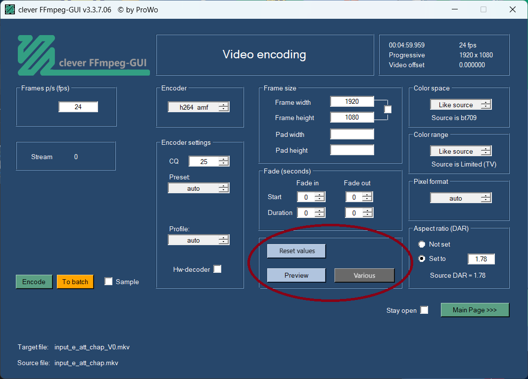

  2. Originally Posted by Findu View Post
    If you activate sorting for the filename column, then you wouldn't have to scroll through the very long table so much.
    Good idea, will try it.
    Would you change the drop down oder for growing numbers like you did for frequency?
    Crop detection Round, Various P-Level and Various Rotate.
    Will be done.
    Maybe it's time to replace the older screenshots from version 3.0.2 on this page. Because of several changes to some pages in the meantime.
    When I have time...

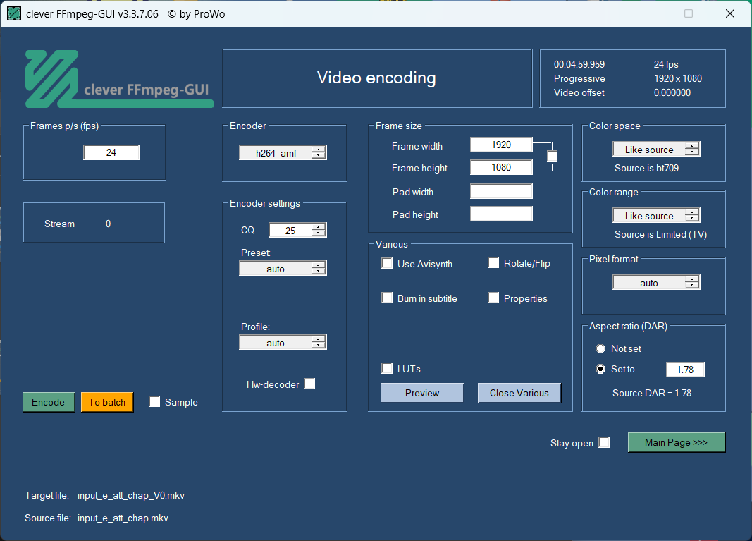

  3. Nice new screenshots with good color

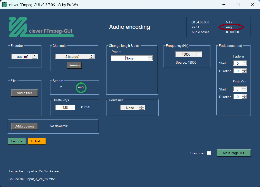

    Why does aac audio do not show the bitrate?

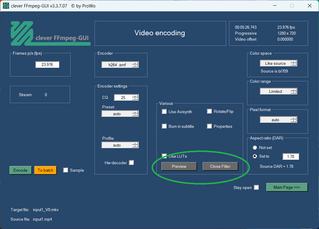

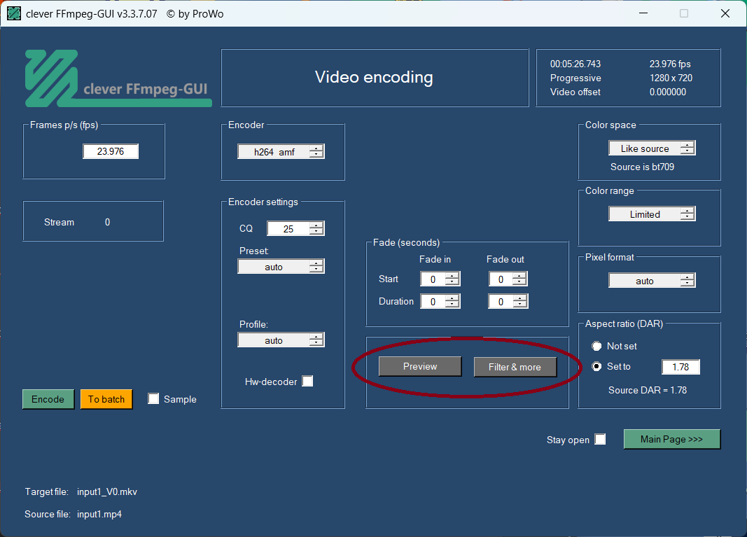

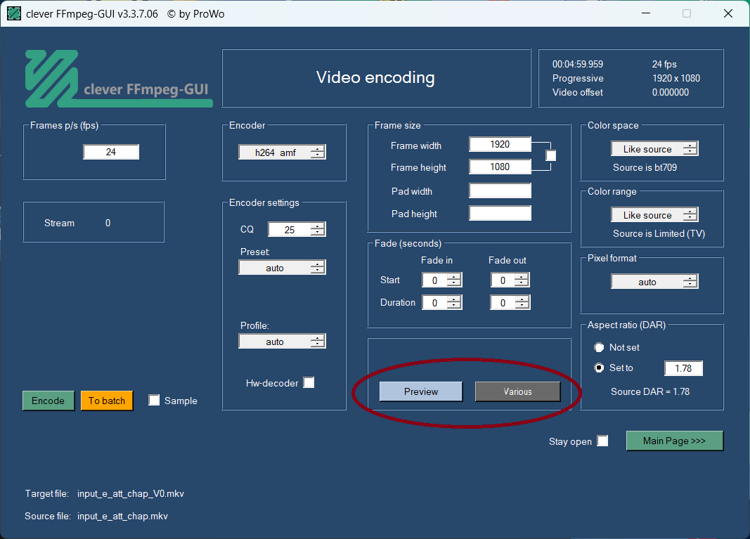

    What about this change to be able to use Preview without open Various?
    [Attachment 85212 - Click to enlarge]
    [Attachment 85213 - Click to enlarge]
    If you mux to mkv, the aac bitrate tag is missing, because the ffmpeg mkv muxer omit it.
    If you mux to mp4, the tag is written.
    Will be done.
    Thanks for the explanation.

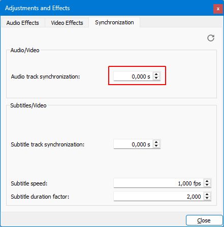

  9. > If you mux to mkv, the aac bitrate tag is missing, because the ffmpeg mkv muxer omit it.
    What about the idea to replace the language in the red oval when the bitrate tag has a value > 0, as the language is already showen in the green circle?
    [Attachment 85220 - Click to enlarge]

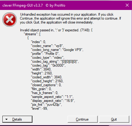

  15. @ ProWo
    3.3.7.06 Feedback 5
    Error during multiplexing.
    Error In stream detected. Should the task be aborted?
    a. When I click Yes I get the details below, with Next the app is not reacting because Abort does not work:

    b. When I click No at the error message I get this and the app is still usable.
    frame=25349 fps=0.0 q=-1.0 size= 311296KiB time=00:17:36.62 bitrate=2413.5kbits/s speed=2.1e+03x frame=52703 fps=51482 q=-1.0 size= 524288KiB time=00:36:37.74 bitrate=1954.3kbits/s speed=2.15e+03x frame=74115 fps=48363 q=-1.0 size= 758528KiB time=00:51:30.98 bitrate=2010.3kbits/s speed=2.02e+03x frame=92855 fps=45135 q=-1.0 size= 1011200KiB time=01:04:32.47 bitrate=2139.1kbits/s speed=1.88e+03x frame=111211 fps=43372 q=-1.0 size= 1214976KiB time=01:17:18.02 bitrate=2146.0kbits/s speed=1.81e+03x frame=131123 fps=42464 q=-1.0 size= 1362432KiB time=01:31:08.73 bitrate=2040.9kbits/s speed=1.77e+03x frame=149105 fps=41475 q=-1.0 size= 1511936KiB time=01:43:38.36 bitrate=1991.8kbits/s speed=1.73e+03x frame=163844 fps=39791 q=-1.0 size= 1711872KiB time=01:53:53.35 bitrate=2052.2kbits/s speed=1.66e+03x frame=178177 fps=38528 q=-1.0 size= 1898240KiB time=02:03:51.32 bitrate=2092.5kbits/s speed=1.61e+03x [aac_adtstoasc @ 0000024b27b32e00] Error parsing ADTS frame header![mp4 @ 0000024b27b70e80] Error applying bitstream filters to an output packet for stream #1: Invalid data found when processing input
    [aost#0:1/copy @ 0000024b296b0680] Error submitting a packet to the muxer: Invalid data found when processing input
    Last message repeated 1 times
    [out#0/mp4 @ 0000024b2912d100] Error muxing a packet

    Is there a way to determine exactly how much audio delay there is in a video? Thanks.
  24. Originally Posted by jopavirando View Post
    Open you video with VLC player, in the menu bar click on tools, track synchronozation, try various values (negative and positive) until the audio is in synch. The value found is your audio delay.
    [Attachment 85336 - Click to enlarge]
  25. @ ProWo
    3.3.7.07 Feedback 2
    I can confirm that the preview controls page up/down for 10 minutes or chapter jump is working well on two other devices.
    Tested on W10 and W11 with mp4 and mkv.
    Somehow on my working laptop the page up/down keys are working, but still not any longer with ffplay, so I can't do the 10 minutes or the chapter jump any longer.
    But when I attach an external keyboard, all works well.
    What about an option in converting a video into grayscale?
    -vf format=gray
    In the past I used VLC for that.
    Is it intentional that the red marked buttons do not have the same position as the two in green?
    [Attachment 85337 - Click to enlarge]
    [Attachment 85338 - Click to enlarge]
    Just because it looks nicer!
    What about the idea of adding the loosless flip (-display_hflip and -display_vflip) into Various -> Rotate?
  26. Originally Posted by Findu View Post
    As long as there are these differences in the treatment of pgup and pgdn by windows, I will leave it as it is now.
    -vf format=gray
    Can add it (btw: -vf format=gray isn't the best choice).
    No, I'll align them.
    -display_hflip and -display_vflip with streamcopy doesn't work as aspected.
  27. > As long as there are these differences in the treatment of pgup and pgdn by windows, I will leave it as it is now.
    Makes sense!
    Cool. Thanks.
    Thank you.
    Your right. -display_hflip does a vertical flip only for mp4 played on VLC!?

    I am unable to load an video file with VP9 codec into clever FFmpeg. The video is downloaded from youtube.
    Exception detail as below
    Anyone know how to resolve this issue?
    Thank you.
    [Attachment 85386 - Click to enlarge]
