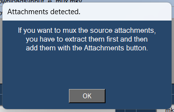

    Files with attachments:
    Attached fonts get overwritten when extracting them. But this might be okay.
    The following message appears twice in the Multiplex grid:

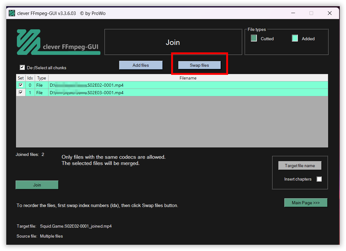

    If you open join without cutted parts, the button swap files and Clear cuts are visible but disappear after click De-/Selecht chunks. Swap files appear after the second added file. But that's not important.

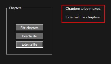

    Add chapters:
    I can create and load external chapters. But then, I would expect a button to transfer them to the multiplex grid or to mux them directly into the metadata.
    Or how is the procedure?
    Existing Chapters.txt will be overwritten.
    Will be fixed
    Will be fixed too.
    Add chapters:
    You can create or import chapter file. G.e after importing you will see this in the chapters grid:
    [Attachment 84572 - Click to enlarge]
    Then click main page, then multiplex. On the upper right you will see this:
    [Attachment 84573 - Click to enlarge]
    Click multiplex and the chapters are muxed.
    This is intended

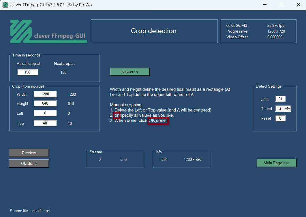

    NEW: Crop detection:
    Capital letter and space are missing:
    [Attachment 84586 - Click to enlarge]

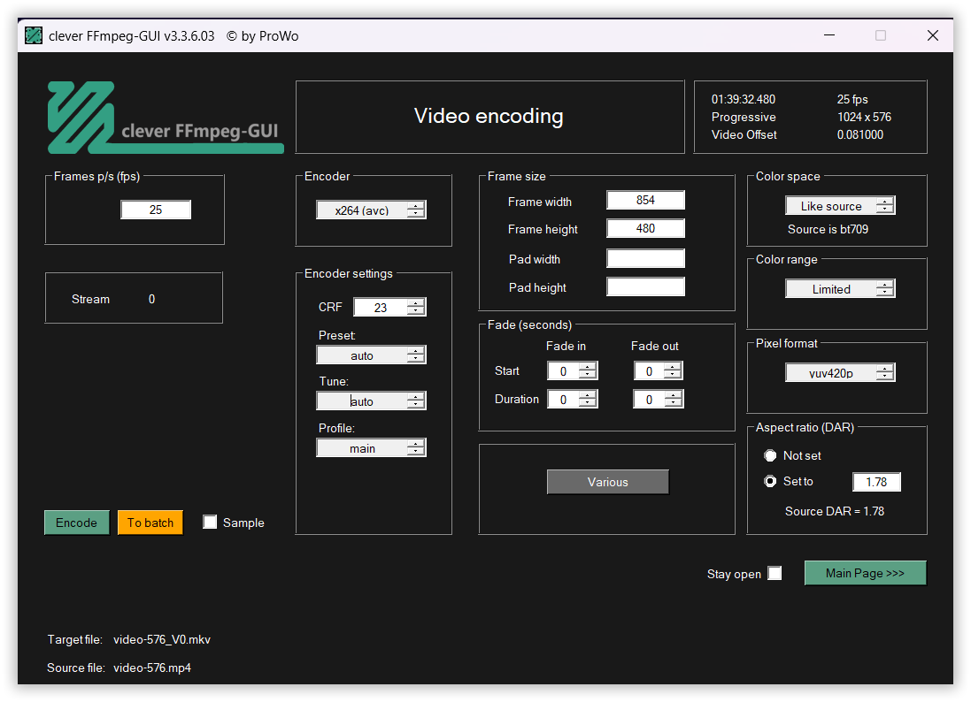

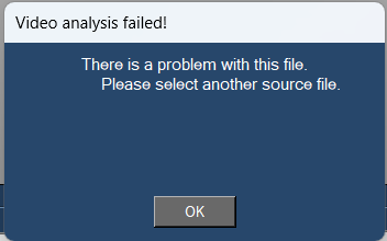

    another question:
    how change bitrate on conversion? i can't see option for that
    [Attachment 84605 - Click to enlarge]
  15. Originally Posted by lomero View Post
    another good idea could be a window that shows the output code used by ffmpeg in the editing conversion or an output log.
    If you want to see (and change) the command line, click on to batch instead of encode. Then exit the program.
    In the target folder you will then find a file BT_open.txt.
    Open it with a text editor; here you can see what you are looking for.
    If you know what you are doing, you can make changes and save them.
    The next time you start the program, this file will be read and you will be taken directly to the batch grid.

    >> Crop amount must be a multiple of 2
    Can you please apply your fix also for left/right.
    Only even numbers are allowed here as well. Otherwise, error messages will appear!
    Will be done.
    Will fix this.

    Strange bug with mkv containing fonts:
    Mux a font into a simple video.
    Load it as the new source.
    Now extract all streams and open Multiplex. The extracted audio and video streams apper twice in the multiplex table.

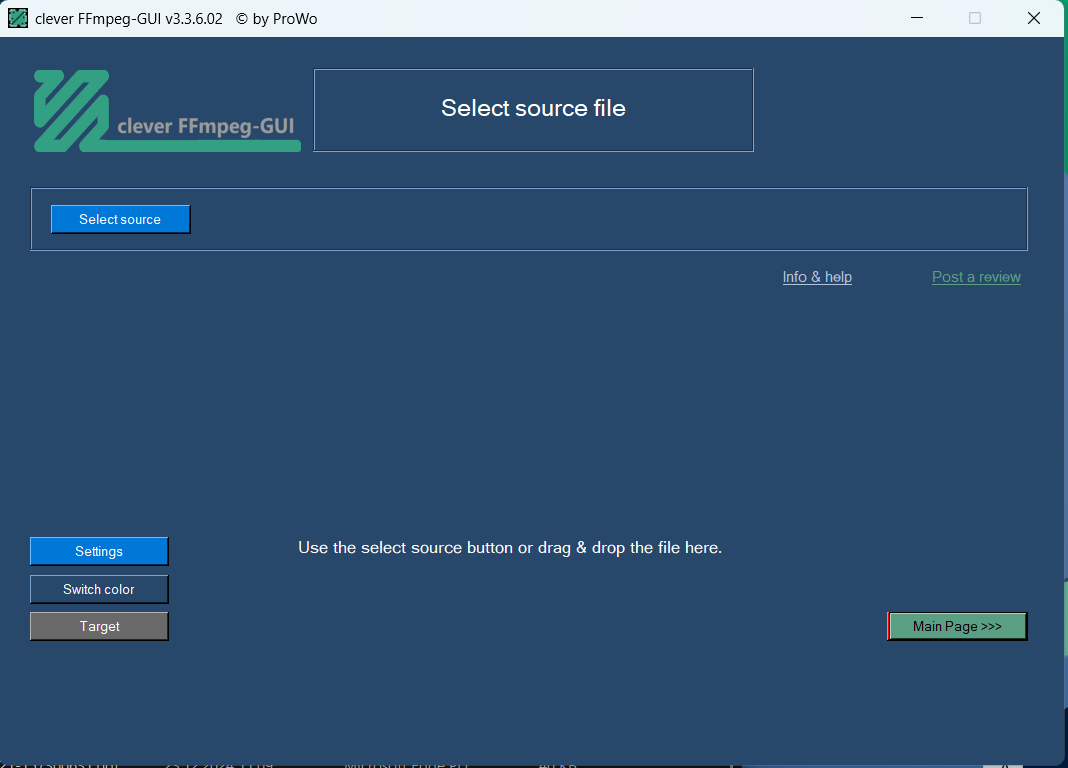

    When you drop files on the desktop icon, a new instance opens, but the “Select source file” page does not load/display the file(s).
    Is this intentional?
    Using multiple instances of the application can lead to problems, as BT_open.txt or SWF_open.txt, for example, are overwritten.
    Wouldn't it make sense to add new content to existing files?

    Chapters:
    Is there a reason why chapters are not listed on the Source file info page - like attachments?
    Could you please preselect the chapters at the Extract streams page like all others?

  29. Please put the Source and Target FPS options back under audio encoding, at least under custom. This is a feature I use all the time to finagle my simpler audio files. Helps me to not use Audacity to to fix the simpler issues and syncs.
    [Attachment 84649 - Click to enlarge]
    The Presets are ok but it is restricting the freedom, it is now much more difficult to do custom manipulation by only allowing the Factor. It was so easy and convenient being able to alter the Source or Target FPS to achieve the new duration time I desired. I don't want use a calculator to work out the needed factor please.
    I had to roll back from v3.3.6.04 to 3.3.5
  30. issue on swap files. on click nothing appears
    [Attachment 84666 - Click to enlarge]
