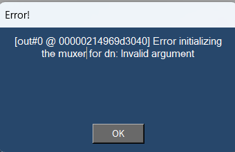

    [AVFormatContext @ 000001c415de3140] Unable to choose an output format for 'dn'; use a standard extension for the filename or specify the format manually.[out#0 @ 000001c415de3040] Error initializing the muxer for dn: Invalid argumentError opening output file dn.
    Error opening output files: Invalid Argument

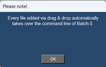

    Coincidental I run into this:
    [Attachment 84375 - Click to enlarge]
    This is already working for video and audio encoding. And should work for simpel remux.
    But to make users aware of this usefull function, you should use a txt line like this on the grid:
    Drag & drop files to replicate Batch 0.
    Will be done.

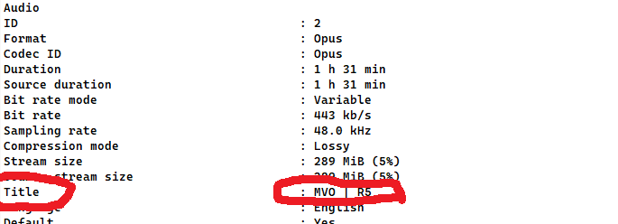

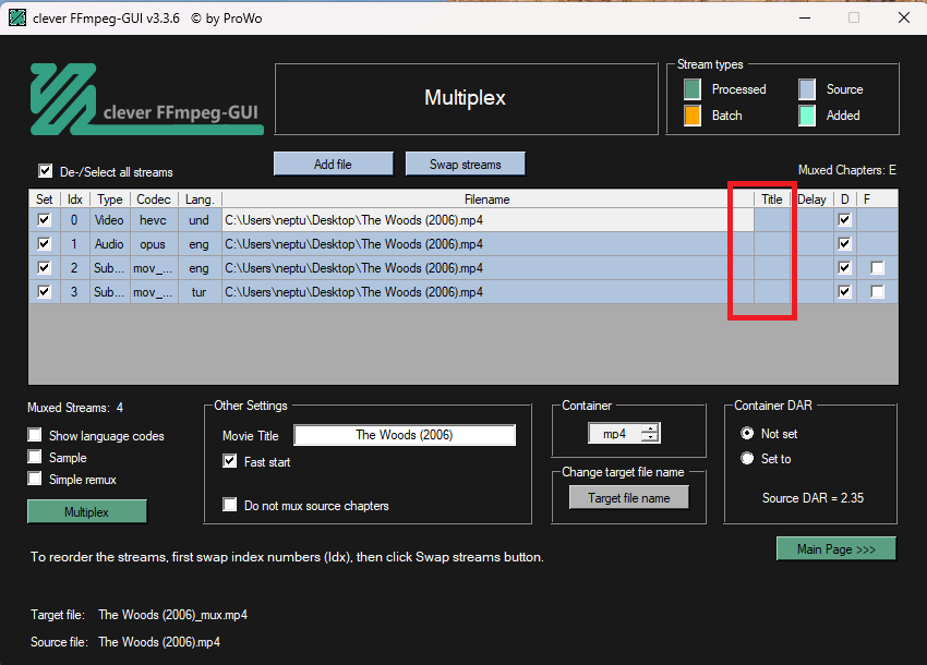

    Hello, I have a few ideas to find out what you think.
    1. Can the application name and window be simplified? Remove the part that says GUI. The application name can be just “clever FFMpeg” (I think it would be more universal.) (when you click on info, a window opens and shows the application version and developer as in the image)
    2. Fast Start can remain on by default when muxing mp4 files (even the box can be removed and every file is written as fast start by default)
    3. There may be a bug: When muxing mp4 file, the Title part looks empty, but the title of the track of the source file is written to the destination file.
    There are two places where you can enter the video title in multiplex. Once at stream level, in the title column, and once at container level under other settings, Movie Title.

    > Simple remux -> To Batch, not working.
    Your code contains just a simple error as the syntax is -dn instead of dn, that's all.
    Drag and drop for Batch Tasks is working afterwards.

  9. Originally Posted by Findu View Post
    It's already fixed in my actual beta.

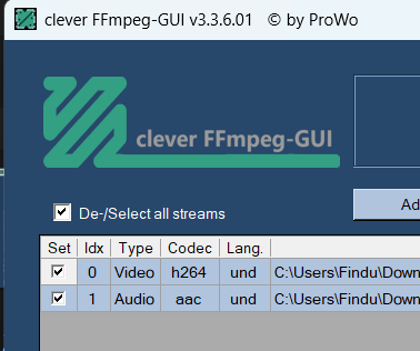

  12. Thank you for Fast Start default on option.

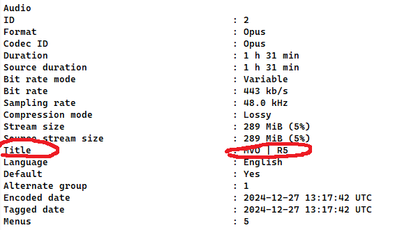

    Other subject: I'm not talking about the movie title, it's smooth. Video and audio tracks appear blank on the Multiplex screen. But it is copied from the source file to the target.
  13. Originally Posted by neptune84 View Post
    Could be a subtitle stream.

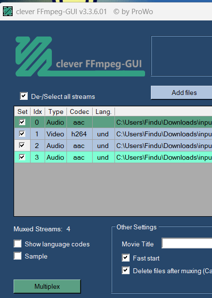

  15. @ ProWo
    Beta (v3.3.6.01) Feedback
    > Change to "Add files" button.
    Working
    > Bug in cutted parts overwriting.
    Solved
    > Keep all cuts since app start in the join list and preselect the last cuts.
    Not implemented.
    Joint cuts get deleted after joining. So cutted parts could only joined once. Might be okay!
    > Join grid
    It would be consistent to hide the "Clear cuts" button if the list is empty like for "Swap files" and "Join" when nothing is selected.
    The colum Type has a sort funktion, which could be usefull. But if the join list is empty and you add multible cuts from the Cut grid, the first entry starts with a blank instead of "Steam cut…".
    Solved
    > Add text: Drag & drop files to replicate Batch 0.
    The & is not visible.
    > Change text: Multiplex/Join
    Done
    > Leaveing Join without joining, only Multiplex is availabel.
    Solved
    For better understanding, I would rather use text instead of a gear symbol on the settings button.
    These various "Batch Tasks" also get processed without error:
    Change video DAR
    Change Profile Level
    Rotate Video
    Crop video (MD only)
    Fix framerate
    Good!

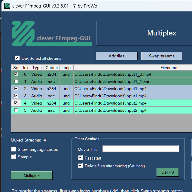

    Isn't it better to stay in the Multiplex grid instead of leaving it when using "Del PS"?
    What about moveing the buttom to the top right next to "Swap streams" as it is list related?
    Multiplex grid text Change (cause of funktionality):
    Delete files after muxing (Caution!)
    If checked, all selected files excepte the source file are deleted after muxing.
    New:
    Delete processed streams after muxing (Caution!)
    If enabled, only the selected processed streams from the grid and their corresponding files will be deleted after muxing.

    Multiplex grid clean up
    Ill tested again and I was wrong before!
    They don't do the same.
    Basis
    [Attachment 84472 - Click to enlarge]
    After Multiplex
    [Attachment 84473 - Click to enlarge]
    After "Del BS" button and going back to the Multiplex grid
    [Attachment 84474 - Click to enlarge]
    Okay

  24. Track titles appear blank on the Multiplex screen. But it is copied from the source file to the target.Image
    [Attachment 84500 - Click to enlarge]
    [Attachment 84502 - Click to enlarge]
    [Attachment 84503 - Click to enlarge]
  25. Originally Posted by neptune84 View Post
    This is because the title has non ASCII conform characters, like |, and the grid font isn't able to display it.
    Will see what can be done.
    EDIT:
    I'll change the grid default font to Segoe_UI (unicode aware), so the tags are shown.
    But the problem is, that FFmpeg isn't able to write unicode metadata, and this has to be fixed by the FFmpeg guys.
    EDIT2:
    Researched again. FFmpeg has nothing to do with the problem, it is due to Windows and the codepage used, which is not utf_8 compatible.

    [vost#0:0/copy @ 0000022524176d00] Error initializing bitstream filter: h264_metadata
    [h264_metadata @ 000001f55be50d40] Invalid value for crop_top: must be a multiple of 2.[vost#0:0/copy @ 000001f55c296d00] Error initializing bitstream filter: h264_metadataError opening output file C:\Users\Findu\Downloads\input2_cropped_#2.mp4.
    Error opening output files: Invalid argument

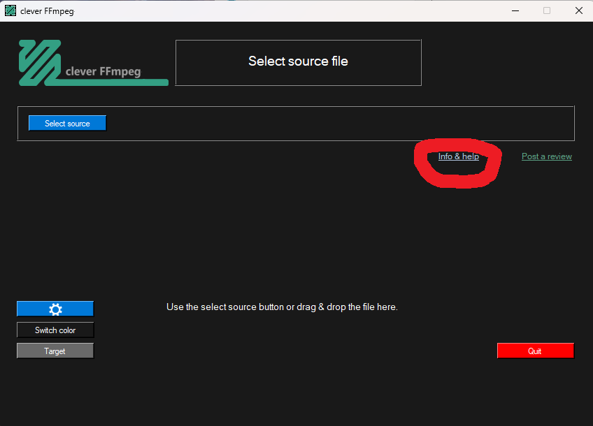

  30. @ ProWo
    In settings, you can check the GUI ver, status, and update if necessary.
    can you do that to FFmpeg as well?? That would be really great ..
