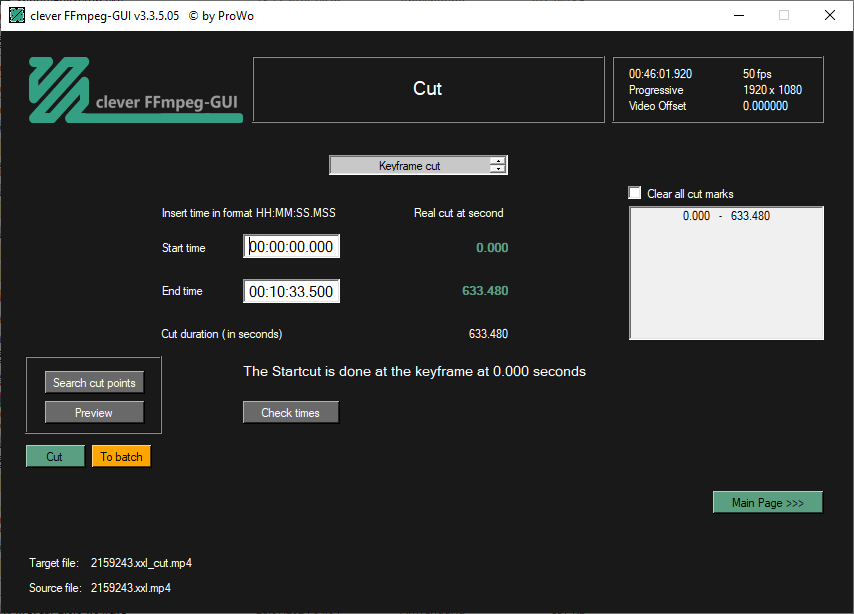

    [Attachment 84277 - Click to enlarge]
    whats wrong with the other files?

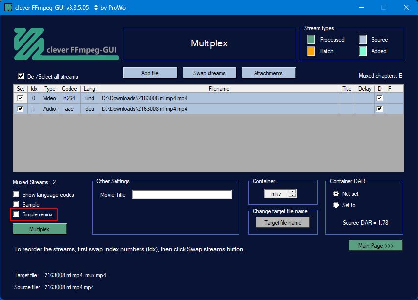

    Maybe download not completed. A simple remux before cut could help.

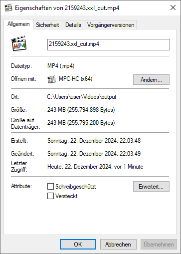

    [Attachment 84278 - Click to enlarge]
    Jun 2023
    Germany

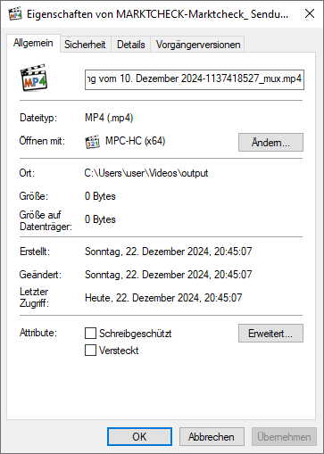

    even simple remux produce a 0byte file
    [Attachment 84279 - Click to enlarge]
    Jun 2023
    Germany
    i downloaded the big file again but with a differend browser (vivaldi). cutting gives a 0 byte file. simple muxing also produce a 0 byte file.
    edit:
    i can extract the streams and multiplex it. file is good. but i get even a 0 byte file when i cut this file.
  10. Originally Posted by Lexi View Post
    edit:
    Found the issue. There is a hidden data stream in the video. Will fix the problem in the next release.
    In the meantime you can remux the video (normal multiplex, not simple remux) and cut the remuxed one.
    Should work.
    Jun 2023
    Germany
    this sounds great! what kind of data are in the hidden stream?
    normal multiplex give a good file but cutting it lead again to the 0 bytes file.

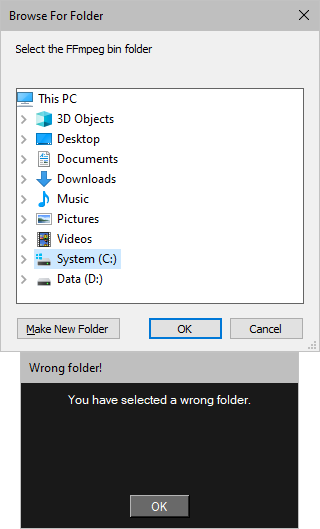

    Beta (v3.3.5.04) feedback.
    > Block for raw videostream adding in multiplex grid
    Working for .h264 streams. Thanks.
    > Change target folder and ffmpeg bin folder locations
    This is working as expected. Thanks.

  13. Originally Posted by Lexi View Post
    Read your PM.
    Test this version.
    Jun 2023
    Germany
    Originally Posted by Findu View Post
    @ Lexi
    Checking https://pdodswr-a.akamaihd.net/swrfernsehen/marktcheck/sendungsmitschnitt/2159243.ml.mp4
    I have the same problem and similar ones in the past.
    Workaround:
    Broadcast Systems often use Transport Streams .ts even for downloading.
    Simply change the file extension from .mp4 back to .ts and the app will handle your tasks.
    Also most TVs will play files when you simply change file extension from original .ts to .mp4
    WOW, changing file extension realy works
    thanks for that hint!

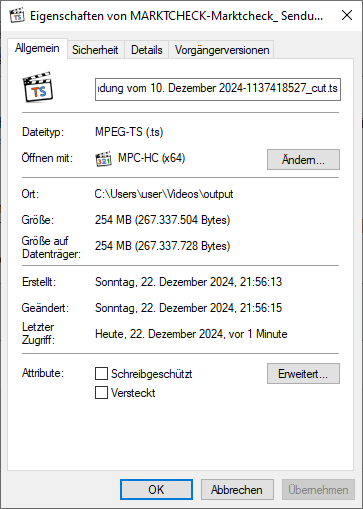

    [Attachment 84280 - Click to enlarge]
    Jun 2023
    Germany
    Read your PM.
    Test this version.
    tested! works fine

    can anybody explaine the differend file size (11mb) between the renamed and cutted ts and the cutted mp4? both files where cutted at 10:33:480
  17. I gues the smaller .mp4 cut does not contain the hidden data stream any longer.

  28. Hello, I have a few ideas to find out what you think.
    1. Can the application name and window be simplified? Remove the part that says GUI. The application name can be just “clever FFMpeg” (I think it would be more universal.) (when you click on info, a window opens and shows the application version and developer as in the image)
    2. Fast Start can remain on by default when muxing mp4 files (even the box can be removed and every file is written as fast start by default)
    3. There may be a bug: When muxing mp4 file, the Title part looks empty, but the title of the track of the source file is written to the destination file.
    [Attachment 84367 - Click to enlarge]

    I just gave it a try: It doesn't like that I simply put the three EXEs at the root of C (not in c:\bin, just c:\)
