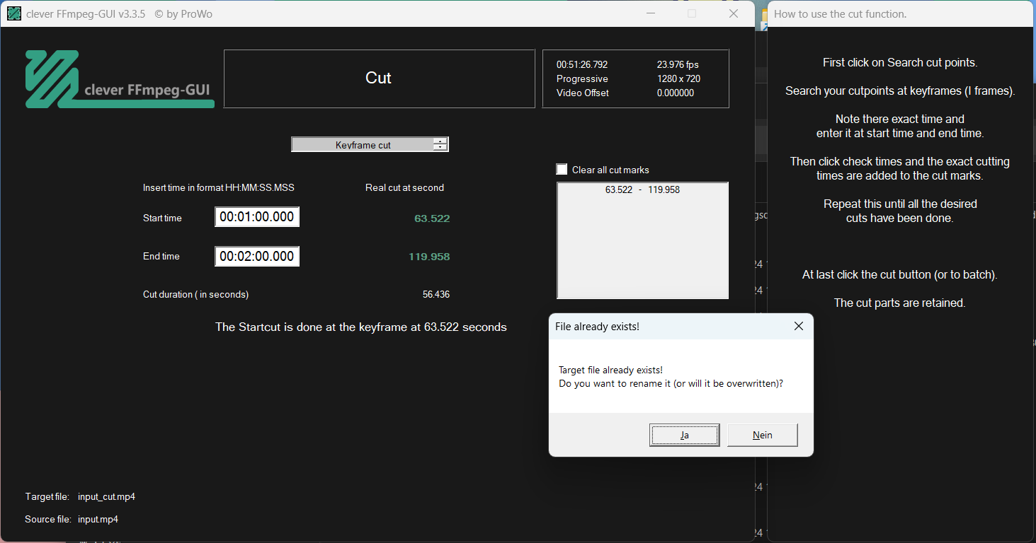

    Originally Posted by Findu View Post
    The "File already exists!" window is still a messagebox.
    I noticed that and will fix it.

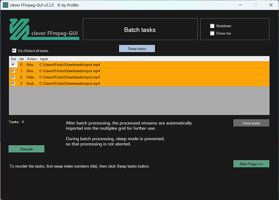

  6. @ ProWo
    Batch task:
    If you enlarge the "Action" column and add one for "Output", the "Batch Task" list would give a better overview.
    [Attachment 84194 - Click to enlarge]
  7. Originally Posted by Findu View Post
    Batch task:
    I will widen the action column, but there is not enough space for an output column. Besides, that wouldn't be any additional useful information.

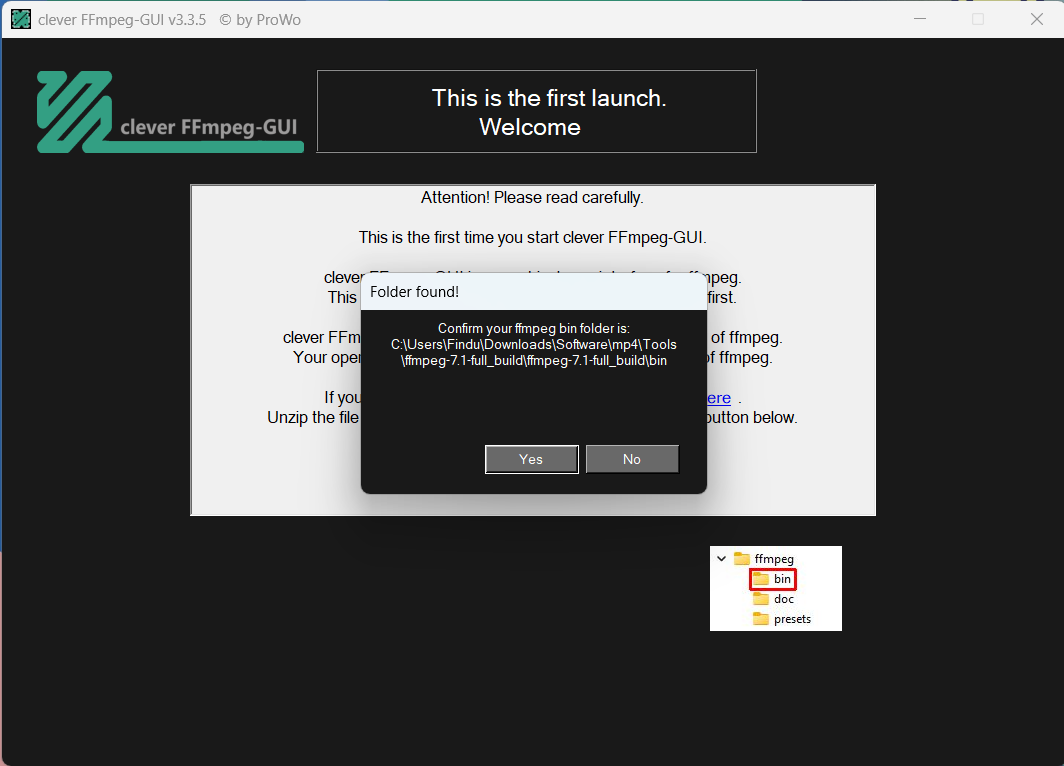

  27. @ ProWo
    > I will add a check that prevents the addition of raw streams.
    Cool, thanks.
    Suggestion: ffmpeg folder buttom
    A "Set ffmpeg folder" buttom on the "select source file" grid would also be helpfull.
    To easily change between ffmpeg versions, for example when new versions get published.
    I always keep the folders after unpacking the ffmpeg zip versions, like
    ffmpeg-7.1-full_build (for my Ryzen 5 7530U)
    ffmpeg-7.0.2-full_build
    ffmpeg-5.1.2-full_build (for my old GTX 660 Ti, using HW acceleration)
    With the buttom, there is no need to edit or delete portable.config any longer what I usualy do.

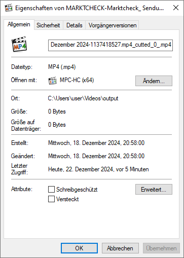

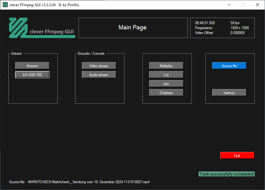

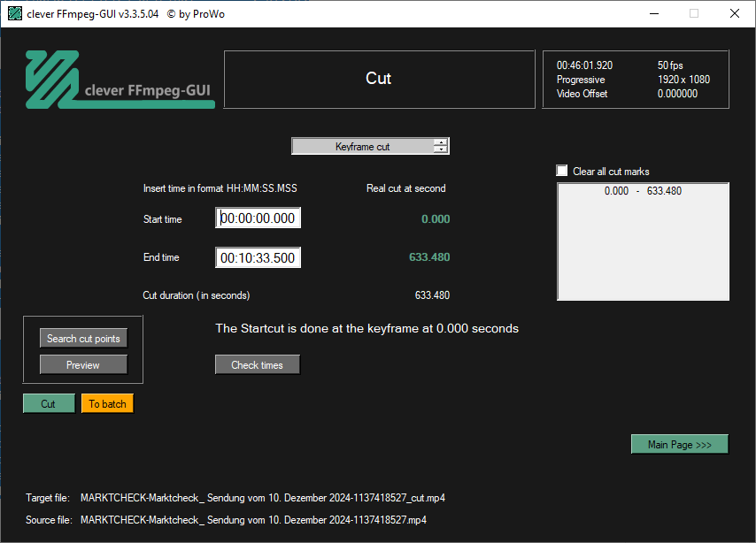

  30. Member
    Jun 2023
    Germany
    [Attachment 84272 - Click to enlarge]
    Hello ProWo,
    i have a problem while cutting. I try to cut a mp4 file which i have downloaded from a mediathek. I insert cutting time an d perform a check. all fine. I press cut and cleverffmpeg says after ~1 secound task succesfully completed but the file has zero bytes. i tryd different versions of clever and different versions of ffmpeg.
    You can download the file for testing here:
    https://pdodswr-a.akamaihd.net/swrfernsehen/marktcheck/sendungsmitschnitt/2159243.xxl.mp4
    i will add some screenshots and mediainfo.
