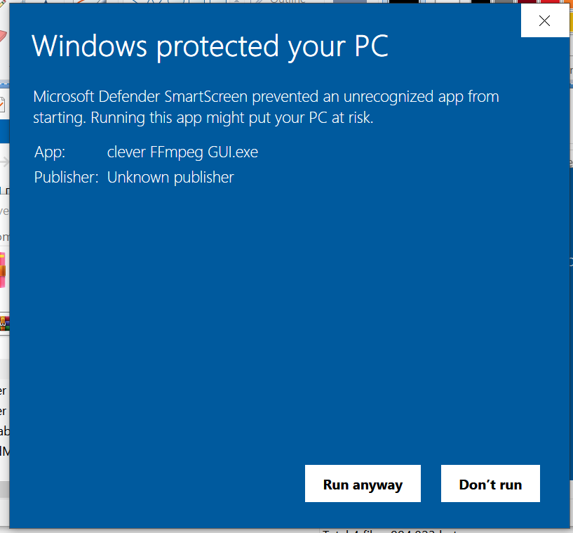

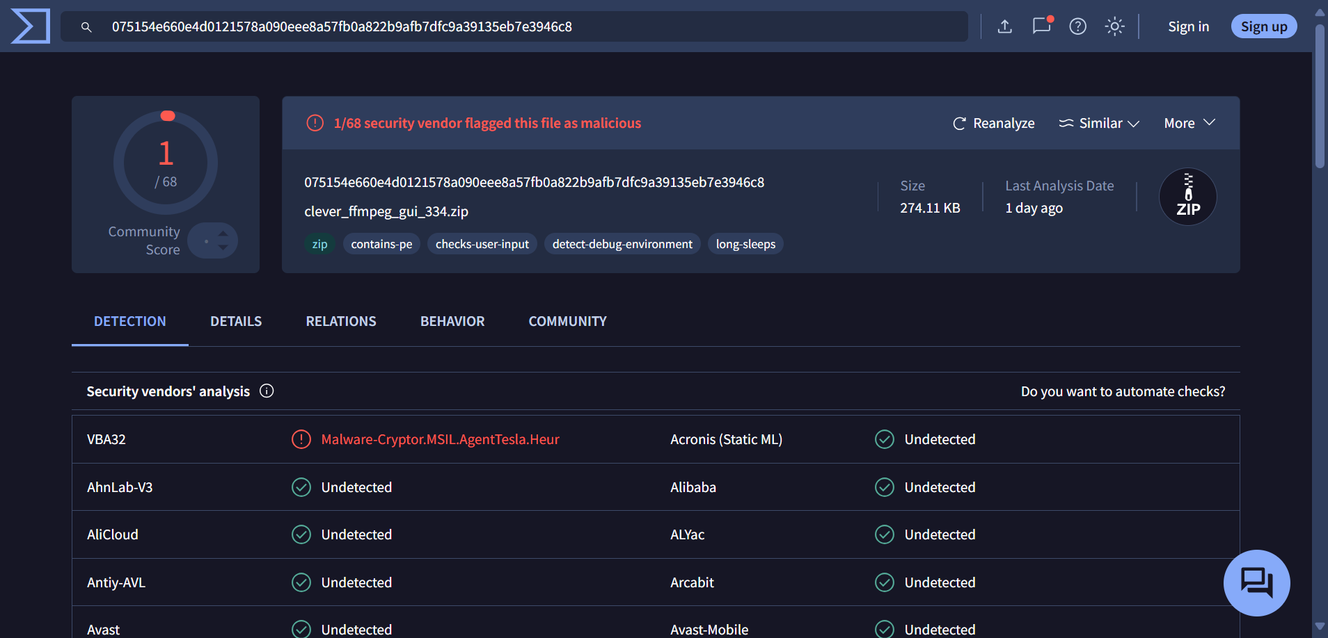

  11. Clever FFmpeg GUI 3.3.4, Errors
    Pls, Fix This Error.
    Thank you so much!
    1. Problem when run clever "FFmpeg GUI.exe"
    [Attachment 84101 - Click to enlarge]
    2. Virus Check
    [Attachment 84102 - Click to enlarge]
  12. Originally Posted by onlinedragon View Post
    Thank you so much!
    1. Problem when run clever Ffmpeg-GUI
    There is nothing to fix.
    The first message is from Windows smartcreen.
    It's only displayed, if you first start a downloaded executable.
    Click run anyway.
    The virus alert is false alarm.
    If you downloaded from videohelp, the archiv is safe.
    You can also check the MD5.
