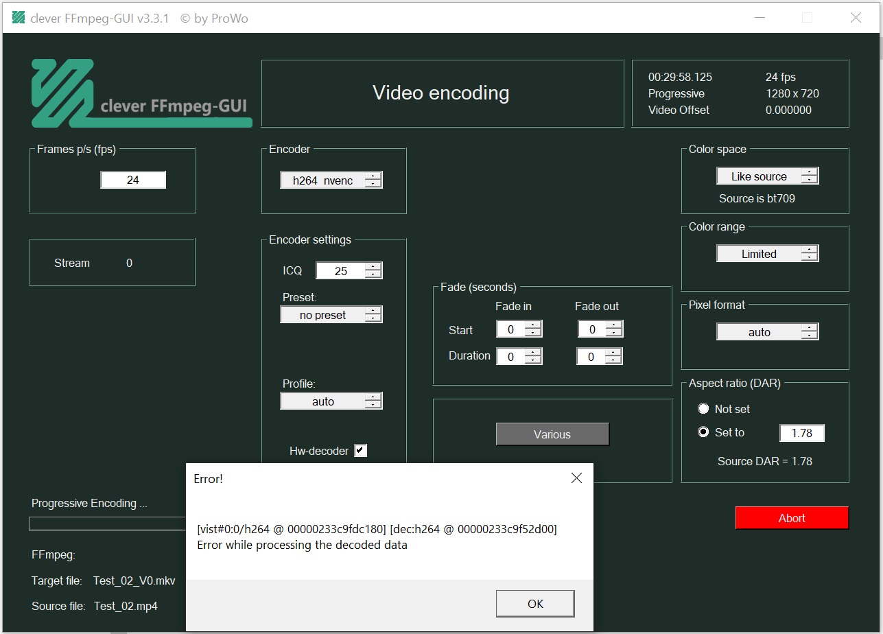

And my first outcom testing HW Encoding on Nvidia @ W10
[Attachment 83411 - Click to enlarge]
Video ---> h264_nvenc - Stream ID 0 from?M:\Test_02.mp4?1798125?-hide_banner -loglevel error -stats -vsync 0 -hwaccel:0 auto -hwaccel_output_format cuda -y -fflags +genpts -i "M:\Test_02.mp4" -vf fps=24000/1000 -map 0:0 -c:v h264_nvenc -cq 25 -color_range tv -an -sn -dn -metadata:g encoding_tool="clever FFmpeg-GUI" ?M:\Test_02_V0.mkv?1
[Attachment 83412 - Click to enlarge]
Video ---> h264_nvenc - Stream ID 0 from?M:\Test_02.mp4?1798125?-hide_banner -loglevel error -stats -y -fflags +genpts -i "M:\Test_02.mp4" -vf fps=24000/1000 -map 0:0 -c:v h264_nvenc -cq 25 -color_range tv -an -sn -dn -metadata:g encoding_tool="clever FFmpeg-GUI" ?M:\Test_02_V0.mkv?1 -

For your test on nVidia @W10:
This is strange, the second commandline should work.
Check if your nVidia hardware is compatible.
https://developer.nvidia.com/video-encode-and-decode-gpu-support-matrix-newLast edited by ProWo; 9th Nov 2024 at 08:38. Reason: Typo
@ ProWo
Good that AMD hardware encoding is working!
nVidea hardware encoding:
My old GTX 660 Ti is not on the mentioned capability list.
ffmpeg 7.1
libx264 does encoding with speed 3,0x
h264_nvenc is reporting
[h264_nvenc @ 0000014049a52080] Driver does not support the required nvenc API version. Required: 12.2 Found: 11.1
[h264_nvenc @ 0000014049a52080] The minimum required Nvidia driver for nvenc is 551.76 or newer
h264_nvenc using
ffmpeg 4.3.2 does HW encoding with speed 7,4x
ffmpeg 5.1.2 does HW encoding with speed 6,0x
So I can confirm that nVidia HW encoding is working with HW_decoder unchecked using older ffmpeg versions @ GTX 660 Ti. -

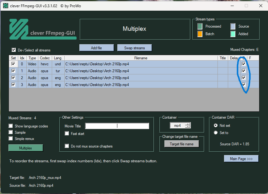

I meant that by default they should all be unchecked, but that doesn't seem possible. Thank you anyway.Default flag handling in muxing grid (thx to neptune84 for the hint).
[Attachment 83425 - Click to enlarge] -

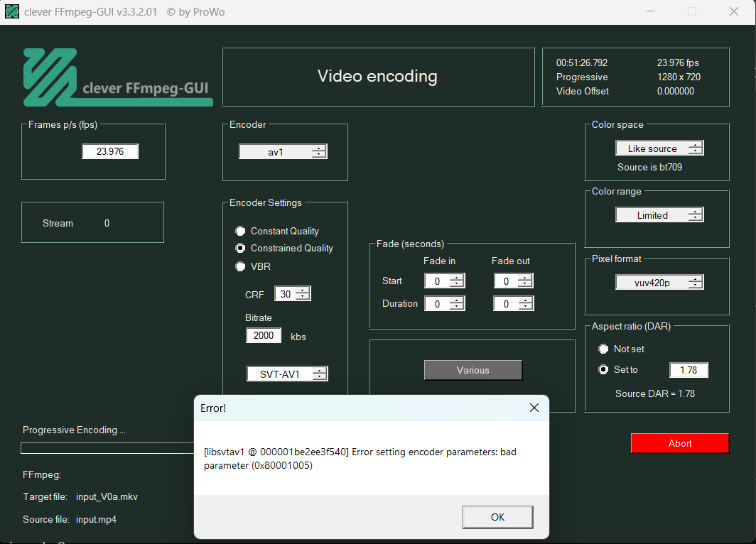

Suggestion: AMD and Intel HW acceleration encoder (h264_amf, h264_qsv, hevc_amf, hevc_qsv) does not support the encoder setting for Tune.
Would it make sense to remove the option if you find time?
I get a bad parameter error with av1 (STV-AV1) with constraind quality encoding:
[Attachment 83598 - Click to enlarge]
Video ---> av1 - Stream ID 0 from?C:\Users\Findu\Downloads\input.mp4?3086792?-hide_banner -loglevel error -stats -y -fflags +genpts -i "C:\Users\Findu\Downloads\input.mp4" -vf fps=24000/1001,colorspace=all=bt709:iall=bt709:range=tv,form at=yuv420p -map 0:0 -c:v libsvtav1 -crf 30 -b:v 2000k -an -sn -dn -metadata:g encoding_tool="clever FFmpeg-GUI" ?C:\Users\Findu\Downloads\input_V0.mkv
You provide three identical encoder settings for AV1, SVT-AV1, rav1e:
constant quality: -crf 30 -b:v 0
constraind quality: -crf 30 -b:v 2000k (only error at SVT-AV1)
VBR: -b:v 2000k
To my understandig as a beginner, would it make sense to use:
constant quality: -crf 30 (BRC mode / rate factor : CRF / 30)
constraind quality: -b:v 2000k (BRC mode / target bitrate (kbps) : VBR / 2000)
VBR: -qp 30 (BRC mode / CQP Assignment : CQP / 30)
Sorry! None of my hardware supports av1 HW-acceleration, so I am not able to test it if you plan to integrate it too! -
