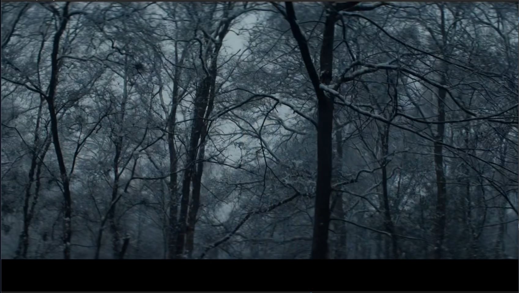

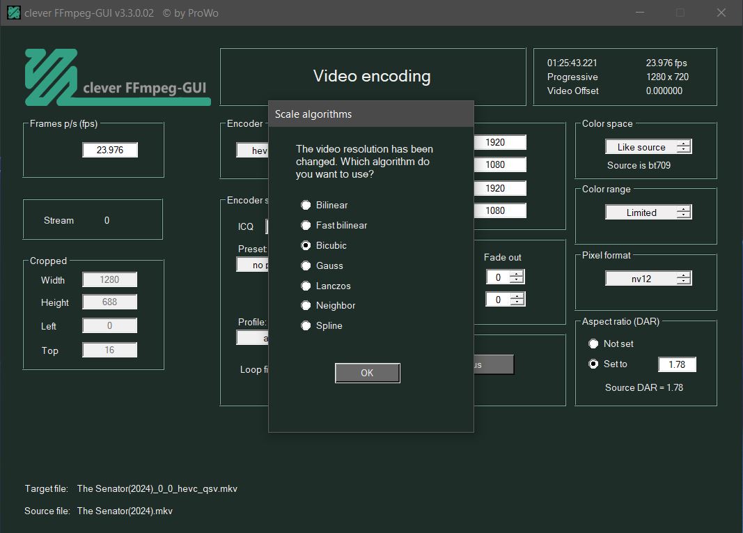

    Also when you use cropping on any codec encoder :
    [Attachment 82715 - Click to enlarge]
    you do not have the page when you choose scale algorithm when you press encode :
    [Attachment 82716 - Click to enlarge]
    and the movie is encoded with the black border
    [Attachment 82717 - Click to enlarge]
    Hope there is just a glitch and will be corrected if it is possible !!
    Thanks for this great tool !!!
  2. Originally Posted by Marcellos View Post
    After version clever_f3.2.8.03 when you try svt-av1 encode you have this error
    [Attachment 82713 - Click to enlarge]
    Your settings make no sense.
    You first cropped with the result 1280x688, which gives a DAR of 1.85.
    If you resize to frame width 1920 then the frame height must be 1036 with the same DAR, and not 1080 as in your picture.
    Padding with the same values as frame with and frame height makes no sense and is pointless.
    As for the error:
    I confirm it. The FFmpeg code has been changed.
    (av1 only supported in MP4 and AVIF, and not in mov, as before).
    I will change this in the next beta.
    In the meantime there is the following workaround:
    Make your settings and then click on To batch, instead of encode.
    Then quit clever FFmpeg-GUI.
    You will now find a new text file BT_open.txt in your destination folder.
    Open it in your text editor and change .mov to .mp4
    Save the file, close the text editor and restart clever FFmpeg-GUI.
    This will now start directly into the batch grid.
    Click execute, and your AV1 video will now be encoded correctly.
    Feb 2021
    Romania
    What is the point of cropping if i want the same resolution to be 1920:1080 like i did before and not 1920:1036 as you say ?
    Just like i do it with ffmpeg script for example : -vf "yadif=0:0:0,crop=1280:692:0:14,scale=1920:1080:fl ags=lanczos,setsar=1:1" -r 24 -aspect 1.7777
    Thanks again !!!
  4. Originally Posted by Marcellos View Post
    Thanks again !!!
    Every movie has its original aspect ratio, i.e. the ratio of frame width to frame height.
    You should not change this aspect ratio, as this will change the visual result.
    So if you resize from 1280x692 (1.85) to 1920x1036 (1.85) then the visual result is the same.
    If you resize from 1280x692 (1.85) to 1920x1080 (1.78) then the visual result is changed.
    If you absolutely want to change the output format to 1920x1080, then you must resize to 1920x1036 and pad to 1920x1080.
    In this case black bars above and bottom are added.
    You could also resize the whole 1280x720 to 1920x1080, without any cropping.

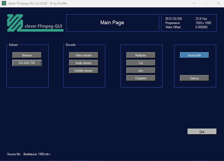

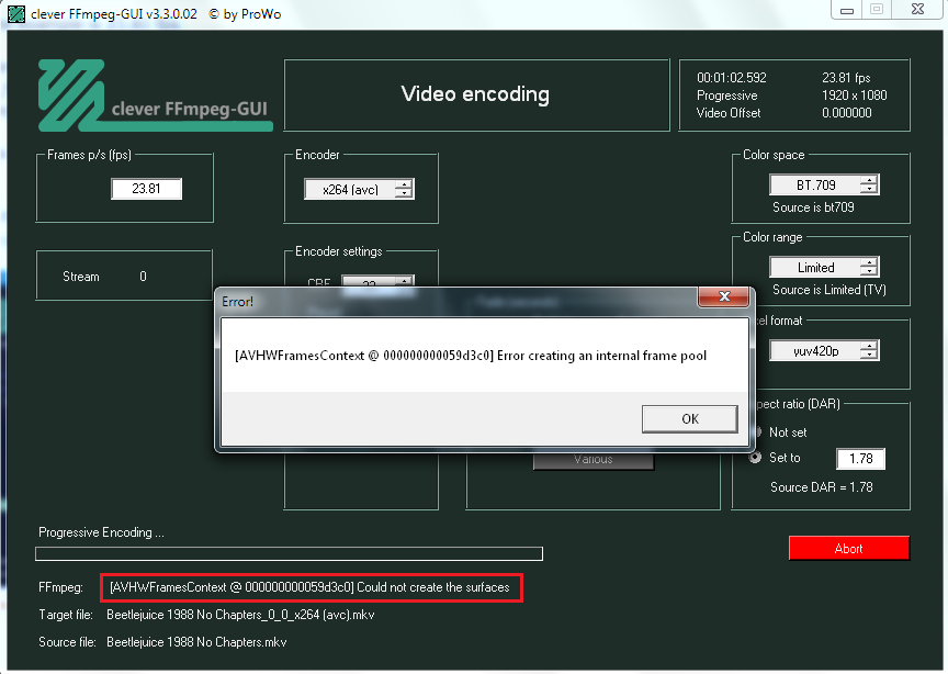

    I've tried another film with a HEVC stream & I received the same error, perhaps it's HEVC related as there are no such issues with AVC streams?
    [Attachment 82798 - Click to enlarge]

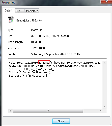

    Also for some strange reason the frame rate is reported as 23.81 fps in the top right hand corner not the proper 23.976 fps, the MediaInfo reports 23.976 (24000/1001) but for some strange reason when I actually play the file with MPC-HC & click on File then Properties the dialog box reports the frame rate as 23.81fps.
    [Attachment 82799 - Click to enlarge]

  9. Originally Posted by oniiz86 View Post
    This example is 23.81 fps.
    from ffprobe:
    "r_frame_rate": "500/21",
    "avg_frame_rate": "500/21",
    You can fix this with main, various, fix framerate, enter 23.976 and click fix.

    no problem here with encoding this hevc example to avc with x264 and clever FFmpeg-GUI v3.3.0.02
    [Attachment 82800 - Click to enlarge]

    Thanks for that, I tried it again with the short sample I gave you but no such luck, it's strange that the Official v3.3.0 & Beta v3.3.0.01 have no such issues, did you happen to change the code between Beta v3.3.0.01 & v3.3.0.02? I wonder what "Error creating an internal frame pool" & "could not create the surfaces" means?
    [Attachment 82801 - Click to enlarge]

  11. What's your ffmpeg version?
    Try to update to the latest beta
    https://www.gyan.dev/ffmpeg/builds/ffmpeg-git-full.7z
    edit:
    Try the following:
    Make your settings in the video encode section.
    Then click on to batch instead of encode.
    Quit the program.
    In the destination folder you will find a new text file called BT_open.txt.
    Open it with your text editor and search for -hwaccel auto.
    Select and delete it. Save the file.
    Then restart clever FFmpeg-GUI, you will be automatically redirected to the batch tasks grid. Click on execute.
    Is the batch task now executed without errors?

  12. @ProWo Unfortunately I'm still on Windows 7, I believe I can only use FFmpeg 7.0.1 Essentials Build, will a previous FFmpeg 6.6.1 build still work reliably with your latest version of Clever FFmpeg-GUI?
  13. Originally Posted by ProWo View Post
    edit:
    Try the following:
    Quiet the program.
    I don't believe it but I removed "-hwaccel auto" from the text file & went to execute the task & it is now all fine , was there a change implemented in the latest Beta v3.3.0.02?
  14. Originally Posted by oniiz86 View Post
    Yes, this was added in the last beta and it works fine with Windows 10+11, but as you can see, not with Windows 7.
    I will remove it again in the next beta, as it does not bring any great advantage.

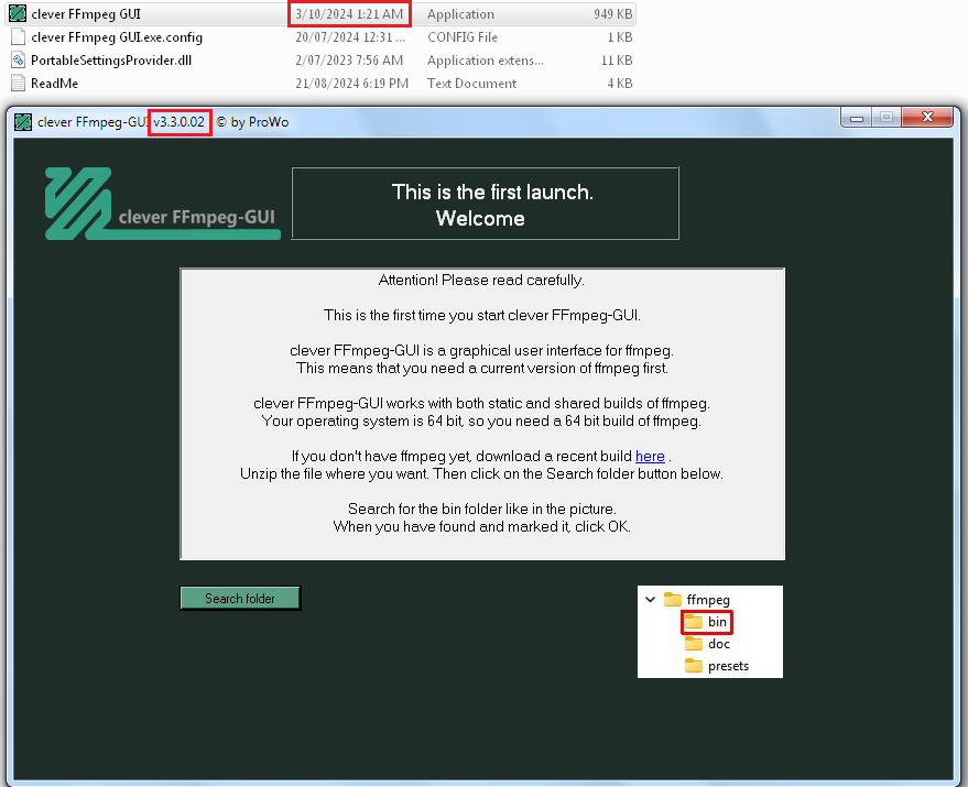

  16. @ProWo I downloaded the latest Beta v3.3.0.03 but the actual GUI version is 3.3.0.02 & the error is still present for me, this "Error creating an internal frame pool" pop up is still happening, has the Beta link been correctly updated?
    Not sure if you saw in my above post regarding 8 Bit & 10 Bit references to yuv420p & yuv420p10le, could this be added to the Pixel Format options like the following, yuv420p (8 bit) & yuv420p10le (10 bit) would that be possible?
  17. Originally Posted by oniiz86 View Post
    The correct download link is the one form page #1 of thís thread, and the beta is updated to v3.3.0.03
    The pixel formats yuv420p and yuv420p10le are already avaiable for the x264 encoder.
    The #10 stays for 10 bits. (yuv420p10le)
  18. Originally Posted by ProWo View Post
    The latest Beta v3.3.0.03 application is dated 3/10/2024 which suggests it hasn't been updated that was the previous Beta v3.3.0.02 application date, should it not be 13/10/2024, strange the GUI still indicates v3.3.0.02 as you can see below,
    [Attachment 82803 - Click to enlarge]
  19. Originally Posted by oniiz86 View Post
    This isn't version 3.3.0.03...
  20. @ProWo That's what I'm saying, the Beta v3.3.0.03 link on the first page of this thread, when I clicked on it, it's still the previous Beta v3.3.0.02, it's a strange one, I don't think it's a browser cache issue on my end.
  21. I checked the zip file for download again and it definitely contains version 3.3.0.03.
    You are doing something wrong.
    I think you are using the wrong zip file. Check your download folder.
    In which folder was the previous version 3.3.0.02?
    In this folder, overwrite only the file clever FFmpeg-GUI.exe with the new one from the zip archive you downloaded.
    Leave the other files as they are.
    Then double-click the new clever FFmpeg-GUI.exe.

    I normally allow it d/l to the desktop, I'm really silly, so sorry about this but it was a Chrome browser cache issue, I cleared the cache, then d/l the Beta again & it was the correct link this time around with Beta v3.3.0.03, never happened to me before when d/l your utility but there is always a first time, oh & that error is no longer present now, thanks so much again
    Edit: Since the utility has become portable, if there is an issue, is there a file to delete like there was previously under the Users/Master/AppData/Local path, is this the file "clever FFmpeg GUI.exe.config" to delete?

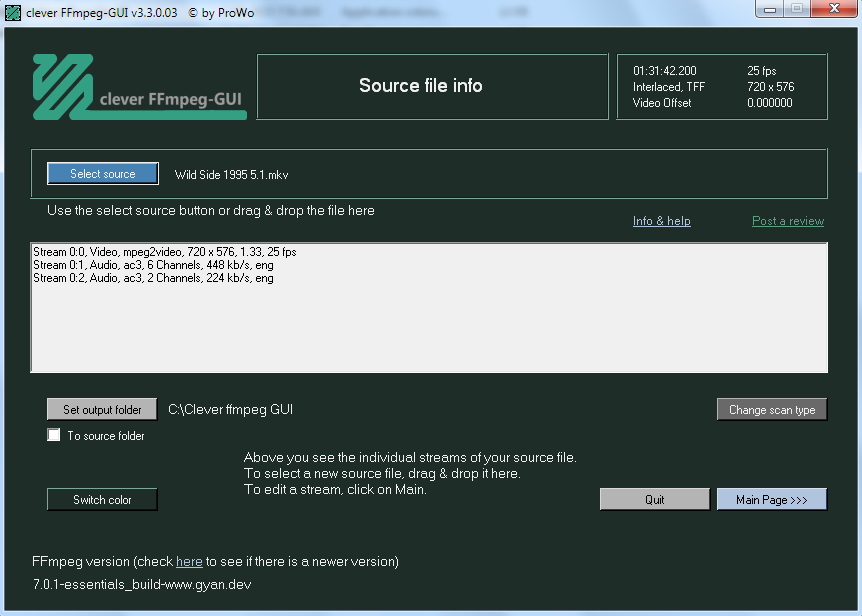

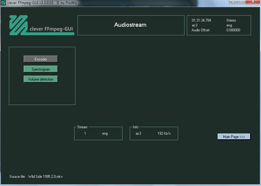

  23. @ProWo You had helped me with 2 25fps sources, one had a 5.1 track with a duration of 01:31:40.992 & it's video has a duration of 01:31:42.200, I wanted this 5.1 track to sync up with a different video that has a duration of 01:31:42.760 & its 2.0 track has a duration of 01:31:34.784, I made a mistake telling you that the 5.1 track had a duration of 01:31:34.784 when it was really 01:31:40.992, I used this calculation that you told me 01:31:34.784 = 5494.784 seconds
    01:31:40.992 = 5500.992 seconds & 5494.784 : 5500.992 = 0.99887148, the Factor 0.99887148 made the 5.1 audio track's new duration come to 01:31:47.207 so for some strange reason it's greater than the video track duration of 01:31:42.760, perhaps it's not possible to re-encode the 5.1 audio stream with the factor adjustment, must I have to add an "ms" delay, I've observed that the audio is slightly ahead of the video?
  24. Hi oniiz86,
    both videos are 25 fps?
    Your data above is strange.
    The target video has a duration of 01:31:42.760 and its stereo audio track has a length of 01:31:34.784?
    That's almost 6 seconds difference!
    Is there an audio delay of almost 6 seconds?
    Load this video into clever FFmpeg GUI and post a picture of the source file info screen, the video encoding screen and the audio encoding screen so I can check all the timings.
    We will deal with the 5.1 audio stream later.
  25. Originally Posted by ProWo View Post
    Hi oniiz86,

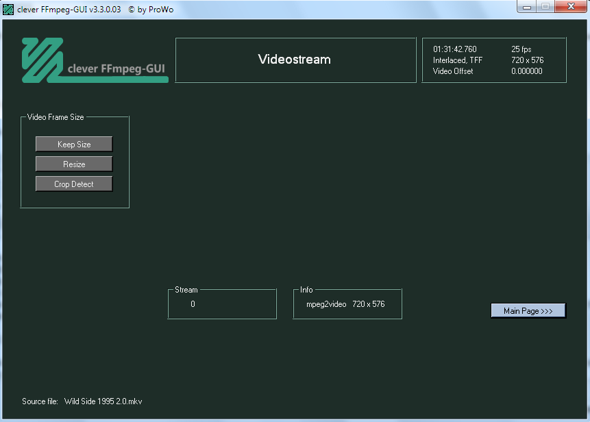

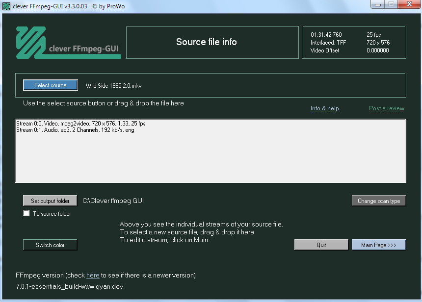

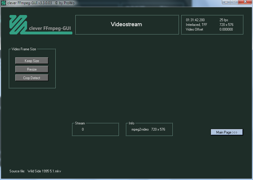

    Yes that's correct both sources are 25fps, yes I know it is bizarre that there is an audio delay of almost 6 seconds but there is no apparent sync issue oddly enough, I'm not complaining as it is perfectly in sync.
    [Attachment 82808 - Click to enlarge]
    [Attachment 82809 - Click to enlarge]
    [Attachment 82810 - Click to enlarge]
  26. OK, that's good, no audio delay, the audio is shorter then the video, but the difference stays at the end, with almost 6 seconds missing, but this is no problem in this case.
    The 5.1 track does not need to be re-encoded, it is just a matter of finding the correct start.
    Simply mux it with the new video and play it.
    If you are lucky, it will already be synchronized.
    If not, you will need to find the correct audio delay.
    Play it with the VLC player and change the value of synch audio track (menu tools, synch tracks) until the audio is synchronized.
    Note the value and remux the 5.1 track with the new video and enter the noted value in Audio delay.
    The audio should now be synchronized.

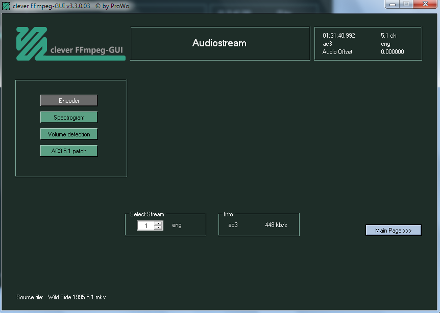

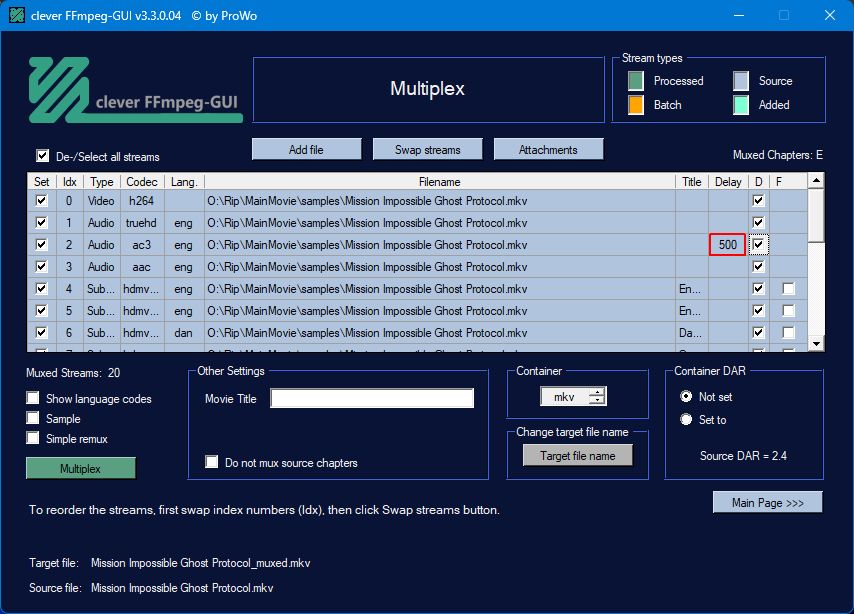

  27. @ProWo Thanks, I've already tried to simply mux the 5.1 track with the other video source but it was fairly out of sync but I'll report back with what I find using VLC player, hopefully only -10ms of delay will be needed.
    I just thought for reference these are from the 25fps source with the 5.1 track,
    [Attachment 82811 - Click to enlarge]
    [Attachment 82812 - Click to enlarge]
    [Attachment 82813 - Click to enlarge]
    I don't understand why the 5.1 track will not simply sync up correctly as they are both 25fps sources with a slightly different video duration, the 5.1 track has a video duration of 01:31:42.760 & the other source with the 2.0 track has a video duration of 01:31:42.200, so a difference of 560 milliseconds.

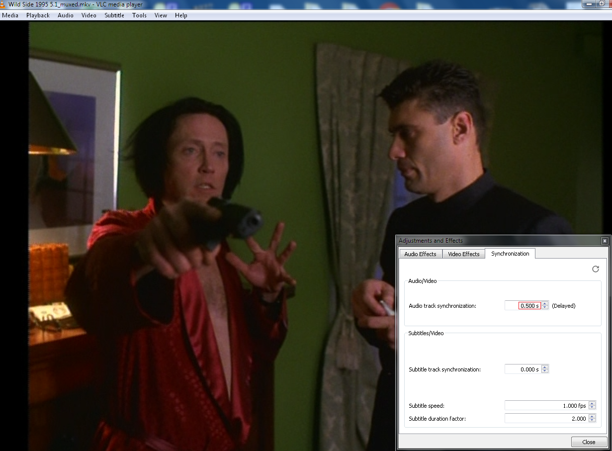

  28. @ProWo I think I've nailed the 5.1 audio track synchronization, it only required .500 s of delay (is this merely half a second of delay, is it the equivalent of 50ms) according to VLC player using "Track Synchronization", now is there an option to re-mux this track with the delay using Clever FFmpeg-GUI or must I use MKVToolNix?
    [Attachment 82822 - Click to enlarge]
  29. In the mux grid, in the audio stream row.
    [Attachment 82823 - Click to enlarge]
