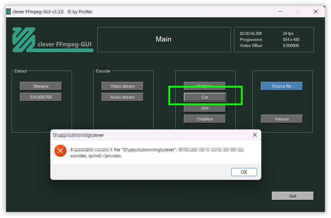

  24. on latest 3.3.0 i get error on Cut video
    [Attachment 82055 - Click to enlarge]
    here ffmpeg version on bin folder
    [Attachment 82057 - Click to enlarge]
  25. @ Iomero
    Unfortunately, I cannot read the error messages.
    Cannot reproduce the error here.
    Everything works as it should.
    Delete this file and then try again:
    portable.config

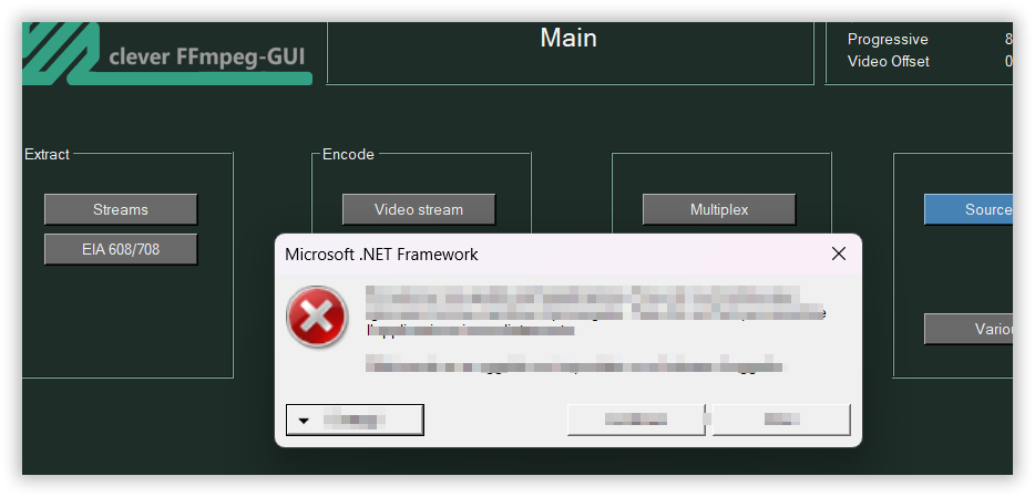

  26. please, my nick is lomero, with L lowercase, not I uppercase
    however, delete file portable.config and same error (but now error about Net Framework)
    and this error only with Cut function...
    [Attachment 82079 - Click to enlarge]
  27. @lomero
    is your system32 path = C:\Windows\System32?

    ?? yes i have C:\Windows\System32
    but my OS is win 11 x64 23H2
    i think issue is due to Net Framework. maybe need to update ? idk what Framework i have on my OS (never updated Framework only)
    However the weird thing is that this error is only with Trim. everything else works without problems
