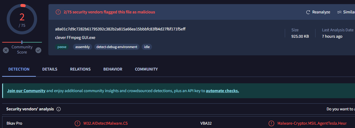

  16. Originally Posted by gabrieloliveira View Post
    Download from here
    https://files.videohelp.com/u/292773/clever_ffmpeg_gui_328.zip
    and check the MD5
    MD5 (of clever FFmpeg GUI.exe): EB7B466D8C8732421A9A48CB0B8C74AE
    then the alert is false alarm and the app is safe.

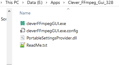

    Location of the folder is: E:\Apps\Clever_FFmpeg_Gui_328 & renamed some files as shown in the attached pic....still getting same error...whereas version 327 is ok?
    Image Attached Images

    Download from here
    and check the MD5
    Kindly post SHA-256 ...my pc due to some GROUP POLICY settings does not allow MD5 anymore. Confirm, the SHA256 of "cleverFFmpegGUI.exe" is A8A01C7D9C7282B61795392C382B2A815A66EA15BBBFC83F84 D27F6F171F5EFF
    a8a01c7d9c7282b61795392c382b2a815a66ea15bbbfc83f84 d27f6f171f5eff
    sha256 matches, file is safe.
    You shouldn't rename the files in my zip, they must remain as they are.
    Extract them and double click the exe.
    The program should start and ask you for the ffmpeg bin folder and so on.
    The error occours, if you load a video with illegal characters in its filename.
    No Bro, that's not the case. The error appears as soon as GUI.exe is launched (even if it has its original name including other files), and it doesn't let me select the FFMPEG folder. I mean, the dotnet error box appears immediately. Finally, if I select continue, then the folder select button to locate FFMPEG doesn't open.

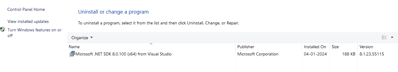

    SFC/SCANNOW is clean but there is no repair option for dotnet:
    I don't know much about dotnets, but it seems to be backward compatible.
    Dotnet on my system:
    Microsoft Windows [Version 10.0.19045.4651]
    (c) Microsoft Corporation. All rights reserved.
    C:\Users\Rana>dotnet --list-sdks
    8.0.100 [C:\Program Files\dotnet\sdk]
    C:\Users\Rana>dotnet --list-runtimes
    Microsoft.AspNetCore.App 6.0.32 [C:\Program Files\dotnet\shared\Microsoft.AspNetCore.App]
    Microsoft.AspNetCore.App 8.0.0 [C:\Program Files\dotnet\shared\Microsoft.AspNetCore.App]
    Microsoft.NETCore.App 6.0.32 [C:\Program Files\dotnet\shared\Microsoft.NETCore.App]
    Microsoft.NETCore.App 8.0.0 [C:\Program Files\dotnet\shared\Microsoft.NETCore.App]
    Microsoft.WindowsDesktop.App 6.0.32 [C:\Program Files\dotnet\shared\Microsoft.WindowsDesktop.App]
    Microsoft.WindowsDesktop.App 8.0.0 [C:\Program Files\dotnet\shared\Microsoft.WindowsDesktop.App]
    Whereas searching dotnet in Control Panel-> Programs gives:
