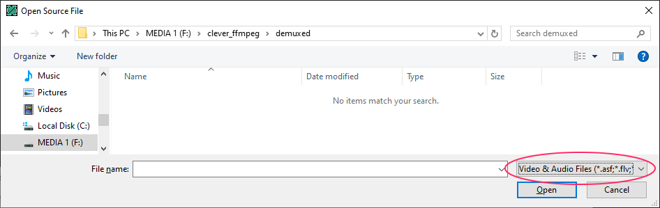

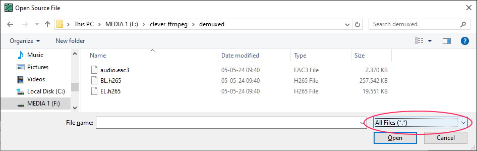

    Hi ProWo,
    Just a minor thing. Browsing for sourcefiles in your GUI, h265, eac3 (and other) files don't show up with the lower-right type-window set at its default "Video & Audio Files (*.asf;*.flv etc...)". I think not all supported filetypes are added here.
    [Attachment 78844 - Click to enlarge]
    Where setting the windows to "All Files (*.*)" does make the streams show, making them able to be selected.
    Would you care to correct this? I'm running version 3.2.6.

    Will be changed in the next beta.

  16. Member Ennio's Avatar
    May 2005
    Netherlands
    Newest beta (v3.2.6.01), online now.
    ...Changed: Filter removed on file search (request by Ennio).
    Source-browsing now working like a charm. Thanks for this fix

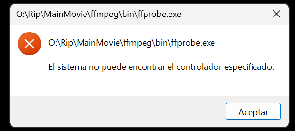

    Hi , using v3.2.6.01 i got this, pressing the button cut, i dont have O: unit.
Name:	Captura de pantalla 2024-05-31 170600.png
  21. Originally Posted by Ndidi View Post
    Confirm this bug, it's a leftover from a test environement.
    I'll fix it and upload a new beta (v.3.2.0.02) today.

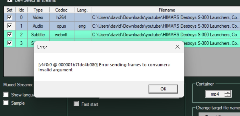

    [Attachment 79616 - Click to enlarge]

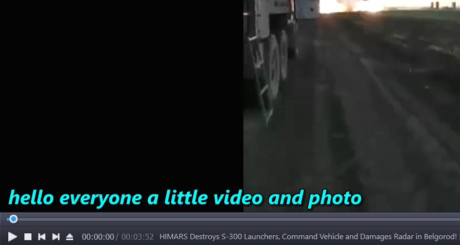

  24. Adding webvtt sub to MKV and muxed as MKV. Subtile is displayed on the left side of the screen and is not removable. It should be in the middle of the screen and movable. I can replicate this behavior with ffmpeg if I use -c copy. If I use -c srt or -c webvtt, the subtitle behaves correctly.

  25. @davidt1
    I did some tests and found that the webvtt codec is incompatible with the mp4 container.
    I will therefore block the muxing of webvtt to mp4 in the next beta.
    Muxing webvtt subtitles into the mkv container with clever FFmpeg-GUI works fine here. The subtitle is centered, just as it should be.
    Please post one of your webvtt subtitles here so I can reproduce your problem.

    using ffmpeg, I added a webvtt sub to a mp4 video. The -c mov_text codec works fine.
  27. With
    -c mov_text
    you're recoding the webvtt subtitle to mov_text, witch is compatible with the mp4 container.
