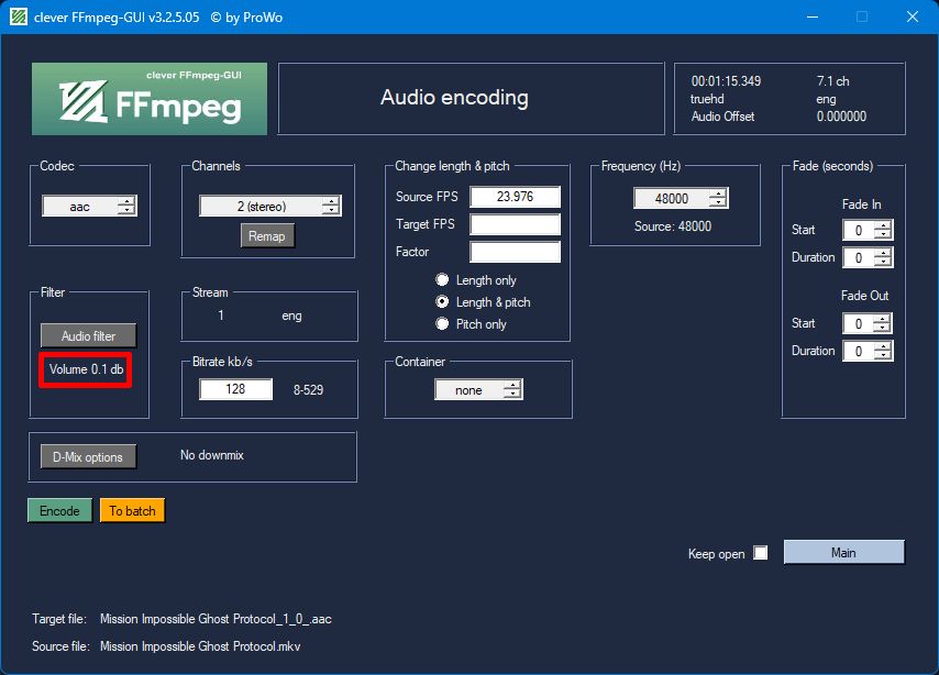

    e.g. in previous versions, after a volume scan, the determined values were displayed. Currently, I am immediately taken to the other settings.
    So I no longer see the scan result. It is also not used by the program.
    That is not correct. After the volume analysis, the audio encoding window is opened directly and the value determined is displayed in db and also used if it is greater than 0. You can also change this value clicking on audio filter.
    [Attachment 78500 - Click to enlarge]

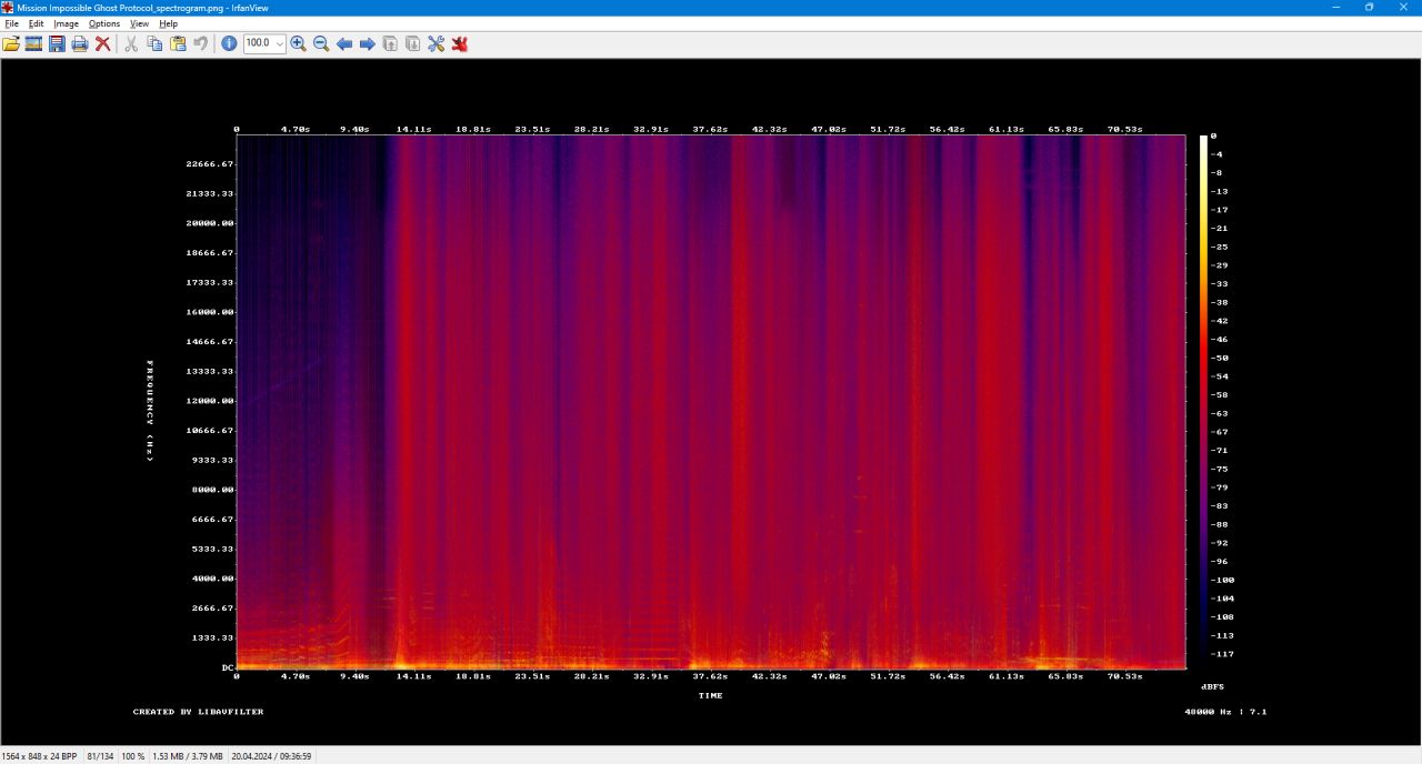

    e.g. the "Spectogram" option scans the audio stream. I would now expect a graphic or a file so that I can view the spectogram.
    I am missing both. No graphic on the screen, no file anywhere on the hard disk.
    After the analysis, a png file with the name of the video/audio file is created in the destination folder and automatically opened with the viewer that is linked to png.
    If this image is not opened automatically, you are missing the link from png to an image viewer.
    Right-click on a png file, open with, select another app, select your image viewer, click always.
    [Attachment 78501 - Click to enlarge]

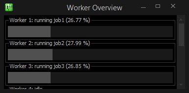

    maybe i didn't explain it well. See this picture, it is the worker from megui processing 3 jobs at same time.
    The implementation of this feature will make the batch feature in clever FFmpeg-gui so powerful and well, we have cpu cores and their threads to take advantage of time, precissely what your tool is doing possible with such amazing features.
    This has no advantage.
    If the first job uses 100% cpu, then e.g. 3 simultaneous jobs use 3x33% cpu.
    The total time requirement remains the same.

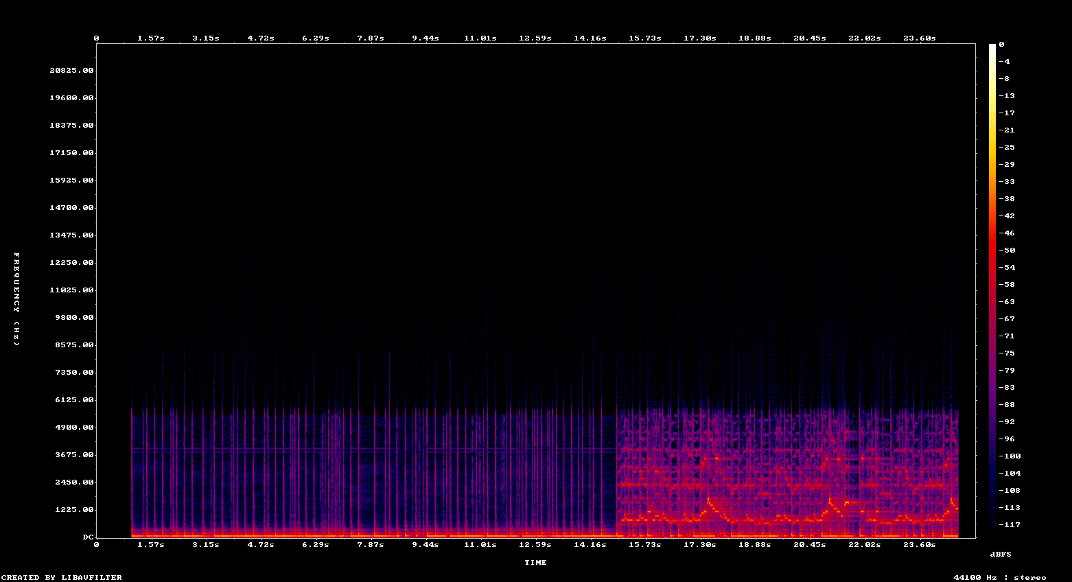

    The spectrogram should of course also work with 32 bit systems, unfortunately I cannot test this.
    Download the enclosed png file (right click, save graphic as) and double click on it.
    Does it open and display?
    If not, change the file association for png as follows (in the example for windows 7):
    https://www.youtube.com/watch?v=VPBNKnRuk54
    If this is successful and the png file opens automatically when double-clicked, then try again with clever FFmpeg GUI.

    ^Of course i meant that, when it is possible, example the audio encoder, same as was doing megui on that capture. For video encoder, probably not. See the fact that sometimes i push megui to audio encoder 8 tasks at time. All depends on the cpu and its cores/threads. The user must know about its cpu, and when proceed the multi-threating and when not.

    ...The spectrogram should of course also work with 32 bit systems, unfortunately I cannot test this.
    I can open a PNG file without any problems. But if none is created there is nothing to open. I can also live without the Spectogram.
    I'm just curious to find out why it's not being generated.
    Is there a switch in the ffmpeg configuration that should be activated? (e.g. --enable-, --pkg-config=, --extra-cflags= etc.)
    If so, which one is it exactly? Then I could check whether this switch is present on 32 bit builds.
    Sorry for the question, I'm pretty clueless. But to look the ffmpeg commands, that's still just about possible...
    Thanks for your effort
    Amiga
    EDIT:
    Spectrogram with Files near 1 GB or above are not working with 32 Bit, because "Out of memory" error.
    ~100 MB Stereo Files working perfect. Clever FFmpeg-GUI do not show that error, ffmpeg show it.
    Last edited by Amiga; 29th Apr 2024 at 14:22. Reason: Found the reason why spectogram was not created
  28. ^ spectrogram is very important to know the audio quality. Thanx to it, one discover how the ppl, and even the platforms, create commonly very very bad audio...
