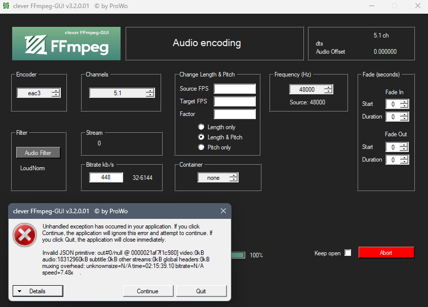

    here's the LoudNorm error:
    [Attachment 75875 - Click to enlarge]
    ************** Exception Text **************
    System.ArgumentException: Invalid JSON primitive: out#0/null @ 0000021af7f1c980] video:0kB audio:18312960kB subtitle:0kB other streams:0kB global headers:0kB muxing overhead: unknownsize=N/A time=02:15:39.10 bitrate=N/A speed=7.48x .
    at System.Web.Script.Serialization.JavaScriptObjectDe serializer.BasicDeserialize(String input, Int32 depthLimit, JavaScriptSerializer serializer)
    at System.Web.Script.Serialization.JavaScriptSerializ er.Deserialize(JavaScriptSerializer serializer, String input, Type type, Int32 depthLimit)
    at System.Web.Script.Serialization.JavaScriptSerializ er.Deserialize[T](String input)
    at clever_FFmpeg_GUI.Form4.Jason_read(String parsed)
    at clever_FFmpeg_GUI.Form4.VB$StateMachine_361_FFmpeg Async.MoveNext()
    --- End of stack trace from previous location where exception was thrown ---
    at System.Runtime.ExceptionServices.ExceptionDispatch Info.Throw()
  9. Try to mux the dts stream in a mkv container first and repeat the loudnorm operation with the mkv
  10. Originally Posted by ProWo View Post
    getting the same type of error with the mkv container too.
  11. Originally Posted by mannequin80 View Post
    I have tried it here again with several dts files, individually and in a container, but everything works as expected.
    You can try two things.
    1) a newer ffmpeg version
    2) delete this folder (it will be created again automatically):
    C:\Users\xxx\AppData\Local\clever_FFmpeg_GUI (where xxx=your user name on windows)
    and restart clever FFmpeg-GUI.
    You can also upload this DTS file somewhere and post the link here, then I can give it a try.

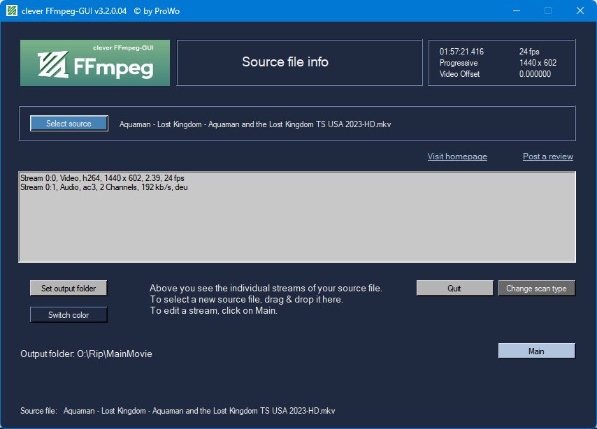

  29. Newest beta (v3.2.0.04), online now.
    New:
    Batch tasks, possibility to replicate commandline from 1st task to many files (request by ingsoc), not documented.
