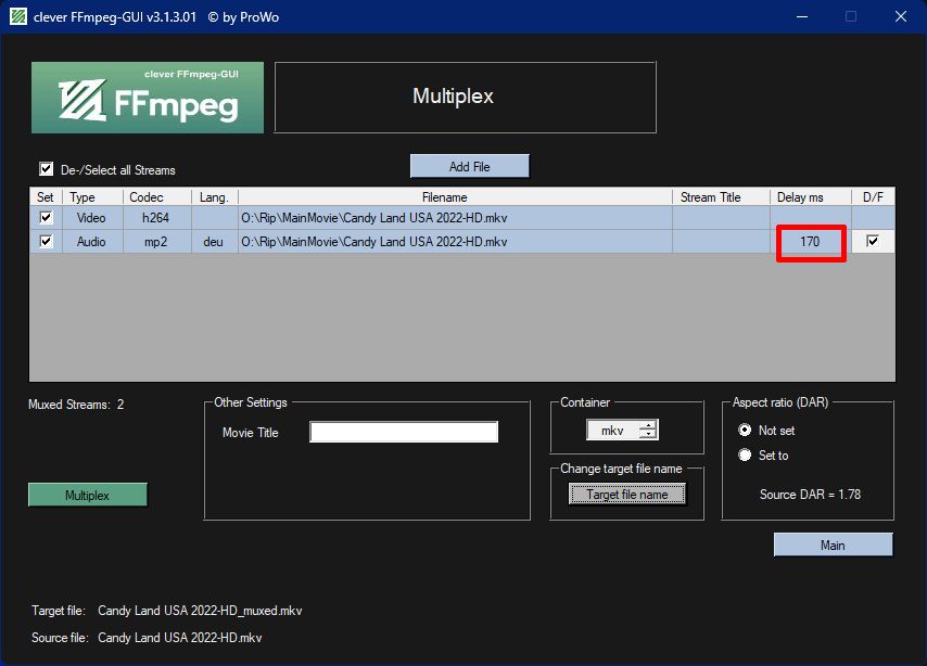

  21. Hello, is it possible to do framerate conversions to audio files only (avoiding video re-encoding/processing), but using videos as input files?
    I mean, let's say I have a 24 fps MKV video file, and I want to change the framerate from one of its audio tracks to "23,976", so the output
    should be another audio track with a different framerate.
    By the way, is there a chance of adding "delay" to tracks? By the way, what's the "offset" meaning for audio/video files?
    Should it indicate an already applied delay for the processed files?
    And regarding input values' fields, it would be great to have "drop down menus" with predefined
    values to choose from, instead just tiny up/down arrows or having to input the values manually.
    Thanks.

  23. Originally Posted by FTG View Post
    Yes of course. Load your mkv, click main, click encode audiostream, select your audiostream, click go to the encoder, make your settings and click encode.
    When it's done, you'll find your new audio file in the target folder
    Should it indicate an already applied delay for the processed files?.
    This makes no sense, an audio delay is only useful in relation of the audio stream to the video stream.
    The offset is the difference to the optimal start time of the stream (zero).
    A difference of the audio stream offset to the videostream offset results in an audiodelay (positive or negative).
    Thanks.
    This has no advantage, but rather disadvantages.
    How else can you encode a video with a frame rate of 12.73 fps, for example, if the input field only provides fixed values?
    This layout remains as it is and will not be changed.
  24. Yes of course. Load your mkv...
    Great.
    That's precisely the reason I would need to use that feature, since I'm dealing with a movie which is running at "23,976",
    and I'm needing to multiplex one of their dubbing tracks into another version, which runs at "24" fps. I would need to
    convert the framerate with pitch correction, but since there is a slightly difference at the beginning of the target movie
    (a few silence seconds), I will also have to workaround that issue, in order the dub's synchro matches perfectly with the target movie.
    I know I could simply add the needed delay amount to the relevant track using tools like MKVToolNix, but why not
    dealing with the issue all at the same time, with your tool instead? I already tried two different tools which will allow me
    to make framerate conversions, but none of them have what's needed to complete the process straightforwardly:
    While "MeGUI" will allow me to input the needed dubbing track, select the from/to FPS values and even add
    a desired delay, its menu of available "predefined" framerates values is lacking specifically the one I'm needing (23,976>24).
    On the other hand, "FFMPEG Audio Encoder" will allow me to select the specific framerate values I'm needing,
    but has no options regarding adding delay values, so I will need to add it manually later, with another tool or just edit the audio track.
    This has no advantage, but rather disadvantages....
    What I mean is allow the users to have a list of predefined, "common", framerate's values to choose from,
    and still giving the chance of adding an specific value manually, but just if needed. I think it will be just
    make the process quicker for most cases. A similar scenario respect other parameters' selection, why to make
    several clicks to find the exact value you are needing, when you could simply make two, if using a drop-down menu?
  25. Originally Posted by FTG View Post

    Insert the desired delay im milliseconds into the audiostreams delay field.
    A positive value means that the audio stream starts AFTER the video stream by this value.
    A negative value means that the audiostream will start by this value BEFORE the videostream.
    [Attachment 72870 - Click to enlarge]

  27. [QUOTE=ProWo;2700045]
    That would mean going the other way around regarding what I mentioned before, since
    there would be needed two separate tasks, instead of doing it all at once. Ideally, the resultant
    file's properties should keep the same way as those from the original elementary audio streams
    which were used as source, like in a "stream copy" process, with no further file format conversions.
    By the way, besides the obvious "less clicks" advantage of choosing values from "drop-down" menus,
    is that of a no error prone approach, that which involves sometimes having to enter "exact" values manually.
    Thanks anyway.

  29. Originally Posted by FTG View Post
    In any case you have to do two tasks, first the audio conversion (e.g. from 25fps to 23.976fps) and then the muxing of the newly created audio file with the video stream.
  30. [QUOTE=ProWo;2700176]
    Given the limitation, after converting the framerate with your tool, in case I need to a add few seconds of delay
    to an audio stream, I would just do it with MKVToolNix, so to avoid unneeded multiplexing tasks. This would mean
    quite a lot, mostly when dealing with UHD repacks. I wanted to avoid doing it with MKVToolNix in first place due to
    the reason some relatively old TVs won't play files which have a certain amount of added dalay.
