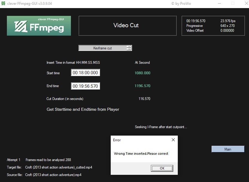

    Mar 2008
    ProWo, I'm taking a look at your GUI. can you tell what is wrong here?
  22. Originally Posted by davexnet View Post
    Could you post this file everywhere so i can take a look on it on monday?

    Is there a way through the interface to reload a different version of ffmpeg ?
    I had to rename the old folder to get Clever to prompt me for the location again.
    EDIT - Once I updated FFmpeg to the latest (version 6.0) the CUT is now working.
    Do you have a minimum version of ffmpeg that works or is recommended? Old version was 4.4
  26. Originally Posted by davexnet View Post
    No
    Im using v6.0 too.

    OK. So I either have to rename the folder, or perhaps delete the appdata\local\clever....... user.config
    I know the interface is minimalist, but how about having a warning if the FFmpeg version is too old,
    or mention it in your readme...
  28. Originally Posted by davexnet View Post
    You can also simply replace the ffmpeg folder with a newer one.
    For the warning, thanks for the hint, will see what can be done.
