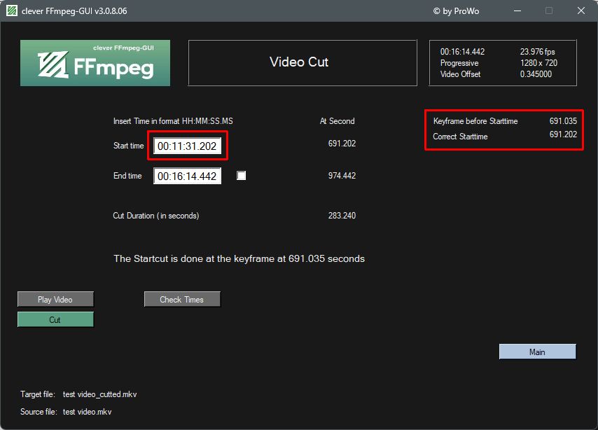

  6. I'm having a bit of an issue with the cutting tool in the standard v3.0.8 and in the beta v3.0.8.04.
    Essentially what seems to be happening is I enter a start time (11 minutes, 32 seconds), I click the "Read Times" button, the tool calculates that I mean the frame at 691.035 seconds... but then it re-assigns the value of the Start Time field to be 00:00:00.691 - it's assigning the seconds value to the field's milliseconds section. The value reassignment means that if I hit Cut at this point, it just shaves maybe one frame off the front of the video.
    The end time value works fine and cuts fine, it's only the start time value that is having the issue.

  8. Originally Posted by zahaqiel View Post
    The input mask for the start time is created for the fomat HH:MM:SS.MSS. When pressing the Read times button, the keyframe is determined BEFORE the entered time (because ffmpeg cuts exactly here). This exact cut point is given on the right in seconds, the corresponding time is automatically converted and displayed in the input field. So you don't need to enter anything here.
    If you want to enter e.g. 691.035 seconds in the input mask, you first have to convert it to the given time format (in this example 00:11:31.035).

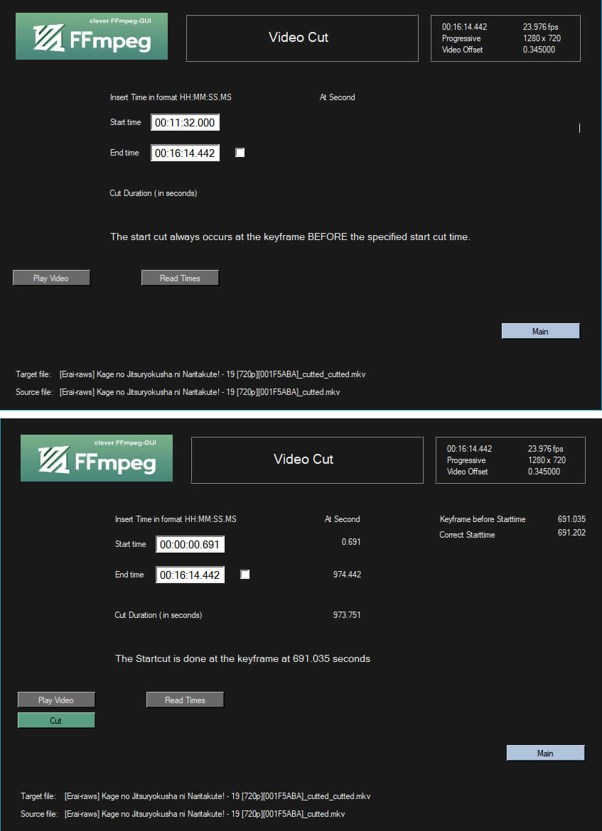

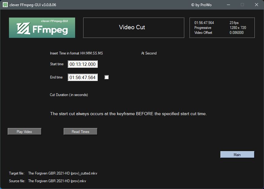

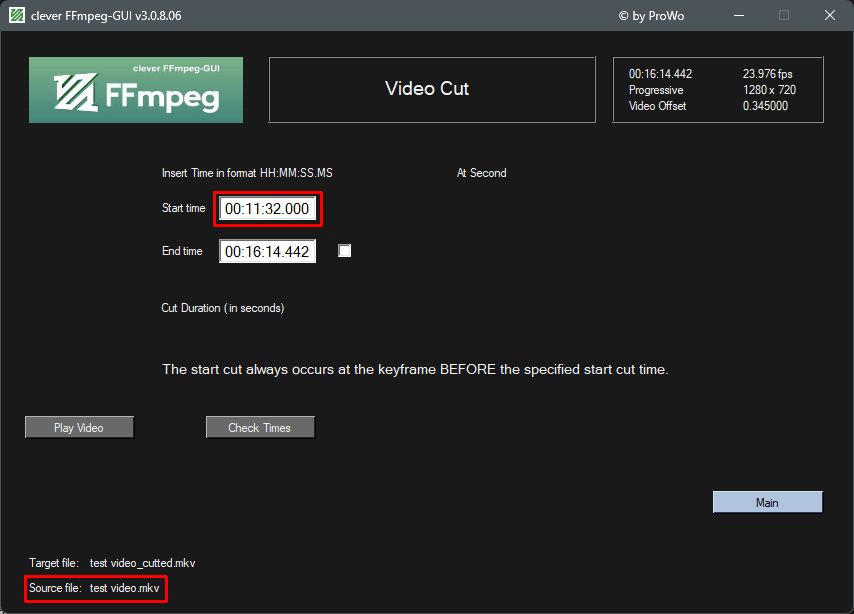

    Yeah, you're misunderstanding me, so I'll take some screenshots. I am not entering the 691 value, and I have zero interest in entering a Start time that way.
    I enter "00:11:32.000" as the Start time. I click "Read Times" and there is a brief flash in the "At Second" readout where it says 692.0 (the value I input, but in seconds), it then flashes up the "Keyframe before Starttime" value as 691.035 and the "Correct Starttime" as 691.202 (all good so far), but then the "At Second" value changes on its own to 0.691 (one thousandth of the time for the correct keyframe), and the "Start time" field changes on its own to copy that value into itself as "00:00:00.691". The "Keyframe before Starttime" stays displaying 691.035 and the "Correct Starttime" stays displaying 691.202, but if I click Cut those change again to match the newly assigned Start time field value/At Second value and the actual cut that occurs aligns with the 0.691 seconds value, not with the 691.035 seconds value.
    Before and after using the Read Times button:
    [Attachment 69193 - Click to enlarge]
    There is nothing I can do to make it use the "00:11:32.000" input, because if I change the Start time again to correct it, it hides the Cut button and makes me run Read Times again, which just does exactly the same thing. And as stated above, using the Cut button cuts it at the bad Start time it's re-written my start time as, not the 00:11:31.035 keyframe it calculated that I asked for.
    Also the source file I use does not affect this issue. It happens for every video file I've tested and any input time - if I put the Start time as 00:01:00.000 it calculates I want 60 seconds in, and then calculates the desired keyframe as 58.058 and then messes up the "At Second" value and Start time to be 0.058 seconds instead. Any Start time I input on any file gets divided into one thousandth of the value it ought to be, so it is not possible for me to set a meaningful Start cut point.
    And unfortunately I can only put in double-digit hours, so I can't just input one thousand times the start time point to get it to math error itself into giving me what I want (which in this case would be 192 hours, 13 minutes, 20 seconds => 0 hours, 11 minutes, 32 seconds), not that I really expect that solution would have made it past the keyframe check anyway.
    And I've now tested it across v3.0.8 and betas v3.0.8.04 and v3.0.8.05. Same issue in all three.
    (NB: This issue does not occur with the End time value. It calculates correctly, and I have no issue cutting off stuff from the end of a video, only from cutting stuff out of the beginning of a video)
    Last edited by zahaqiel; 13th Feb 2023 at 12:28. Reason: Want to make sure I am absolutely clear about what is happening

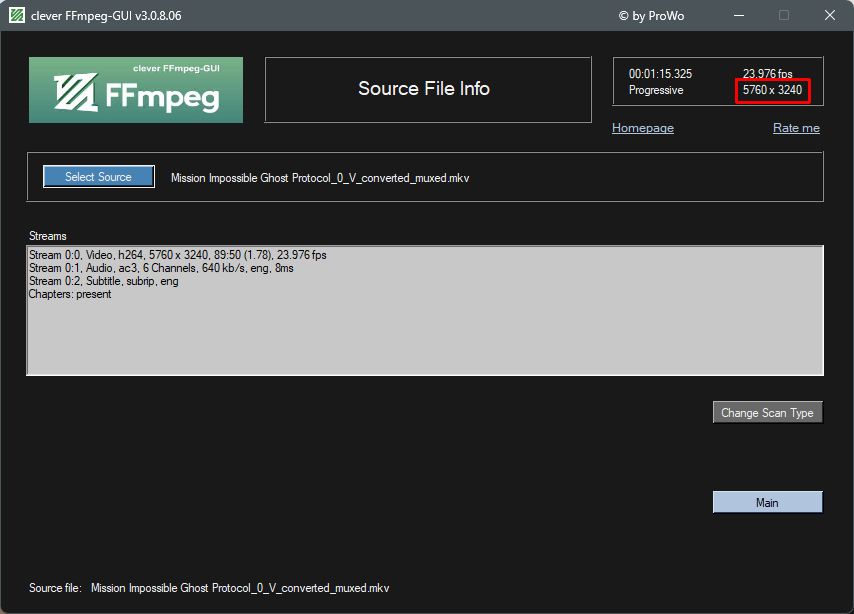

  25. Well, I just tried the last beta (.05). Now the GUI took 7 minutes (with no interlaced detection) to open a file (problematic 2160p) instead of 13 minutes. It's still very slow but it's a lot better. Is there anything else you can do to make this process faster ?
  26. Originally Posted by AlanFord54 View Post
    That is incredibly slow.
    Here, for example, a 5760x3240 video file is loaded in 0.5 seconds.
    [Attachment 69212 - Click to enlarge]
    It must be your system, either an extremely slow bus system, little ram or a weak CPU.

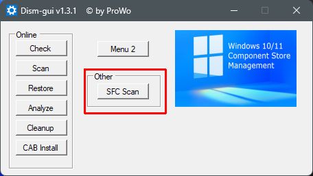

  28. The problem isn't The Start Time field (Masked Texbox), but the TimeSpan.FromMilliseconds function (returns a wrong value in your case), working everyware but not with your system.
    Try a last thing:
    Download https://files.videohelp.com/u/292773/Dism-Gui_1.2.9.7z
    Start Dism-Gui and do a sfc scan (system files check scan).
    If errors are found and repaired, repeat the scan.
    The restart your system.
    [Attachment 69216 - Click to enlarge]
