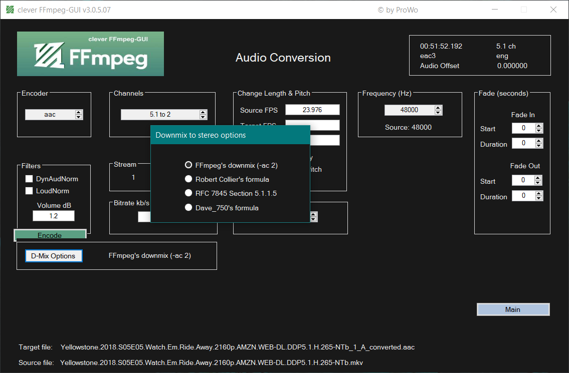

  1. Originally Posted by seehazy View Post
    Issue persists. However, 'Encode' button does appear differently.
    Try this one.
    Unfortunately, I can't test it myself because I don't have a monitor with a higher resolution/DPI.
    Feb 2013
    Try this one.
    Remains the same. There now appears to be a white borderline around many buttons/boxes. Screenshot attached.
    Like I said, could just be my machine. Maybe I should reinstall Visual Studio? I'll troubleshoot more on my end.
  3. Originally Posted by seehazy View Post
    Try this one.
    No, this is a known problem, it affects displays with scaling >100%.
    You can try to set the display scaling to 100%.
    Or you can try the attached version (DPI Awareness Mode disabled).

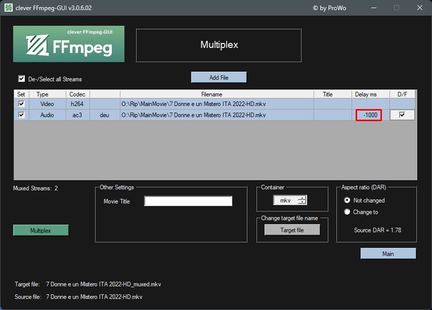

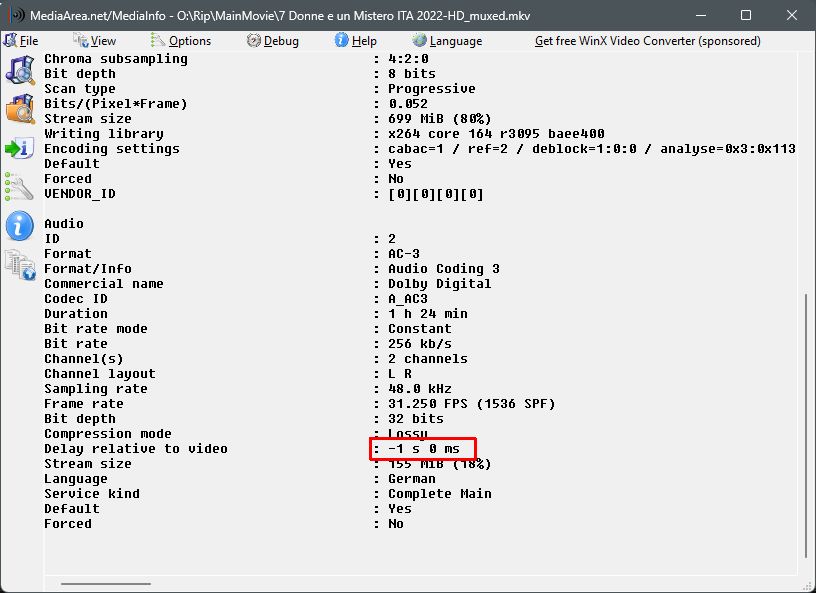

  15. Hi,While muxing,could we put latency on audio?
    I could put delay number as -1000 but it's effectless.
    Please could you help me?
  16. Originally Posted by mertkn View Post
    Just tested. Works properly here.
    [Attachment 68595 - Click to enlarge]
    [Attachment 68596 - Click to enlarge]
  17. Originally Posted by ProWo View Post
    I thank you so much,i guess i should test it with diffrent files too.
  18. I found my problem.
    1-While muxing the video and the sound with delaying at once ,Delaying doesn't work.
    After muxing the video and the sound,if i enter just delaying value without muxing,then Delaying works well.
    I mean both muxing and delaying doesn't work at once.
    If you feel need to see the its pictures,i can send.
  19. Originally Posted by mertkn View Post
    I found my problem.
    You are wrong.
    You must insert the audio delay value into the audiostrean row, then click multiplex.
    If you insert a delay value without muxing, nothing is done.
