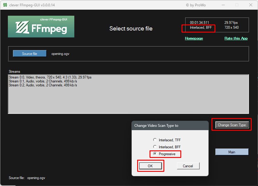

    The video you want convert is opening.ogv. Load this file in clever FFmeg-GUI, a message will appear that the scan type was not found. Click yes, the scan type analysis will be done and as result the analysis find Interlaced, BFF (wrong), confirm with yes.
    So you click change scan type, select progressive, confirm with OK.
    [Attachment 66054 - Click to enlarge]

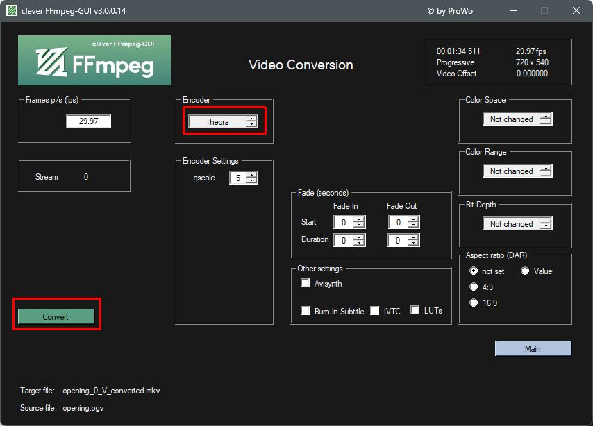

    Then click main, click convert VideoStream, click Keep size, select Theroa as encoder, leave all other settings as they are, click convert.
    [Attachment 66055 - Click to enlarge]

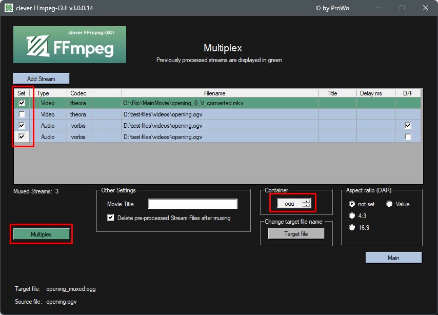

    If done, click multiplex, the new created videostream is shown in green and is already selected, select the original two Audiostreams too, select ogg as container (here was your fault), click mutiplex.
    [Attachment 66056 - Click to enlarge]
    If done, rename the resulting opening_muxed.ogg to opening.ogv and replace the original opening.ogv with this new file.

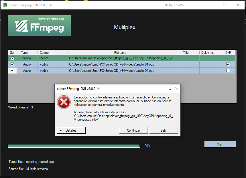

  10. I should mention that you are converting the wrong file, the file you were trying to multiplex was "video.ogv". and this not having audio track when I try to load it into the application showed me the following message:
    [Attachment 66060 - Click to enlarge]
    Anyway, I have created another file with an audio track so I can follow your tutorial, but when I muxar happens the following:
    [Attachment 66061 - Click to enlarge]
    This error does not occur if you skip the second step (VideoStream...), in both cases the final file is generated.

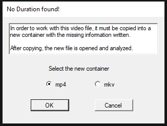

  11. These ogv files are missing important information.
    For example, a standalone ogv video stream maybe lacks information about duration and scan type (interlaced/progressive).
    If your load the file and you see the "No Duration found" message, then set mkv as container and click copy.
    (Unfortunately this does not work properly in 3.0.0.14, so I'll send you via PM the 3.0.0.15 in which the bug is fixed).
    Then follow the steps above.

  12. Originally Posted by Terwilf View Post
    This happens because the file has no duration info.
    This happens because the file was copied into a mp4 container and this doesn't work. It must be copied into a mkv container.

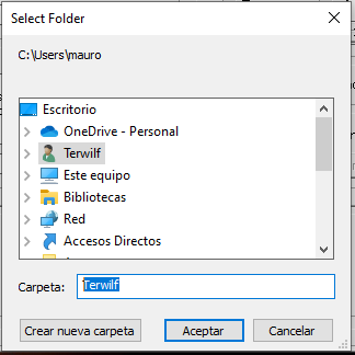

    On the other hand, it would be very practical if the configuration file was created in the application folder, considering that many of its failures are solved by removing it or at least that the executables are loaded automatically if they are in the same directory.
    Also, it would help a lot to use a dialog that allows you to paste a destination folder address, currently the app returns to its default location for every file you want to upload.
    [Attachment 66118 - Click to enlarge]
