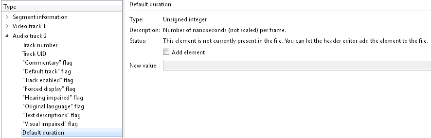

    I'm not sure if this has always been the case with FFmpeg's muxer but is there any reason when muxing DTS-HD MA & DD+ audio tracks the "Default Duration" isn't populated & the header field is empty unlike when I mux with MKVToolNix, the Default Duration for DTS-HD MA will report 10666667 & DD+ will report 32000000. The FFmpeg muxed mkv file has an empty header field, I'm only showing the DTS-HD MA selected track but DD+ track shows the same thing.
    [Attachment 94025 - Click to enlarge]

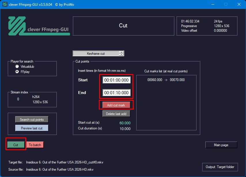

    Use clever instead. Load your video (muxed with clever, not with mkvtoolnix), click cut, wait for indexing, insert start and end as in the picture, click add cut mark, then click cut.
    [Attachment 94026 - Click to enlarge]
    Post the result here.

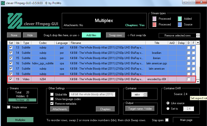

  5. @ProWo Thanks for that, I don't know why but I was unaware of Clever's cutting feature, thanks for letting me know. I'm sorry but I accidentally deleted the problematic file that couldn't be imported into eac3to & play on my OPPO players, I can't believe I did that, I did another AVC encode of the original 4K UHD file & this time it works without issues, I don't quite understand how this happened & can no longer duplicate the issue, what was different this time around is that when the AVC encoded video track finished & I selected the purple "Multiplex" button, the AVC track was the last track when it has always been the first track & then I'd add the source file but this time it appears to be reversed as you can see below, not sure if it has anything to do with the different beta versions from 3.5.9.02 to 3.5.9.03.
    [Attachment 94027 - Click to enlarge]
    I thought Default Duration was important for audio tracks to maintain seamless AV synchronisation & to ensure the broadest compatibility amongst hardware & software-based media players.
  6. Originally Posted by oniiz86 View Post
    ... the AVC track was the last track when it has always been the first track & then I'd add the source file but this time it appears to be reversed as you can see below, not sure if it has anything to do with the different beta versions from 3.5.9.02 to 3.5.9.03.
    It was changed in 3.5.9.03.
    The order now is:
    source streams
    preprocessed streams
    new added streams
