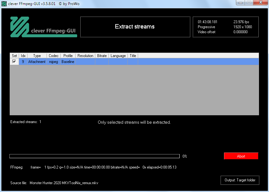

  1. Originally Posted by ProWo View Post
    Close clever and stop all running instances of ffmpeg in task manager.
    Restart clever, drag your video, click extract, select your attachment only and click to batch this time.
    Close the app. In your target folder you'll find a new BT_open.txt file.
    Post this file here.
    @ProWo I've attached the BT_open.txt file, I just realised that the "Simple Remux" option changed the Attachment which is listed at the end of the subtitle streams in the original file to a Video #2 Stream after the main video stream according to MediaInfo, is that meant to happen?
    MediaInfo - Original File
    Format : JPEG
    Muxing mode : Attachment
    Width : 600 pixels
    Height : 900 pixels
    Color space : YUV
    Chroma subsampling : 4:4:4
    Bit depth : 8 bits
    Compression mode : Lossy
    Stream size : 146 KiB (0%)
    MediaInfo - Clever FFmpeg-GUI "Simple Remux"
    Video #2
    Format : V_MJPEG
    Codec ID : V_MJPEG
    Width : 600 pixels
    Height : 900 pixels
    Display aspect ratio : 0.667
    Frame rate mode : Constant
    Frame rate : 90 000.898 FPS
    Color space : YUV
    Default : No
    Forced : No
    Color range : Full
    Matrix coefficients : BT.470 System B/G

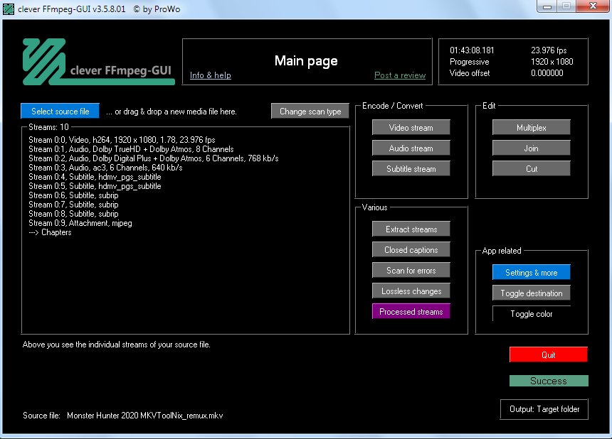

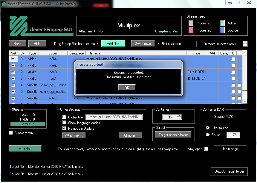

  2. @ProWo That 4K file above was fine during the "Simple Remux", it created that mux successfully but for some reason when I created an AVC video stream encode using Clever's HDR-SDR conversion which I then used with the original 4K file's select audio/subtitle streams muxed with MKVToolNix as it retains the attachment, it creates this "a zero byte file was generated" error when using the "Simple Remux" option, not sure why as the MKVToolNix muxed file isn't corrupted.
    [Attachment 93724 - Click to enlarge]
    [Attachment 93725 - Click to enlarge]
    Edit: After several attempts it finally completed with "Success" but I noticed it was hanging on 93% for awhile then jumped to 99% then completed shortly after, I'm not sure why this time it worked, the only difference I did was remove the file titled "Monster Hunter 2020" from within a folder titled "Monster Hunter" that was already in a folder, I tried to extract the Attachment or what Clever now refers to "V_MJPEG" of the AVC video stream encoded MKV "Simple Remux" file & according to the FFmpeg: line's activity this time it completes within about 5-6 seconds with "Success" & goes back to the "Main Page" like it should.
    [Attachment 93726 - Click to enlarge]
    [Attachment 93727 - Click to enlarge]

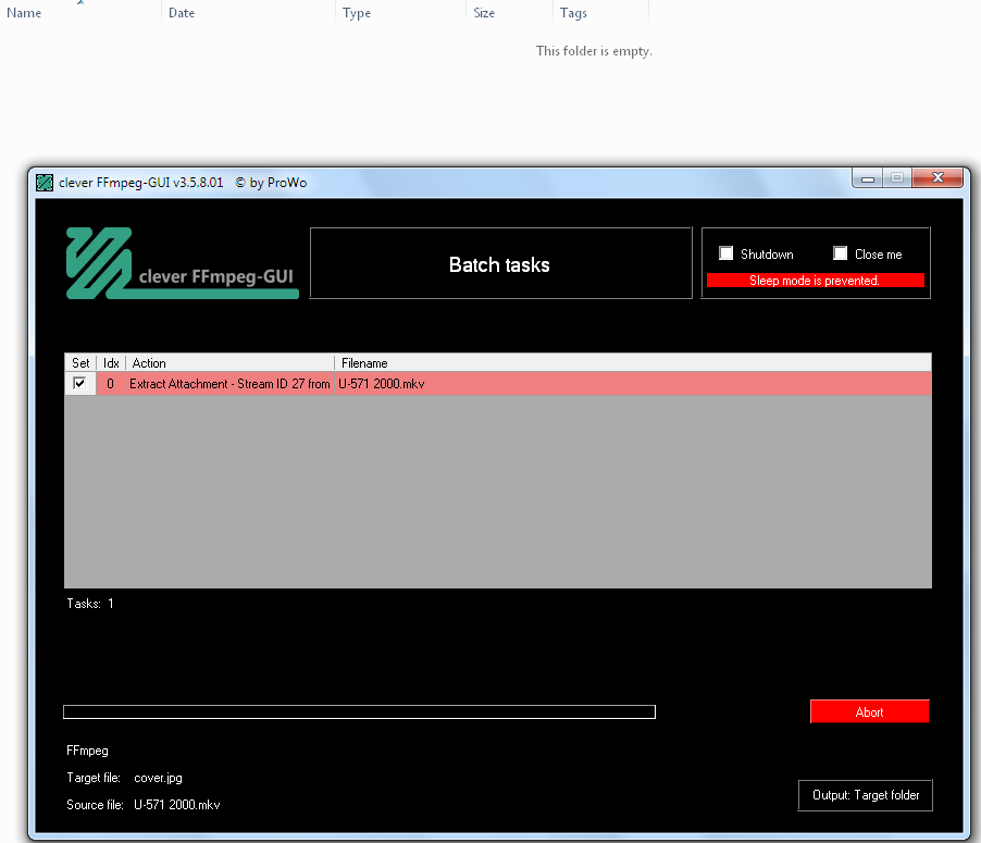

  6. Originally Posted by ProWo View Post
    Test this:
    Close clever, replace your BT_open.txt file with the attached one.
    Then start clever, click Open tasks and execute the task.
    It works this time?
    @ProWo I just tested this but unfortunately nothing happens, this is what I see below,
    [Attachment 93733 - Click to enlarge]
    Edit: I guess I spoke too soon, it does work but doesn't produce an attachment in my target folder & it takes around 3-4 minutes to complete & goes to the "Main Page" with Success. Is there any particular reason why something so small in size is taking so long to process? Could it be the FFmpeg version, I'm using 9.0.1?
    Would you be able to show a small clip on how quick it is for your setup which I presume is on a Windows 11 PC, I'm still using Windows 7 perhaps that is the issue with patched for Win 7 FFmpeg builds.

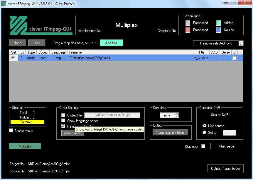

  12. @ProWo I was wondering why if one wants to mux an AAC audio only track, no video track, there is only the .mkv option not .mka? MKVToolNix recognises only audio is present & will set the matroska container variant accordingly. Also just a minor thing with the language codes tooltip when you hover it mentions "Show valid 3digit ISO-639 2 language codes.", there should be a space between 3 & digit "3 digit".
    [Attachment 93797 - Click to enlarge]
  13. Originally Posted by oniiz86 View Post
    This are cosmetics, mkv and mka are both containers.
    Thx for the hint, will change it.

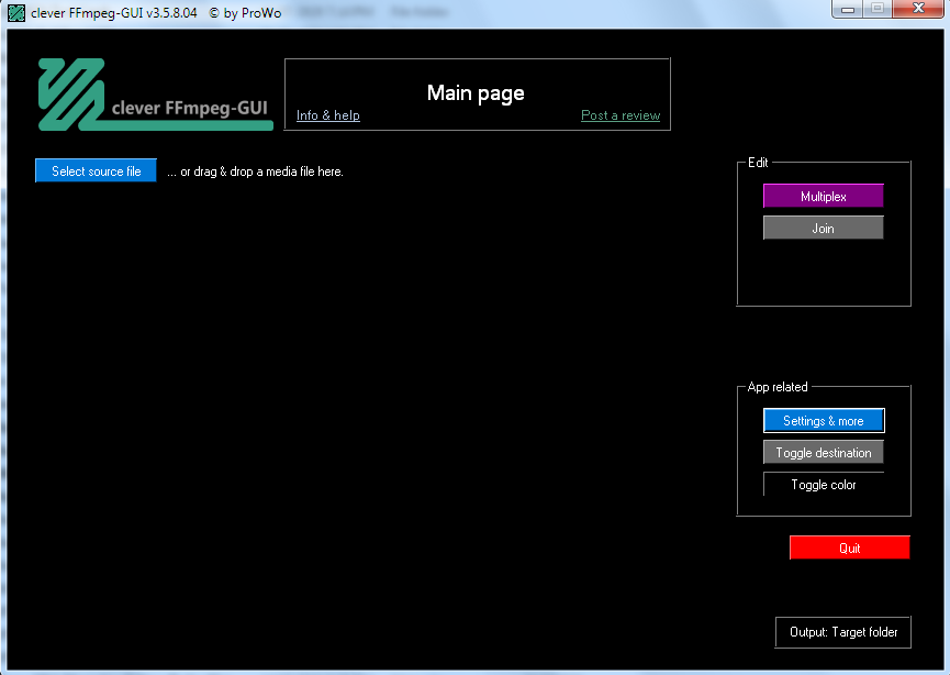

  15. Originally Posted by billw6560 View Post
    It's a PITA to have to reset the Output folder to the Source folder every time.
    Bill
    Hi Bill,
    click the Toggle Destination button once.
    Right below you'll see Output: Source folder.
    The setting is saved, so it remains the same at the next start.

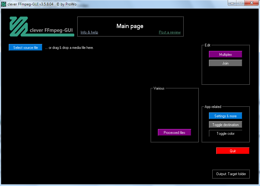

  17. @ProWo I'm not sure if this is normal behaviour but I believe the Info text is missing on the Main Page after I had muxed an mkv file, I used the HDR-SDR conversion to create an AVC video stream then I used the "Add Files" button for the audio/subtitle tracks then muxed which once completed, it returned to the Main Page below with the missing Info text, is that intended?
    [Attachment 93947 - Click to enlarge]
    Also I had another previously unused AVC video stream from a different file which I've yet to mux with Clever & when I clicked on the Purple "Multiplex" button in the above image then went back to the Main Page screen, a "Various" section popped up in the below image with a Purple "Processed Files" button.
    [Attachment 93948 - Click to enlarge]
  18. Originally Posted by oniiz86 View Post
    No, it's a bug, but is already fixed in my actual nighly.
    This is intended, it's a feature.
    It reminds you at startup that there are still processed but unused files.

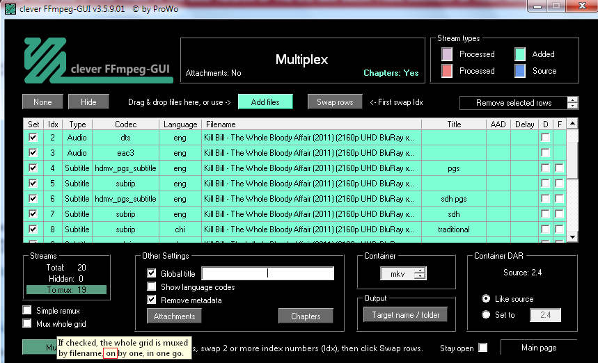

  20. @ProWo
    3.5.9 feedback
    If you select Interlaced on the Video encoding page, configure your settings, and then deselect Interlaced, the Deinterlace option appears.
    Before that, Deinterlace is not visible.
    That is presumably unintentional.
  21. Originally Posted by Findu View Post
    Thx, for progressive source it should be not visible. Will fix it.

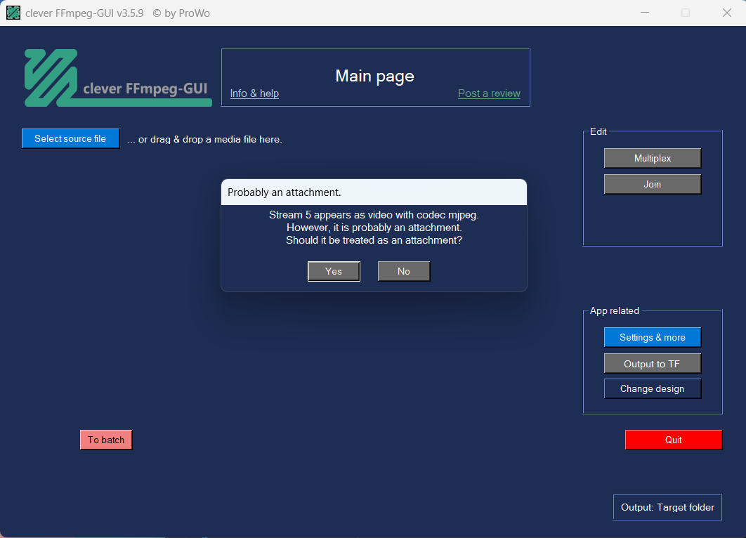

    When you drop a video with attchments at the desktop icon of the app, you get this Main page with an additional To batch button.
    [Attachment 93952 - Click to enlarge]
    Problem with stream detection of not longer existing attachments.
    Your sampel Video_with_attachments.mkv is displayed on the main page as:
    Stream 0:0, Video, mpeg4, 688 x 320, 2.15, 25 fps
    Stream 0:1, Audio, aac-main, 2 channels, -40 ms
    Stream 0:2, Audio, aac-main, 2 channels, -40 ms
    Stream 0:3, Subtitle, subrip
    Stream 0:4, Subtitle, subrip
    Stream 0:5, Attachment, mjpeg, cover.jpg
    Stream 0:6, Attachment, ttf, arlrdbd.ttf
    When you select All streams and encode the video stream 0 and open the processed mkv output, it shows at the Main page:
    Stream 0:0, Video, h264, 688 x 320, 2.15, 25 fps
    Stream 0:5, Video, h264, 3456 x 2592, 1.33, 25 fps
    But the file does not contain any attachment.
    You can also select stream 5 at Video encoding which then can cause problems.
    Same happens when you proceed a cut from a media file with attachment.
    But here, you can not select video stream 5 at Video encoding, which is better.

  24. @ProWo I noticed another typo when hovering over the Mux Whole Grid setting, the tooltip mentions "on by one, in one go.", it should be "one by one".
    [Attachment 93978 - Click to enlarge]
  25. Originally Posted by oniiz86 View Post
    Thx, will fix it.
  26. @ProWo
    3.5.9.02 feedback
    The Deinterlace option does not longer appear for progressive sources switching of Interlaced.
    The Main page does not longer show an additional To batch button.
    Video encoding using option All streams now copies an attached image.
    Thank you very much.

  28. @ProWo
    3.5.9.03 feedback
    Two minor points.
    When you abort a running scan for errors task, the info text line "To reorder rows, swap..." is also blinking, just like the progress text line.
    And if you stay on the page and run the aborted scan again, the blinking speed doubles.

  30. Originally Posted by Findu View Post
    Thx, bug, will be fixed.
