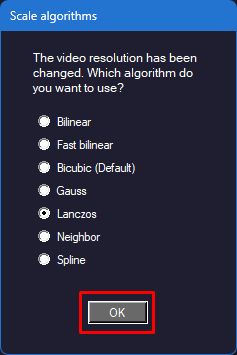

    Testing vpp_qsv filters.
    When I combine qsv hwaccel with qsv encoding and scaling of a video, it does not work.
    Because the code scale_type= is not supported for vpp_qsv. It is scale_mode=
    I'll leave out the scaling algorithm here (the default is “auto”).
    Scaling algorithm auto make sense and is working. Thank you.

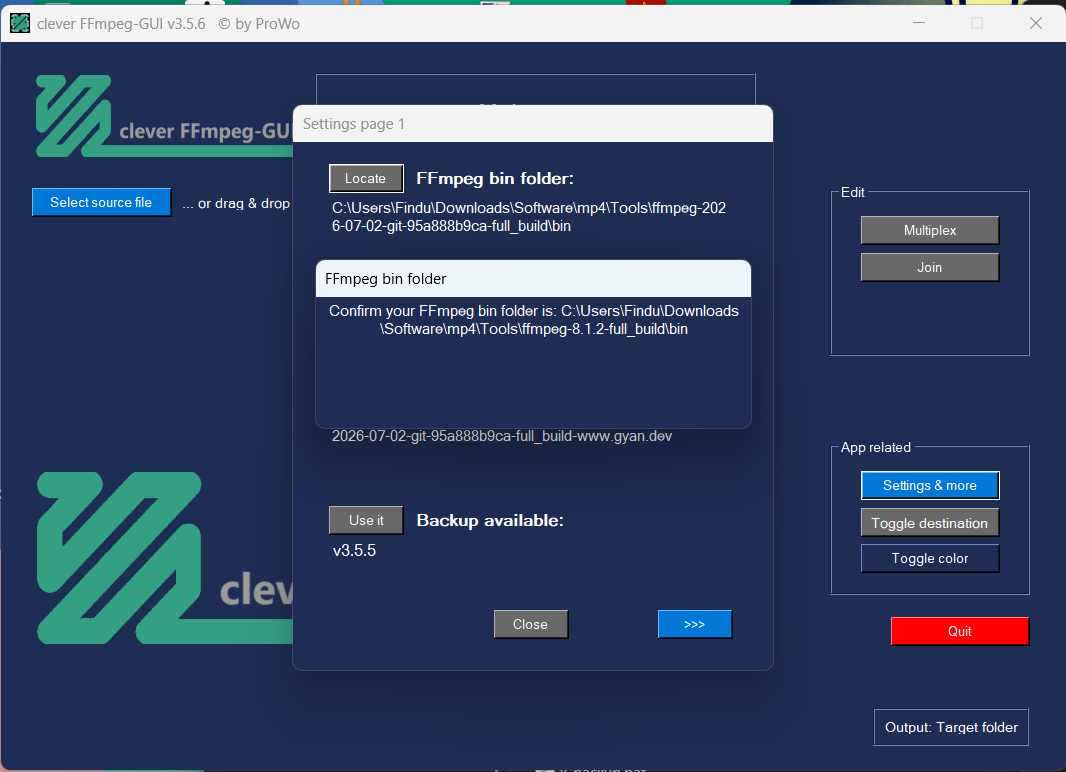

    BTW, it looks like that 'vsync' will be removed in newer ffmpeg builds:
    ffmpeg-2026-07-02-git-95a888b9ca-full_build
    Unrecognized option 'vsync'.
    Error splitting the argument list: Option not found

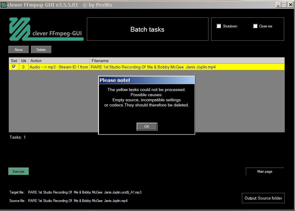

  5. @ ProWo,
    I tried the method you posted with 5 different .mp4 files.
    Clever did the batch conversion on 4 out of the 5.
    For one of the .mp4s Clever gave this error:
    [Attachment 92909 - Click to enlarge]
    The funny thing is when I did the same method to the file that caused the error by itself it converted.
    I can not find anything wrong with this file.
    I wanted to report the error.
    This conversion is not important to me I was just trying to help in another topic.
    I'm uploading the problem file in case you want to test with it.
    Note if you use it as the first file then the other 4 erred for my test.
  6. Originally Posted by cholla View Post
    @ ProWo,
    For one of the .mp4s Clever gave an error.
    This happens because the index numbers of the audio streams differ across the various MP4 files.
    In 4 out of 5 cases, the audio stream index is likely 1, and in the other case, it is 0 or 2.
    Since batch replication adopts the command line from line 0 (along with its index number), a different index results in an error.
    If the sources are pure audio files (and we can assume that’s the case given the question), then the index is 0 for all of them and there’s no problem.
  7. Originally Posted by ProWo View Post
    The sources are not pure audio.
    The input files are audio/video .MP4 files.
    Using ffprobe to check with this code:
    ffprobe -v error -show_streams input.mp4
    On the problem file it shows the audio stream first & it is 0(zero).
    On the rest it shows the video stream first & it is 0 (zero)
    The the audio stream is 1.
    You are spot on for the diagnosis.

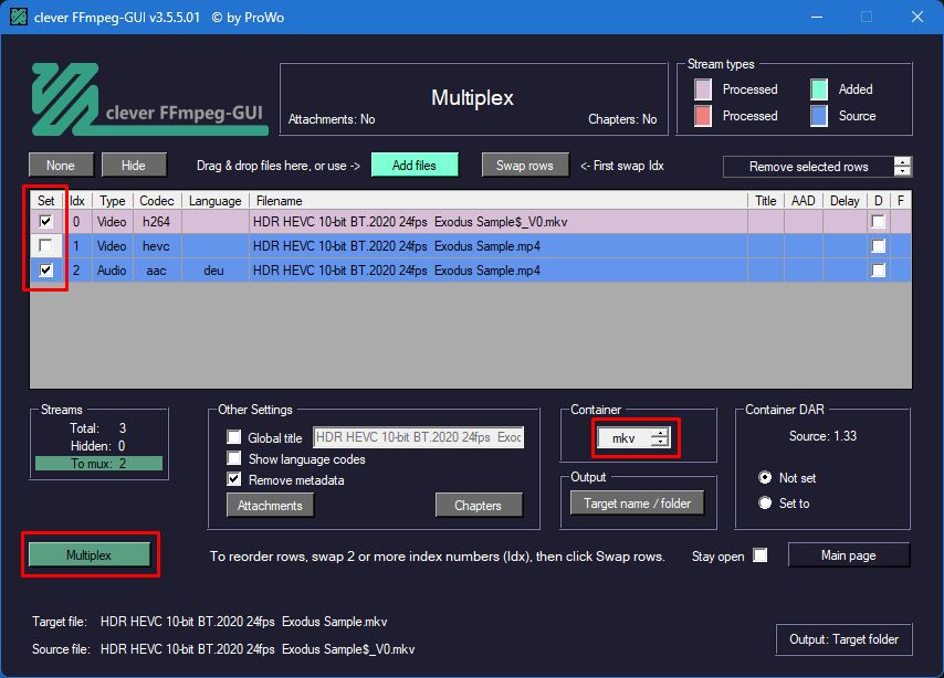

    In case someone else has the audio stream index problem (Wrong order with the video).
    I was able to change the ID with Clever Multiplex on the problem file.
    Once this was changed No more error.
    Replaced all vsync with the new fps_mode.
    Please test the latest nightly in your PM
  9. Originally Posted by ProWo View Post

    You now have two options:
    1) Resize it to 1440x1080 and keep HDR10
    2) Resize it to 1440x1080 and convert it from HDR10 to 8-bit SDR
    You can do both using clever FFmpeg-GUI.
    For compatibility with various playback devices, I would recommend option 2).
    Here are the steps for option 2)
    1) Launch Clever FFmpeg-GUI
    2) Drag your video into the window, then click “Encode video stream”
    3) Select x264 (avc) as the encoder, with a width of 1440 and a height of 1080
    4) Check the HDR checkbox, select “HDR10 to SDR,” and click OK
    [Attachment 92921 - Click to enlarge]
    5) The following window will appear; confirm by clicking OK
    [Attachment 92922 - Click to enlarge]
    6) Click “Encode”
    7) Confirm this message by clicking OK and wait until encoding is complete.
    [Attachment 92923 - Click to enlarge]
    8) Click “Multiplex,” uncheck the original video stream (in blue) on the left (all other streams should remain checked), select the container (mkv or mp4), and click “Multiplex.” Done.
    [Attachment 92924 - Click to enlarge]

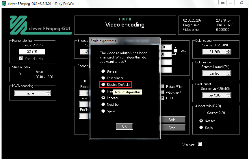

  23. @ProWo I was wondering if "Bicubic" could be pre-selected seeing how it is the default & preferred setting during the Scale Algorithms setting on the Video Encoding screen, not sure why Lanczos is pre-selected in this case, also when you hover over the "Bicubic (Default)" setting the tooltip has a typo error, algorythm should be corrected to algorithm.
    [Attachment 92934 - Click to enlarge]
  24. Originally Posted by oniiz86 View Post
    Because Lanczos produces sharper images when downsizing.
    Thx for the hint, will be fixed.

  26. @ProWo
    3.5.6 feedback
    The final Yes and No buttons are missing in all Locate windows at Settings, so you stick there and have to kill the app process.
    [Attachment 92945 - Click to enlarge]
  27. Originally Posted by Findu View Post
    Already fixed, please redownload.

  29. @ProWo
    3.5.6 feedback 2
    Thanks for the quick fix.
    Question: Settings > Locate always start at My Computer. Could it point to the current location instead, and to My Computer when no location ist set or does not longer exist?
    The command line messagebox now show the full code. Thx!
