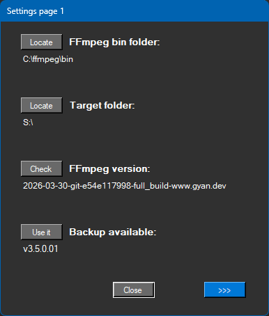

    A new issue. I just updated both clever and ffmpeg... When I try to cut a mkv file [I don't see any option other than keyframe] as I have done many times, now when I go to preview the latest cut, the video playback goes to the end of the file and not to the cut. I tried it on 3 different files with similar results. The cut file is at the cut, but the preview is as I said. The indexing seems to be taking much longer too.
    Windows 11 system

    Thx for the hint, you are right, the preview is broken.
    I've fixed this now, please update.
    Btw: The indexing has'nt changed. The key accurate cut is available for avc (h264) and hevc (h265) videos only.

    Updated and working beautifully again. Thanks
