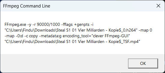

    - You also see a debug/cmd window when you click Yes for a corrected copy of the raw file. portable.config is still set to <cmd_l>0</cmd_l>
    [Attachment 90974 - Click to enlarge]
    Oh, I forgot this test-message. Will remove it.

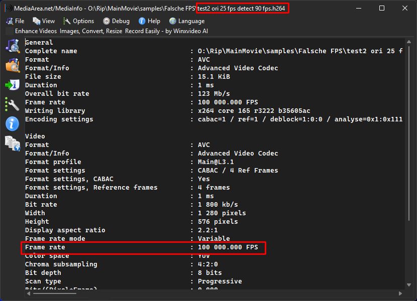

    Your sample test2 ori 25 fps detect 90 fps.h264
    Detected with 90fps (wrong) but the mediainfo is:
    [Attachment 90981 - Click to enlarge]
    This sample is defective.

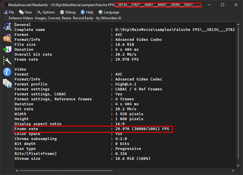

    Your sample __38134___27827___38081___36947___29289___35821_-__34987___26102___38388___36951___24536___30340-ori 23_976 fps detect 29_97 fps.h264
    Detected with 29.97 fps (correct). His mediainfo:
    [Attachment 90982 - Click to enlarge]

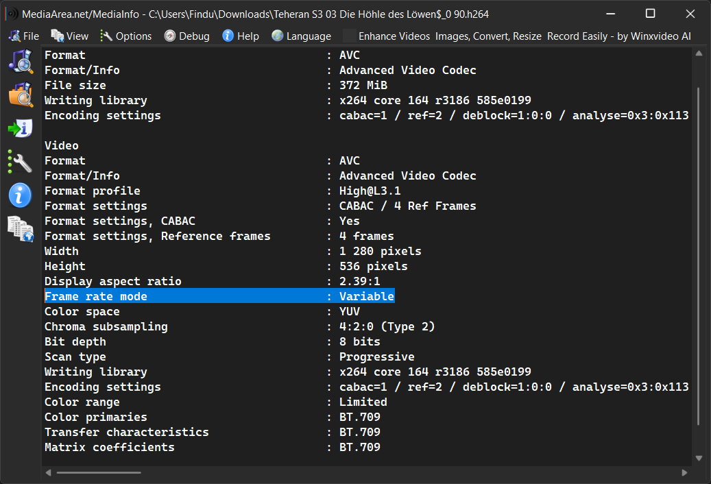

    Sorry, I found the problem with the short sample (test2 ori 25 fps detect 90 fps.h264).
    As the raw files have more than 500 MB, I cut one and used the cut to extract the short raw stream.
    And that produce the high value for, Frame rate : 120 000.000 FPS

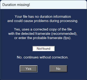

  8. @ProWo
    3.5.1.02 feedback
    When a raw stream does not have a fps entry, "Not found fps" is displayed, but when you mux it, 90 fps is still used, which causes playback issues.
    Would it make sense to add the fps value of the video stream to the name of the extracted raw stream?
    So if you have trouble detecting the fps of the raw file (variable), you could use this value.
    That would be better than 90 fps.
  9. Strange!
    When I extract the video stream of that file:
    General
    Complete name : C:\Users\Findu\rawtest5.mp4

    The raw stream has this metadata:
    General
    Complete name : C:\Users\Findu\rawtest5.und$_0.h264
    Format : AVC
    File size : 304 MiB
    Writing library : x264 core 165 r3222 b35605ac
    Encoding settings : cabac=1 / ref=1 / deblock=1:0:0 / analyse=0x1:0x111 / me=hex / subme=2 / psy=1 / psy_rd=1.00:0.00 / mixed_ref=0 / me_range=16 / chroma_me=1 / trellis=0 / 8x8dct=0 / cqm=0 / deadzone=21,11 / fast_pskip=1 / chroma_qp_offset=0 / threads=17 / lookahead_threads=4 / sliced_threads=0 / nr=0 / decimate=1 / interlaced=0 / bluray_compat=0 / constrained_intra=0 / bframes=3 / b_pyramid=2 / b_adapt=1 / b_bias=0 / direct=1 / weightb=1 / open_gop=0 / weightp=1 / keyint=240 / keyint_min=24 / scenecut=40 / intra_refresh=0 / rc_lookahead=10 / rc=2pass / mbtree=1 / bitrate=1800 / ratetol=1.0 / qcomp=0.60 / qpmin=0 / qpmax=69 / qpstep=4 / cplxblur=20.0 / qblur=0.5 / vbv_maxrate=14000 / vbv_bufsize=14000 / nal_hrd=none / filler=0 / ip_ratio=1.40 / aq=1:1.00
    Video
    Format : AVC
    Format profile : Main@L3.1
    Format settings : CABAC / 4 Ref Frames
    Format settings, CABAC : Yes
    Format settings, Reference frames : 4 frames
    Bit rate : 1 800 kb/s
    Width : 1 280 pixels
    Height : 536 pixels
    Display aspect ratio : 2.39:1
    Frame rate mode : Variable
    Color space : YUV
    Chroma subsampling : 4:2:0
    Bit depth : 8 bits
    Scan type : Progressive
    Color range : Limited
    Color primaries : BT.709
    Transfer characteristics : BT.709
    Matrix coefficients : BT.709
  10. Originally Posted by Findu View Post
    Muxing a video without a frame rate can only cause problems.
    With such an uncorrected raw video, I will disable all actions except recoding.
    Seems to be a good idea.
    This is to be expected, as an h264 raw stream has no time information and usually no frame rate either.
    Therefore, in the absence of accurate data, MediaInfo displays a variable frame rate.

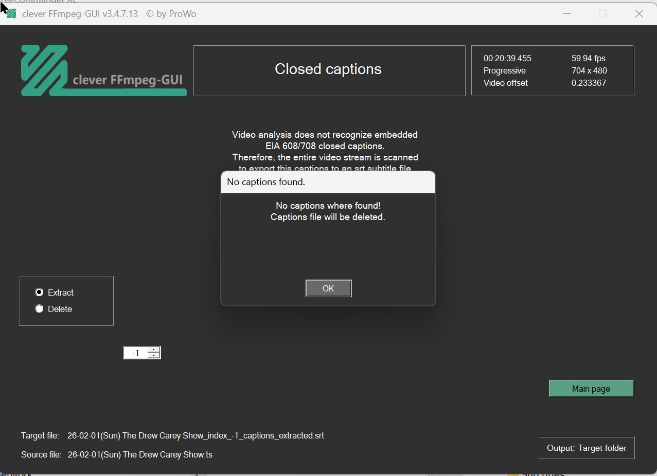

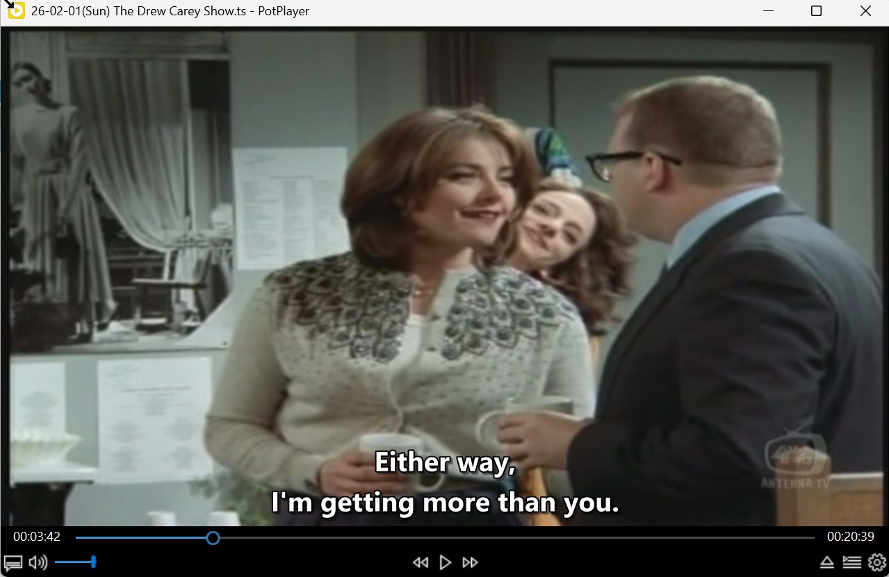

  14. Clever could not find caption for a .ts file that has caption
    [Attachment 91090 - Click to enlarge]
    .TS video plays with caption
    [Attachment 91091 - Click to enlarge]

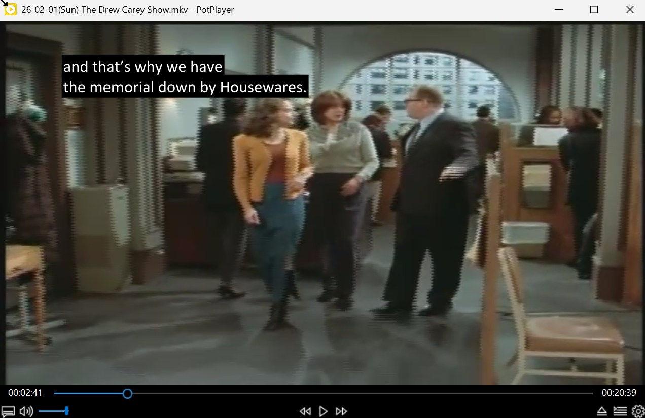

    Handbrake found the caption and encode. Here is the mkv file encoded from the above .ts file
    [Attachment 91092 - Click to enlarge]
    I tried ffmpeg directly and got the same result: no caption.
    ffmpeg -f lavfi -i "movie=x.ts[out+subcc]" -map 0:0 -c text "x.srt"
    So this is no fault of ProWo. It's just a flaw of ffmpeg. How does Handbrake do it?
    Even when ffmpeg extracts a cc file, the result is often inconsistent. That's why I have to use ccextractor for the best result.
  15. Originally Posted by davidt1 View Post
    Have you tried all three options (Index, -1 / 0 / 1)?
    [Attachment 91093 - Click to enlarge]
  16. Originally Posted by ProWo View Post
    No I did not.

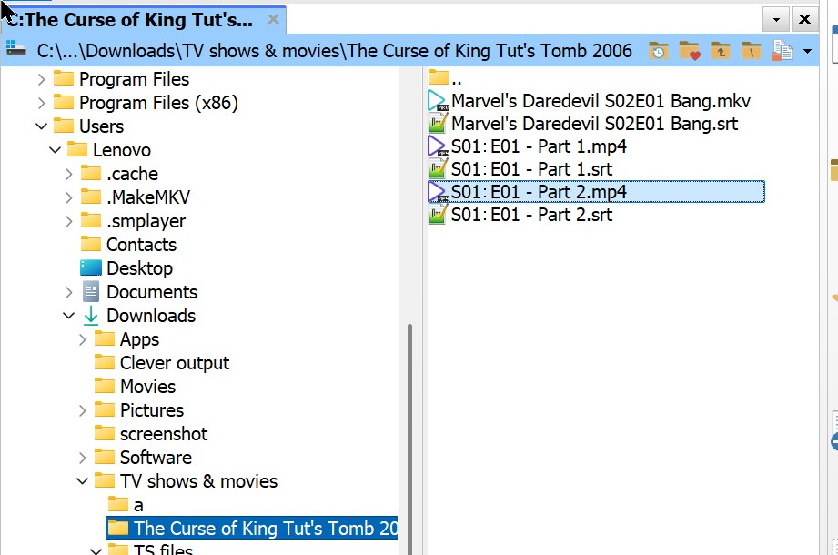

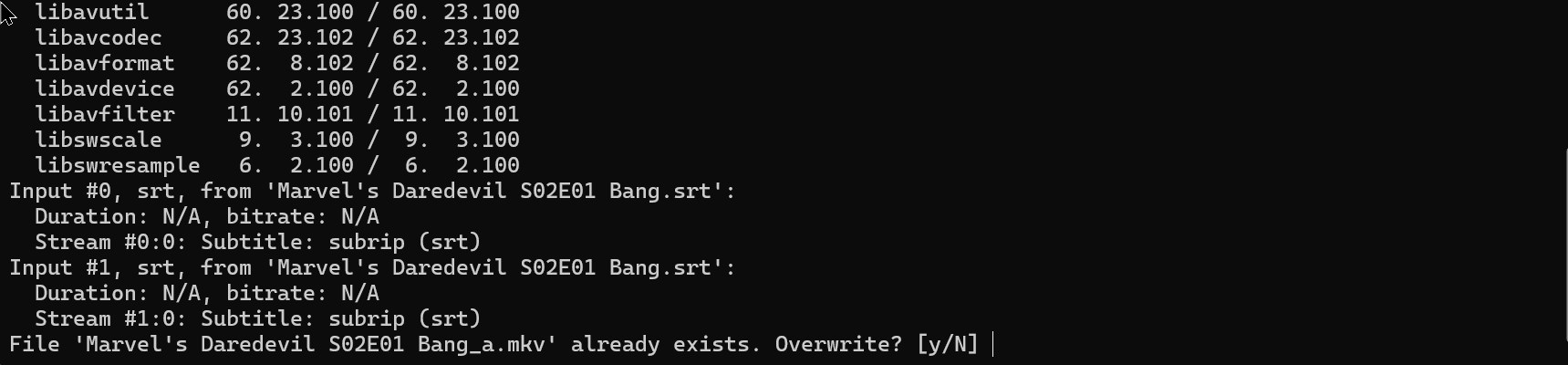

  17. Can someone help me, please?
    I need to mux 1 subtitle to 1 video in a folder with files with the extensions .mp4 and .mkv. The little script below works, but it also wants to mux the subtitle file to itself.
    1. It correctly muxes the first video file to the first subtitle.
    2. Now it wants to mux the subtitle file to itself. It asks, the file already exists, do you want to write over it?
    If I click no, it skips this step. If I click yes, it will replace the newly muxed file with this new file which gibberish.
    The script should mux all files without asking anything.
    The script:
    FOR %F IN (*.*) DO ffmpeg -i "%F" -i "%~nF.srt" -map 0 -map 1 -c:v copy -c:a copy -c:0 srt -metadata:0 language=eng -disposition:0 default -max_interleave_delta 0 "%~nF_a.mkv"
    Files to mux
    [Attachment 91126 - Click to enlarge]
    ffmpeg wants to mux the subtitle file to itself
    [Attachment 91127 - Click to enlarge]
    I think my script is needs work. Please help. Thank you.
  18. I found the answer. Instead of (*.*), I need to use (*.mkv *.mp4).
    But it still kills me that I don't know why (*.*) does not work correctly.
  19. Originally Posted by davidt1 View Post
    Because *.* takes all files as input, including srt files.
  20. Thank you, ProWo.
    I found a solution. I need to map the first input streams specifically: -map 0:v -map 0:a works. Before it was: -map 0
    I still don't understand it, but at least now everything is muxed smoothly.
  21. Originally Posted by davidt1 View Post
    -map 0 = all streams from the first input file.
  22. Originally Posted by ProWo View Post
    Thank you.
    What I meant to say is: I don't understand why -map 0:v -map 0:a works with (*.*) whereas -map:0 does not.
  23. Originally Posted by davidt1 View Post
    Because *.* takes all files as input (the subtitle srt files too)
    with srt as input 0 and
    you mux srt with srt.
    With srt as input 0 and
    -i "%F" -i "%~nF.srt -map 0:v -map 0:a -map 1
    nothing is taken from input 0 (because you mapped video and audiostreams only).

  25. Originally Posted by ProWo View Post
    You add the fps value of the video stream to the name of the extracted raw stream. Thank you very much.
    Would it be possible to automatically insert this value into the "Duration missing" window and replace it with the text "Not found"?
    [Attachment 91282 - Click to enlarge]
    That would be easier than entering 23.976.
    The fps value in this field is ignored anyway if you select NO in this dialog box. In that case, an entry would not be a problem.
    However, this is not important, as raw streams are probably rarely used.

  29. Anyone here uses Potplayer?
    On my AMD laptop it plays tp files recorded from the Comet TV station with audio only and no video. The files play with both audio and video in VLC, MPV, and MPC-HT.
    I can't figure out the problem. Thanks
  30. Originally Posted by davidt1 View Post
    Video codec not supported in Potplayer?
