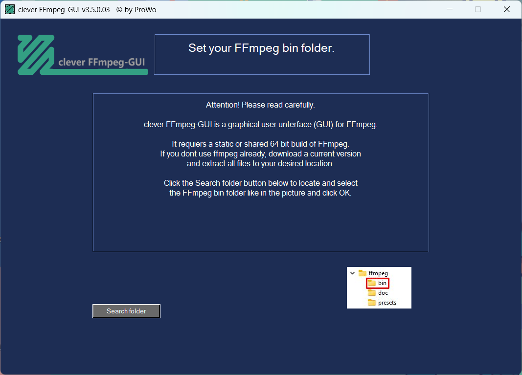

  12. @ProWo
    If you delete or rename the ffmpeg folder and start the app, this window will appear, but the link to ffmpeg is missing like at first start of the app.
    [Attachment 90738 - Click to enlarge]
  13. Originally Posted by Findu View Post
    Thx, will be fixed.

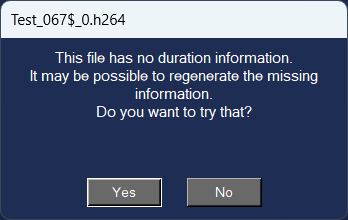

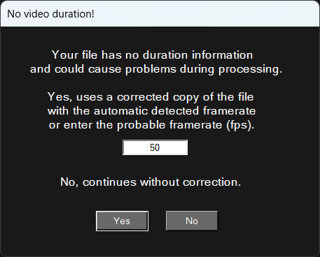

    When you open a raw video stream at the Main page, you get these two windows:
    [Attachment 90887 - Click to enlarge]
    [Attachment 90888 - Click to enlarge]
    Would it make sense to combine these two windows into one?
    When you add a raw video stream on the Mux page, you get this window:
    [Attachment 90889 - Click to enlarge]
    Would it make sense to ask for the probable frame rate here as well?
    How about this text change on the Main page?
    "A brief description (enable or disable this info in the settings):"
    This way, the text "Ripping unprotected DVDs is also implemented." could be moved to a separate line.
  22. Originally Posted by Findu View Post
    No, because you can also reject the automatic correction.
    No. Automatic correction (where the file is copied) is not possible during muxing.
    The message only serves to enable muxing in the mp4 container to restore the duration information.
    Restoration at this stage may also be incorrect.

  23. When you open a raw video stream at the Main page, you get these two windows:
    Ah, okay.

  26. How about that combination of raw window 1 & 2?
    [Attachment 90897 - Click to enlarge]
    Here the text:
    Your file has no duration information
    and could cause problems during processing.
    Yes, uses a corrected copy of the file
    with the automatic detected framerate
    or enter the probable framerate (fps).
    No, continues without correction.
    BTW. If you enter high numbers or characters in the second window, the automatically recognized value for fps will be used anyway.

  28. Originally Posted by Findu View Post
    Thx, will be done.
