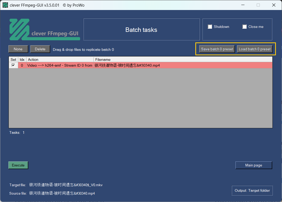

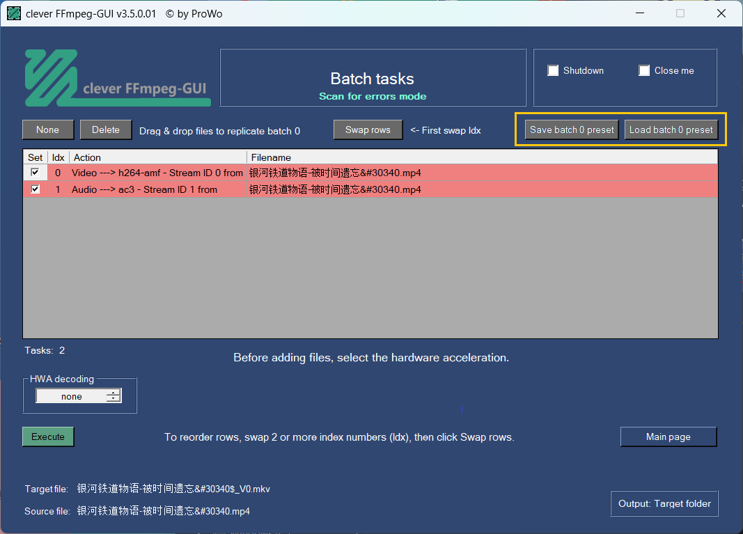

  7. @ProWo
    Idea for presets.
    If you want to use the same video values for resize, brightness, contrast, pixel format, and encoder settings at once over and over again, you could use a batch task for this.
    With replicate batch 0, you can apply the settings to other added media files.
    If you could now save this batch 0 task under a separate name and reload it, you would essentially have presets.
    Of course, the save and load function only applies to batch 0.

  9. Originally Posted by tb52 View Post
    Sooo...
    Go through the process of setting up a file to convert to something else and send it to the batch.
    If batch 0 exists, you can drag other files into and the commandline from batch 0 is replicated to this files.
  10. Originally Posted by Findu View Post
    I don't think such an option is meanful, because settings like brightness, gamna, contrast are specific for a given video and cannot be used for anothet one.

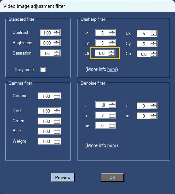

  12. Question: Don't you set your values for brightness, contrast, saturation and gamma, check what it looks like with the (live) preview button, repeat this (change & inspect) until the settings are right, and only then leave the window for video image adjustment filters?
  13. @ProWo
    The marked box is 2 pixels further to the left than the others.
    [Attachment 90634 - Click to enlarge]
  14. Originally Posted by Findu View Post
    I need to make a sample to inspect. That's outside the adjustments panel. When I do that and go back into that panel, all the values are reset to default. It's only a few numbers and not a big deal. My 'workflow' might be different than others as I'm new to working even this closely with FFMpeg.
  15. Originally Posted by tb52 View Post
    OK, I understand.
    I'll use another approach: The last used settings are saved, with a message that you're usings modified values, and a reset button.
