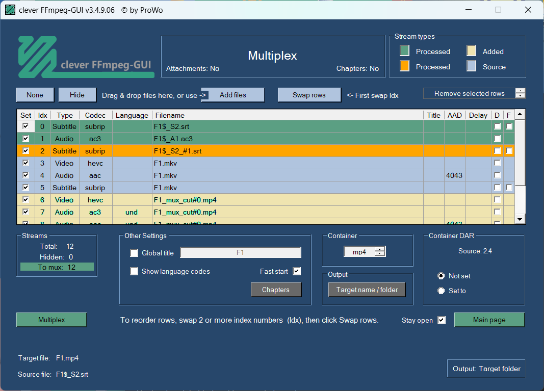

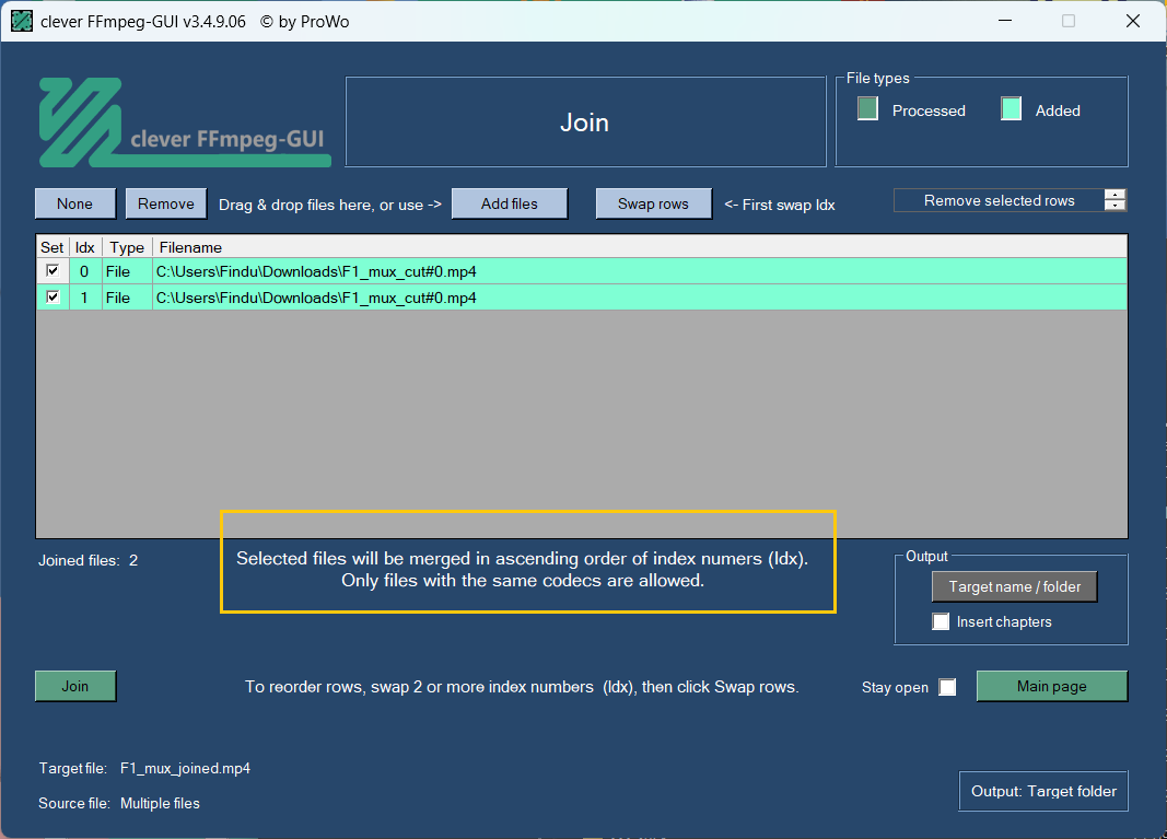

  1. @ ProWo
    3.4.9.06 feedback
    Thanks for the 06 update.
    If you remove the word "use", the text will also fit with Windows desktop scaling set to 125% and 150%.
    There are two spaces in the lower sentence at all pages.
    [Attachment 90145 - Click to enlarge]
    EDIT: Alternatively, you could reduce the width of the "Add files" and "Swap rows" buttons.
    [Attachment 90147 - Click to enlarge]
    Can you also add the selected text to the blank join page? Since you can add multiple files, you see that you can select them in the correct order before adding them.
    [Attachment 90146 - Click to enlarge]
  2. Originally Posted by Findu View Post
    Will be fixed.
    I'll change the color of processed rows too, because they are too similar to those of added streams/files.

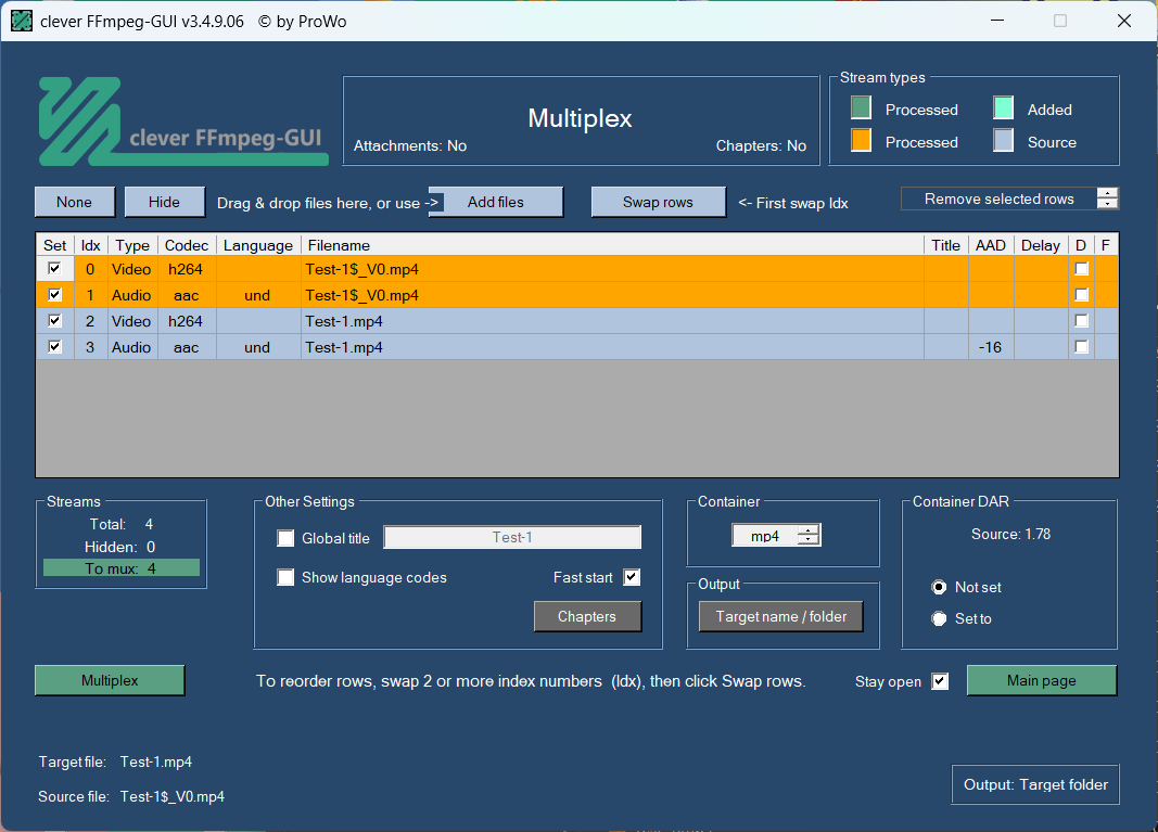

  3. @ ProWo
    Colors:
    The processed green and source blue are also used for the buttons.
    So how about changing the added color to yellow?
    [Attachment 90156 - Click to enlarge]
    Funny!
    When you click Toggel color, the button is transparent or uses the actual background color. When you open another page and return, the button is gray.
    But with the background color, the white text on the normally gray buttons is easy to read.

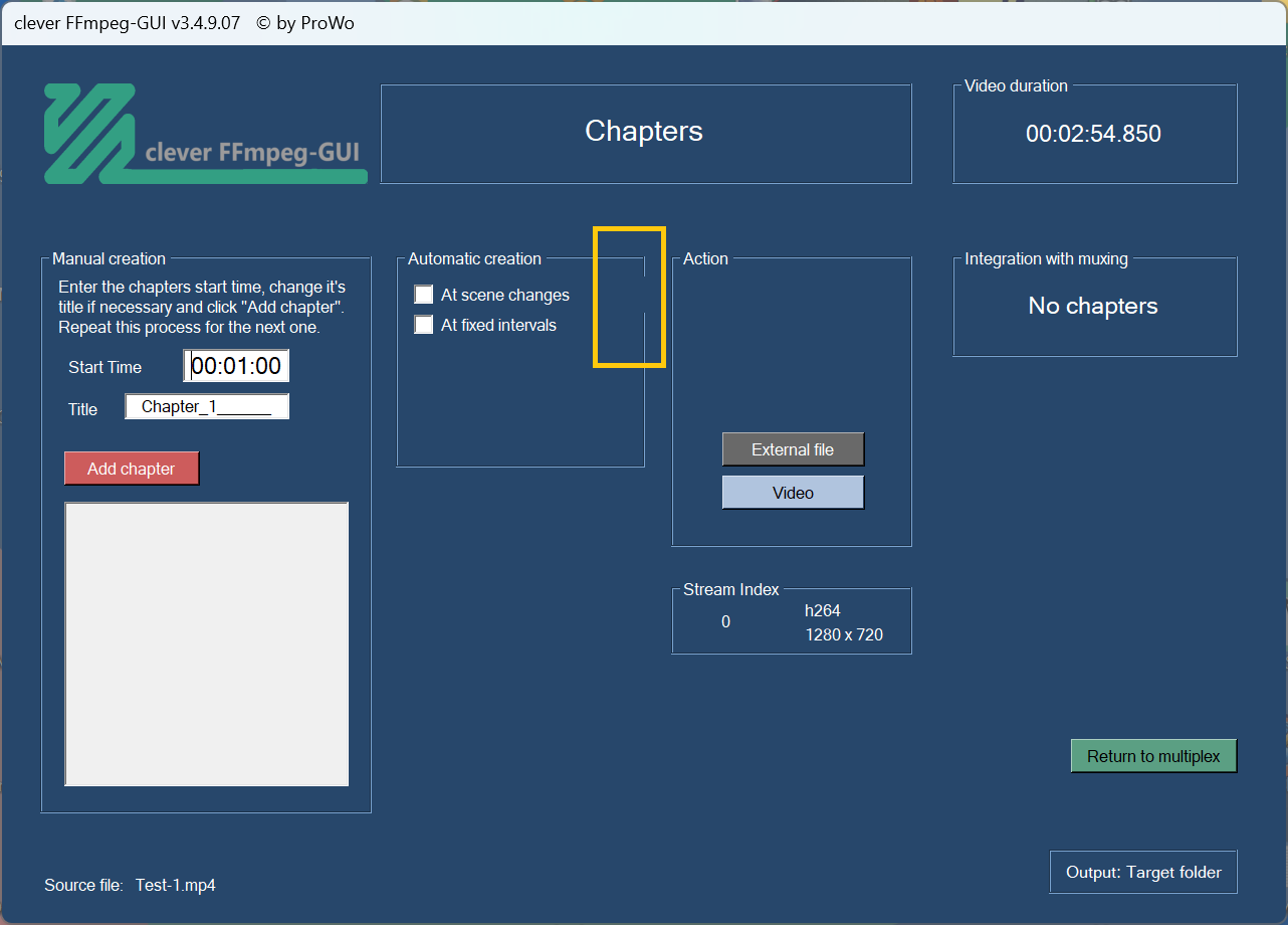

    Could this be an option in the settings to use transparency for the gray buttons?
    [Attachment 90157 - Click to enlarge]
  4. Tried to join some tp files, but no output file was produced even though Clever says "Success"

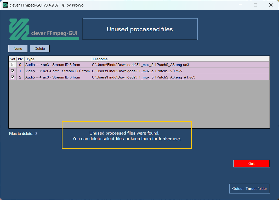

  21. 3.4.9.07 feedback
    As always. Thanks for the last fixes and text changes.
    The check to convert/join unknown extensions to mkv. is working.
    The sort function for the Filename column at the Join page also works.
    "All Streams" as batch task now work as expected.
    What I discoverd:
    When you select Close me, the app remains on the Unused processed files page and does not close.
    When you reopen the app with a SWF_open.txt, the corresponding source file is missing. Would'nt it make sense to reload it as well as you can easily load a new one, because you might not remember the corresponding source file location?
    How about that text change?

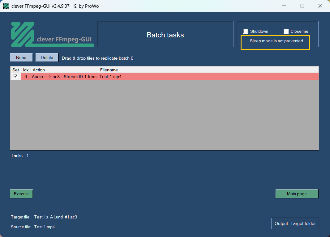

    [Attachment 90189 - Click to enlarge]
    And how about that text change? Or do we need that text here at all, when all works as normal?
    [Attachment 90190 - Click to enlarge]

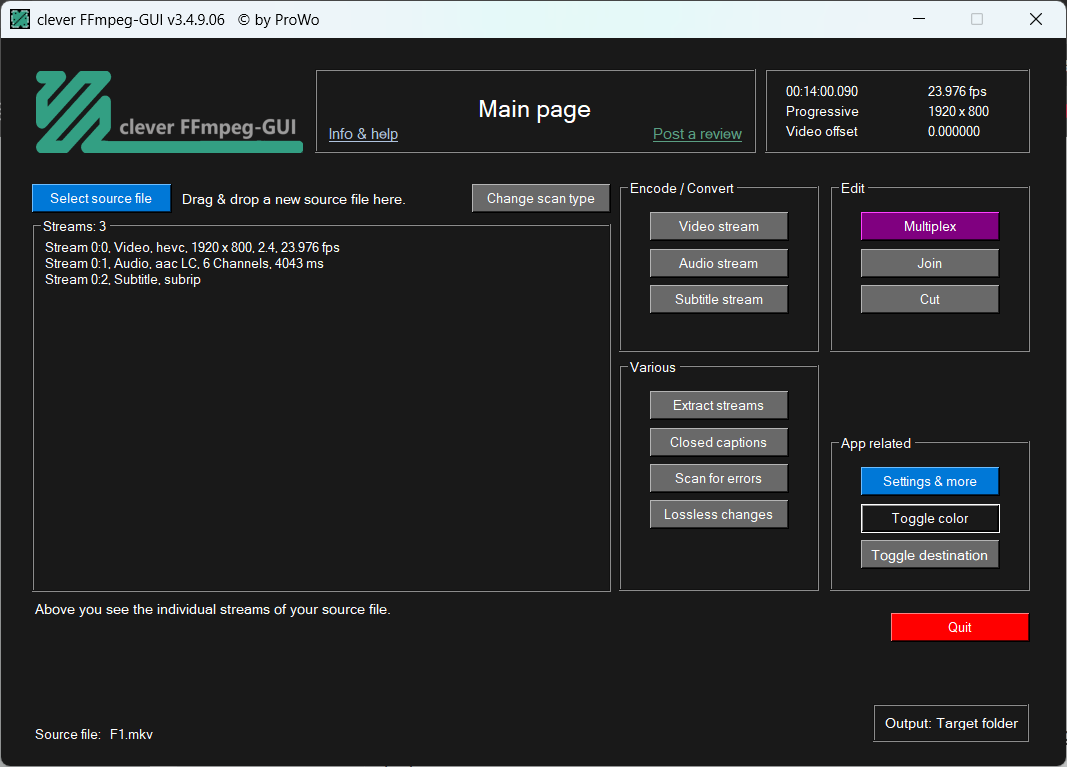

  22. The Toggel color button now keep the actual background color.
    The idea for improving the readability of the grey buttons was to use this for all gray buttons in the app, with a checkbox for use in the settings.
    Currently grey
    [Attachment 90195 - Click to enlarge]
    New with the same background
    [Attachment 90196 - Click to enlarge]
  23. Originally Posted by Findu View Post
    What I discoverd:
    Bug, will be changed.
    That is not the purpose of the file; it is only there to make previously unused processed files available.
    Will be done.
    No, in this case I'll hide it.
  24. Originally Posted by Findu View Post
    No, I'll leave it with the gray buttons, except the Toggle color button.

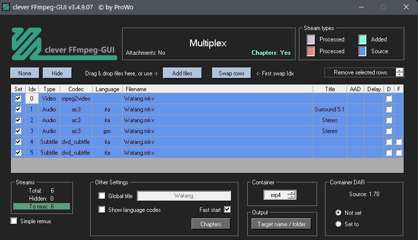

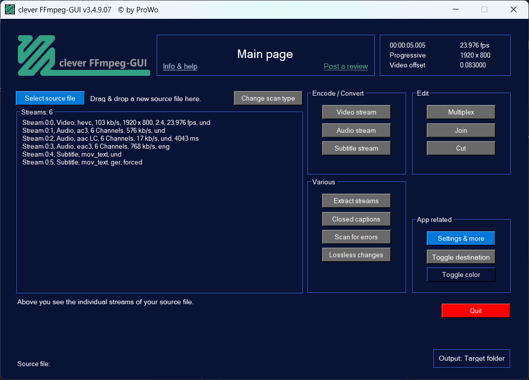

  25. @ProWo
    3.4.9.07 feedback
    It would display better if foreground font color was white instead of black
    for this specific grid color theme.
    [Attachment 90197 - Click to enlarge]
  26. Originally Posted by videoAI View Post
    I've tested white foreground, but it looks better (and is better readable) with black foreground.
  27. @ProWo
