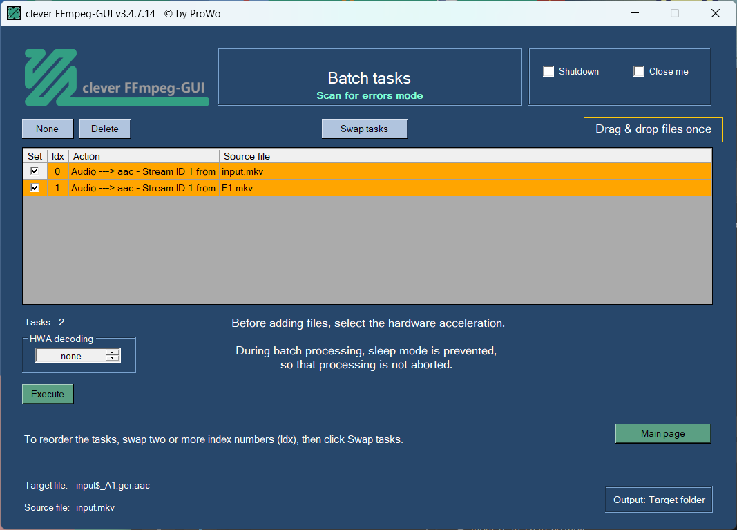

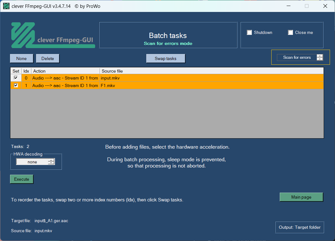

  1. @ ProWo
    How about displaying "Drag & drop files once" as log as "Scan for errors mode" get displayed?
    So you know that this special mode will end after the first drop.
    [Attachment 89906 - Click to enlarge]
    Or could scan for errors always use batch mode?
    When you click Scan for errors on the Main page, the source file is automatically added to the grid without using HWA-decoding and all possible other batch tasks are automatically unchecked. So you can execute just the source file scan with the next click, as before.
    What if you could switch between "Batch tasks" including replication of batch 0, and "Scan for errors" mode which opens the HWA-decoding option but without replication of batch 0.
    [Attachment 89907 - Click to enlarge]

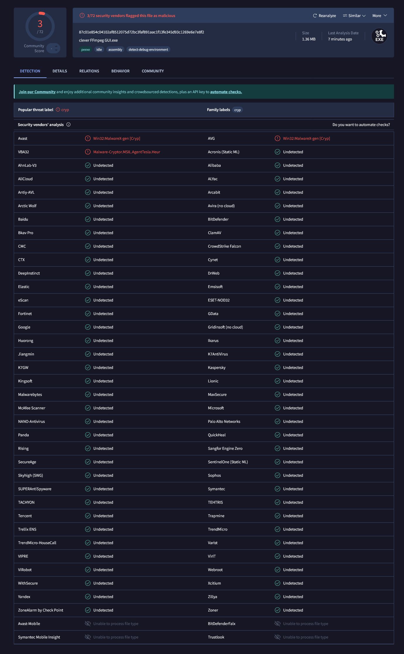

    -bsf:a aac_adtstoasc ^
    -avoid_negative_ts make_zero ^
    -fflags +bitexact ^
    output.mp4
  3. Originally Posted by Findu View Post
    It doesn't end after the first drop.
    Yes, of course, if there's a scan for errors task and you swap it to position 0.
    Only if you click the To batch button; therefore, I will remove this button here.
    This is already possible with the batch 0 replication.

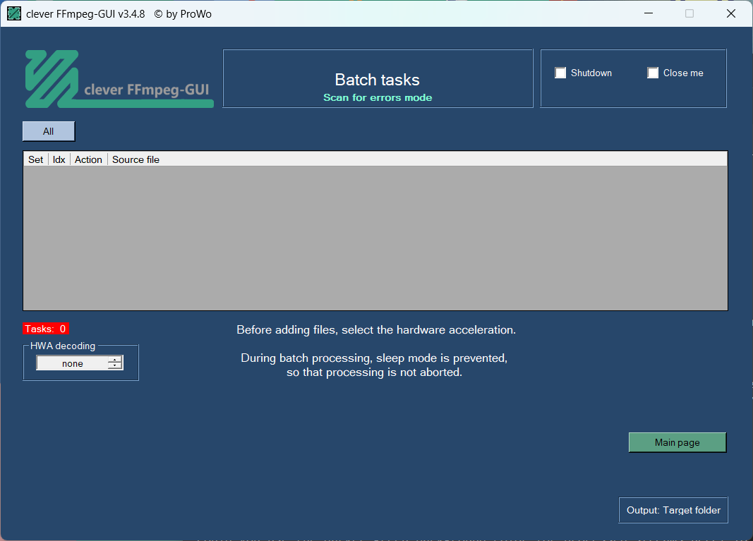

  5. @ ProWo
    v3.4.8 feedback, Scan for errors mode
    You are right, if the grid is empty or as long as idx 0 is a scan for errors (sfe) task.
    But if idx 0 is a normal batch tasks, sfe mode end after the first drop.
    The same applies when you swap idx 0 from sfe to a normal task.
    To display "Drag & drop files to replicare Batch 0" during sfe mode is not entirely correct, as you can still change the HWA-decoding before the drop. So better use "Drag & drop files".
    EDIT:
    When you click Batch scan on the sfe page and the grid is empty, "Drag & drop ..." is missing. It appears after the first drop.
    EDIT 2:

  6. Originally Posted by Findu View Post
    I disagree because the action is replicated. The fact that you can also change the HWA is just a bonus. If you don't change it, batch0 will be fully replicated.
    I will add this info when the grid is empty.

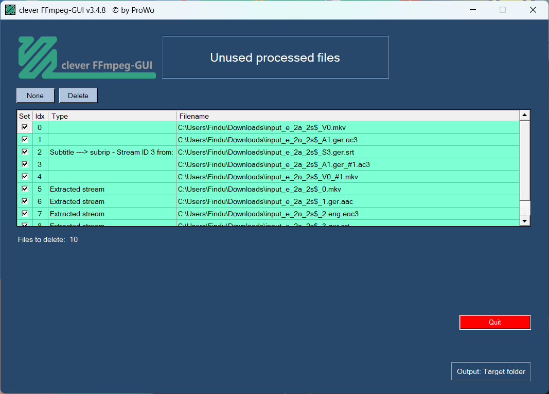

  7. @ ProWo
    v3.4.8 feedback
    The type is not displayed for processed video and audio streams.
    Could you use the darker green background color for processed streams here? To stick with the usual colors.
    [Attachment 89917 - Click to enlarge]
  8. Originally Posted by Findu View Post
    Bug, will be fixed.
    Good idea. Will be done.

  11. @ ProWo
    The All button is displayed on the empty Batch tasks page (scan for errors mode).
    In this case, only the Add files button is displayed at the top of the empty grid on the Join and Mux page.
    I'm not sure if the Add files button is useful for batch tasks.
    [Attachment 89919 - Click to enlarge]

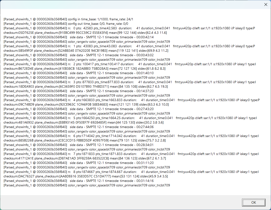

    Sometimes this info window appears at the end of using At scene changes:
    [Attachment 89933 - Click to enlarge]

    and yes I do see
    also at scene changes.

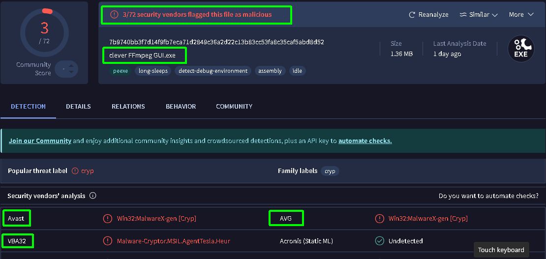

  20. @ProWo
    v3.4.8 feedback
    My comments about Clever false positives ..
    User, from review]All previous versions prior to 3.48 no problems downloading & running the program.
    This is not accurate, prior to v3.4.8, Clever had one false positive (VBA32) on Google's virus total site.
    I pointed it out in one of my previous posts and even joked about it.
    Suddenly Norton Ant-virus detects Threat Name Win32:MalawareX-gen[Cryp] Threat type Cryptic -
    This threat is heavily disguised to hide its malicious intentions?
    There are now 4 antivirus programs (Norton, Avast, AVG, VBA32) who claim malicious intent and 3 of them
    specify one exact threat type by name [Win32:MalawareX-gen[Cryp]].
    Although I still believe those are all false positives;
    1- The increase in the number of detections, now 4 [one by Norton, 3 by virus total]
    2- The identification of one type of threat Win32:MalawareX-gen[Cryp] by, at least, 3 major reputable
    antivirus vendors [Norton, Avast, AVG]
    3- And coming close to crossing the virus total threshold of 4. Most users start to have second thoughts
    if the detection level reaches or exceeds 4/71
    should warrant some questions like ..
    1- Was there a major change in code that increased the detection level? encryption? System DLLs calls, etc.
    2- Could there be a real infection that slipped detection on the Dev system? An actual virus?
    3- Can anything be done to reduce the detections? code change, letters to virus total or antivirus vendors, etc.
    clever FFmpeg-GUI, is 100% virus/malware free. Your AV is wrong, false alarm.
    To simply brush this off as the fault of the user's AV program may not be very helpful.
    Note: I might write a small post about false positives and their impact on the availability of free software later, stay tuned.
    [Attachment 89934 - Click to enlarge]

  24. Originally Posted by videoAI View Post
    Then see here:
    [Attachment 89937 - Click to enlarge]
  25. But aren't you a bit curious why Norton, Avast, and AVG are flagging your app as malicious ?
    Then see here:
  26. Originally Posted by videoAI View Post
    I have no idea; the internet is full of false virus warnings concerning Visual Studio compiled executables.

    Wrong transfere to the empty Join page does not occur here.
    But the "Drag & drop ..." text is still missing on the empty Batch tasks page (scan for errors mode).
