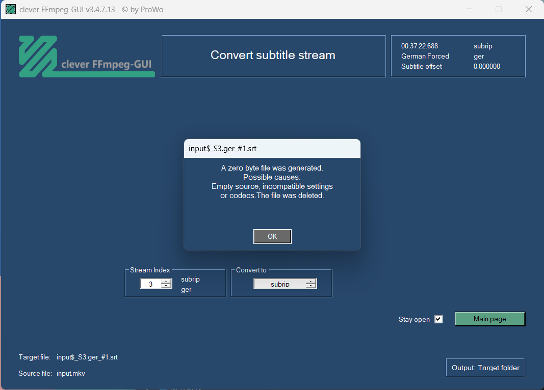

  7. @ ProWo
    v3.4.7.13 feedback
    You can not use "To batch" at the Convert subtitle stream page any longer, cause of the new zero byte file check.
    [Attachment 89853 - Click to enlarge]
    When you cut, it could happen that a sub stream does not have any content any longer. Could such empty streams cause problems at later usage?
    Could the "Convert to" selection store its setting?
    As I remember, we had that in the past.

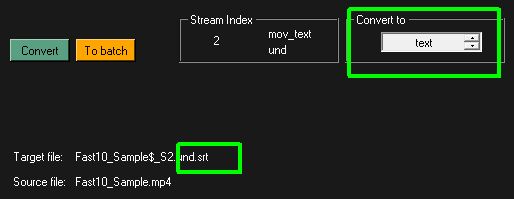

    Please fix the bug in 3.4.7.13,On muxing .mp4 to mkv with subs in clever.. the output mkv contains two lines subs (small and big .srt) but when muxing with mkvtool nix gui it's perfect with sub .srt all in big which is genuine.
    Test > Fast10_Sample
    Files attached herewith > https://limewire.com/d/JxJwb#2sUrDZ5q5e

  9. Originally Posted by sam12345 View Post
    Where can you see:
    1) two lines subs (small and big .srt)
    2) with sub .srt all in big
    Who says that's genuine?
  10. Originally Posted by Findu View Post
    Should be fixed now.
    No. If you g.e. want to convert this empty subtitle stream, you'll get the zero file message. That's all.
  11. Originally Posted by ProWo View Post
    Where can you see:
    @ProWo
    It's 100% genuine. Enclosing live coverage for you. Why would I unnecessary disturb you ? See yourself !
    https://limewire.com/d/qdEG6#ayXB8sNzQG
  12. [QUOTE=sam12345;2786993][QUOTE=ProWo;2786986]
    Tested, no issue.
    It's your player to show this difference.
    Check with vlc or another player.
  13. [QUOTE=ProWo;2787000][QUOTE=sam12345;2786993]
    Tested, no issue.
    Ofcource it's the player. Changed the player to potplayer and mkv file is playing well with subs. Happens somtimes

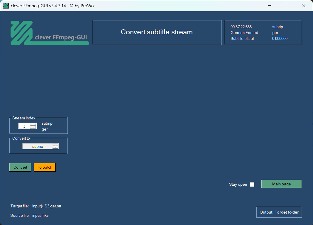

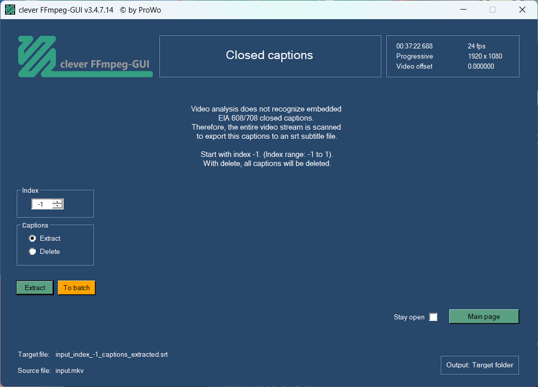

    Proposal for Closed captions and Convert subtitle stream:
    [Attachment 89876 - Click to enlarge]
    [Attachment 89877 - Click to enlarge]

  21. Originally Posted by Findu View Post
    Will be done.
    Cannot be done, because the "Stream index" groupbox cannot be moved.

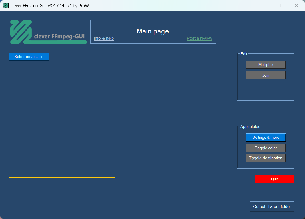

  23. @ ProWo
    Thanks for the info!

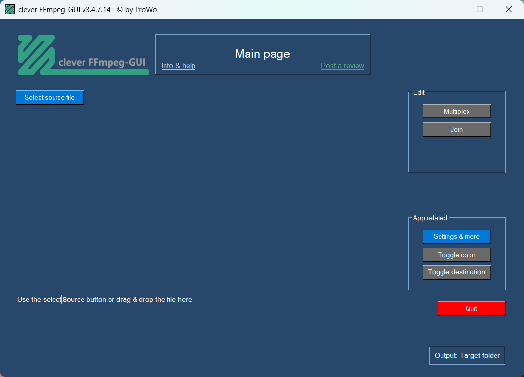

    By the way, when you open the app and click Select source button and Abort, then the lower text is missing.
    [Attachment 89882 - Click to enlarge]
    Two additional text changes:
    [Attachment 89883 - Click to enlarge]
    EDIT: Error! Select should be capitalized, not source.
    [Attachment 89884 - Click to enlarge]
