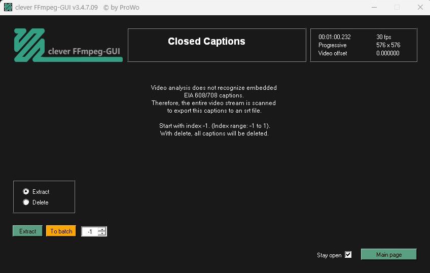

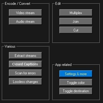

  1. @ProWo
    v3.4.7.09
    How about a minor name change, from 'EIA 608/708' [very technical]
    to 'Closed Captions' as shown ..
    [Attachment 89734 - Click to enlarge]
    [Attachment 89735 - Click to enlarge]

  4. Originally Posted by videoAI View Post
    Will be done.

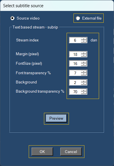

  6. @ ProWo
    v3.4.7.09 feedback, burned-in subtitles, cosmetic changes
    Thank you for adding the preview for burned-in subtitles. It works well and is indeed useful for adjustments.
    I didn't know that it also include background transparency, which also works.
    But that text is quiet long and close to the drop down, so all drop-downs could be moved 10 pixels to the right.
    And "External File" and the round selector could also move 15 pixels to the right.
    The text position on the "Select" button for external files is two pixels too high.
    How about swapping the text for the external file and the preview button and centering both?
    The two buttons at the bottom are also not centered.
    Here are two images of the possible changes:
    [Attachment 89739 - Click to enlarge]
    [Attachment 89740 - Click to enlarge]
  7. Originally Posted by Findu View Post
    Will be done.
    No, that seem so, because the button is selected.
    Centering OK, but swap is not possible.
    Will be changed.
  8. Oh great, thanks!

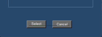

    If you look closely, you can see that the word “Select” is positioned two pixels higher than “Close.”
    [Attachment 89741 - Click to enlarge]

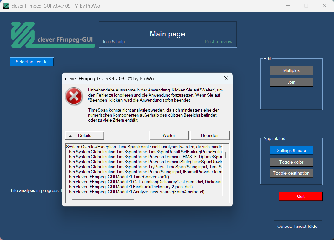

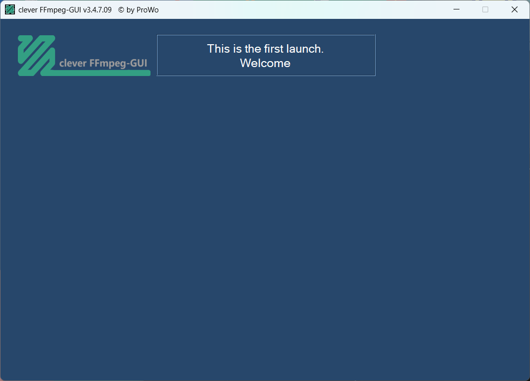

  9. You cannot open videos that are longer than 24 hours.
    If you click “Next” on the error message, the welcome page appears in front of the main page.
    EDIT:
    Clicking on X on the welcome scree closes the app. The configuration is not damaged either. The app can then be EDIT2 "started" as normal.
    So it's a very rare problem!
    [Attachment 89742 - Click to enlarge]
    [Attachment 89743 - Click to enlarge]
    System.OverflowException: TimeSpan konnte nicht analysiert werden, da sich mindestens eine der numerischen Komponenten außerhalb des gültigen Bereichs befindet oder zu viele Ziffern enthält.
    bei System.Globalization.TimeSpanParse.TimeSpanResult. SetFailure(ParseFailureKind failure, String failureMessageID, Object failureMessageFormatArgument, String failureArgumentName)
    bei System.Globalization.TimeSpanParse.ProcessTerminal _HMS_F_D(TimeSpanRawInfo& raw, TimeSpanStandardStyles style, TimeSpanResult& result)
    bei System.Globalization.TimeSpanParse.ProcessTerminal State(TimeSpanRawInfo& raw, TimeSpanStandardStyles style, TimeSpanResult& result)
    bei System.Globalization.TimeSpanParse.TryParseTimeSpa n(String input, TimeSpanStandardStyles style, IFormatProvider formatProvider, TimeSpanResult& result)
    bei System.Globalization.TimeSpanParse.Parse(String input, IFormatProvider formatProvider)
    bei clever_FFmpeg_GUI.Module1.TimeConversion1()
    bei clever_FFmpeg_GUI.Module1.Get_duration(Dictionary` 2 stream_dict, Dictionary`2 format)
    bei clever_FFmpeg_GUI.Module1.Findtrack(Dictionary`2 json_dict)
    bei clever_FFmpeg_GUI.Module1.Analyze_new_source(Form& msbx_cf)
    bei clever_FFmpeg_GUI.Form1.Show_Tracks()
    bei clever_FFmpeg_GUI.Form1.New_inputfile()
    bei clever_FFmpeg_GUI.Form1.Form1_Load(Object sender, EventArgs e)
    bei System.Windows.Forms.Form.OnLoad(EventArgs e)
    bei System.Windows.Forms.Form.OnCreateControl()
    bei System.Windows.Forms.Control.CreateControl(Boolean fIgnoreVisible)
    bei System.Windows.Forms.Control.CreateControl()
    bei System.Windows.Forms.Control.WmShowWindow(Message& m)
    bei System.Windows.Forms.Control.WndProc(Message& m)
    bei System.Windows.Forms.Form.WmShowWindow(Message& m)
    bei System.Windows.Forms.NativeWindow.Callback(IntPtr hWnd, Int32 msg, IntPtr wparam, IntPtr lparam)

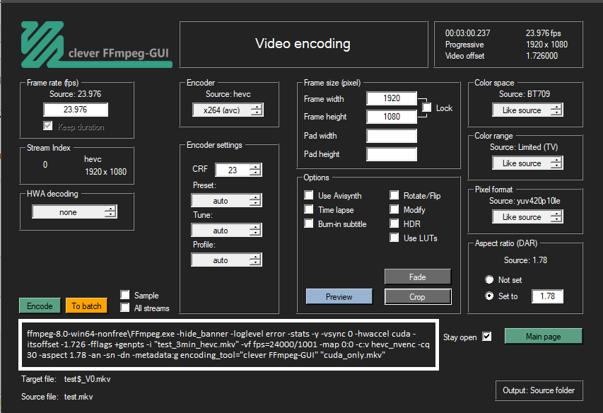

    I think it would be great if this could simply appear under all the main action buttons like Encode, Extract, Scan, Cut, etc. There’s already some empty space there, and it would be a perfect place to display the ffmpeg command. It would also make learning ffmpeg a lot easier while experimenting with different options.
    Maybe you could even add a small “Copy Command” button, so users can copy the ffmpeg command without having to manually select the whole text.
    You could also include options for this in Clever’s settings menu, so everyone can customize it the way they prefer. For example:
    FFmpeg Command Display Options
    • Always show ffmpeg command under the command button
    • Show only when hovering over the command button
    • Don’t show by default, but allow right-clicking the command button to copy the command
    [Attachment 89753 - Click to enlarge]

  26. @ ProWo
    v3.4.7.11 feedback
    Strange behavior at video encoding:
    It appears that if the resolution of the source video is not one of those supported by DNxHD and you switch to DNxHR, the settings for “Profile” and its drop-down menu are missing. However, if your encoder is already set to DNxHR and you open video encoding, the settings are displayed.
    EDIT: Sometimes the DNxHR settings disappear when you switch to DNxHD and then back.
    Video encoding, Options, "Modify" doesn't say much, so perhaps use "Modify image" or "Video image", because "Image adjustment" is too long.
    Burned-in subtitle:
    Why do we need the values for Background 0, 1, 2?
    You get the same results using only Background transparency between 0 - 100% (0 = 100%, 1 = 0%, 2 = 1-99%).
    Why not using "Font size (pixel)" instead of "FontSize (pixel)"?
    The text on the “Select” button is positioned two pixels higher than “Cancel”. It is the same when the button is selected.
  27. Originally Posted by Findu View Post
    Thx, bug, will be fixed.
    Will change it to "Adjustment".
    Burned-in subtitle:
    0 (no background) and 1 (full black) are ffmpegs standard options. I'll leave it this way.
    A typo, will be fixed.
    Will be fixed.

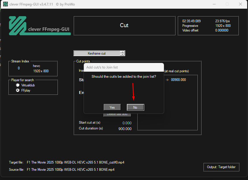

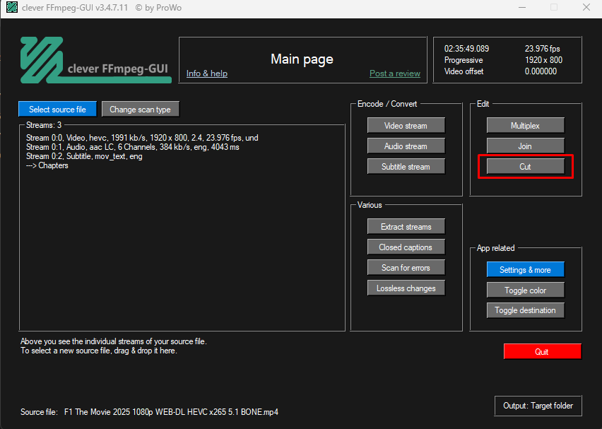

  30. @ProWo
    Noticed a stange bug in 3.4.7.11, it was not there before. when i cut the video with option "should the cut's be added to join list > NO" ; it's not honoring it.
    [Attachment 89776 - Click to enlarge]
    [Attachment 89777 - Click to enlarge]
