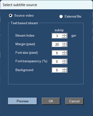

    I think it would make sense to add a preview button to the "Burn-in subtitle" window to test the settings. Currently, all settings are reset when you reopen the window because something wasn't right.
    It could look like this:
    [Attachment 89693 - Click to enlarge]
  8. Originally Posted by Findu View Post
    I think it would make sense to add a preview button to the "Burn-in subtitle" window to adjust the settings.
    Subtitle mux cannot be previewed with ffmpeg.

  13. @ ProWo
    Yes, of course!
    This is about Video Encoding, Burn-in Subtitle. There you can check and display it.

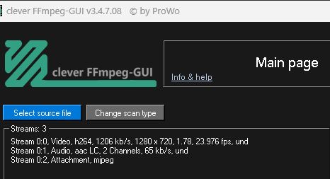

  20. @ProWo
    v3.4.7.08
    Is this really the best way to handle mjpeg attachments?
    [Attachment 89714 - Click to enlarge]
    this is the source file ..
    [Attachment 89715 - Click to enlarge]

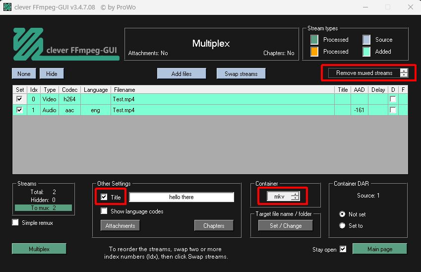

  21. @ProWo
    v3.4.7.08
    Please allow the ability to set defaults for these 3 settings:
    1- After Mux Action [Dropdown Selection]
    2- Title [Checkmark]
    3- Container [Type]
    and have them [always] remembered.
    [Attachment 89716 - Click to enlarge]

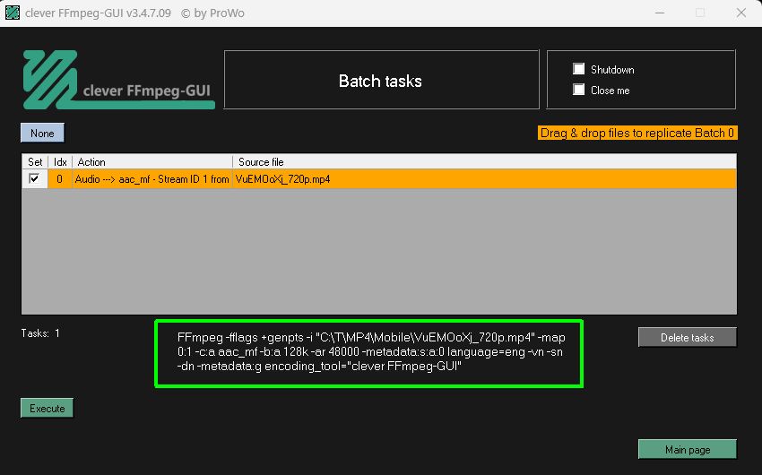

    Feature Request
    I am sure this requested feature will be very useful and very popular.
    How about adding a 'copy to clipboard' when right-clicking on action
    column in batch tasks grid.
    This should allow the ffmpeg command, previewed via hover, to be
    copied to the clipboard.
    P.s. What will make this new feature even more useful is adding the
    output file name to the generated ffmpeg command as well.
    Adding this feature will let Clever compete with many other ffmpeg
    GUIs who have already added similar features [to copy, or input
    ffmpeg commands]
    Kindly consider adding
    [Attachment 89733 - Click to enlarge]
