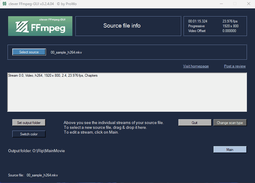

  21. Hi Prowo
    Thanks for adding the loop filters.
    I am not able to use it
    ERROR:
    Error initialising the muxer for deblock=-1,-1:no-sao=1_primaries:invalid argument
    The process works fine if I remove the new No sao and deblock add ins
    What am I doing wrong?

    Does not happen here.
    Maybe an old ffmpeg version?
    [Attachment 77542 - Click to enlarge]
  23. Hi Prowo
    am using ffmpeg v 6.1.1
    will check if there is newer. Which version did you use?
  24. The latest nightly
