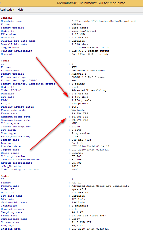

    sorry but the source is already low bitrate and also variable frame rate. no matter what you try it won't get to be "high quality". the best you can do is just put it into an mkv container if that's what is needed and at least it won't get worse...
    [Attachment 52494 - Click to enlarge]
