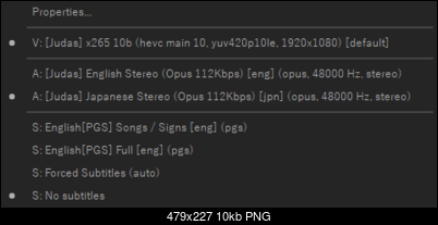

  1. I have the audio set up correctly to make play Japanese first then English.
    All I want to do is set it up in advance to make it play the second subtitle, not the first one.
    It is like this:
    I want it to select "S: English[PGS] Full[eng] (pgs)". How would I do that? I am also using KMPlayer 64X.
    Thanks!

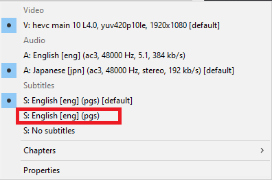

  8. Hi,
    How about this?
    How can I set the next subtitles other than the default one?
    [Attachment 54243 - Click to enlarge]
