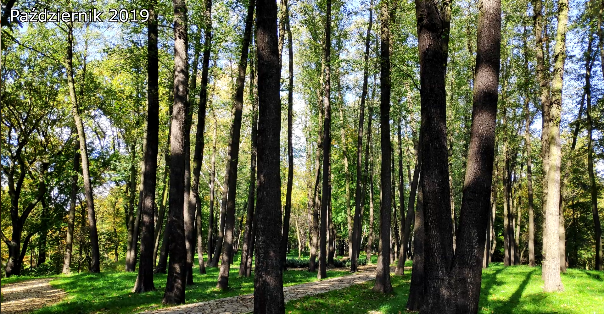

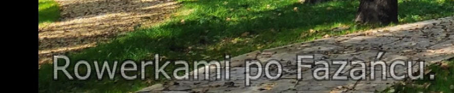

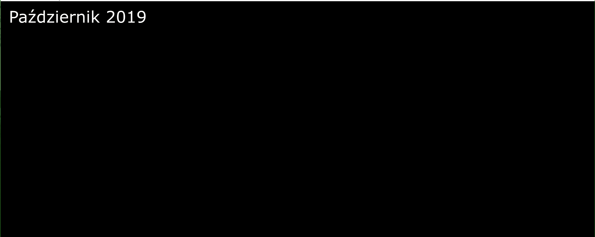

    recently I rendered vacation film, but strangely it has some weird artifacts while playback.
    They are visible while transiting from one pic to another (they are zooming on each photo), but only on 3 spots. I tried to re-render it, but still the same. So I took this vid and playback it on other PC, and there was none of them. So I just removed all codecs and reinstalled MPC-HC, but artifacts were still visible. I compared versions of mpc-hc and windows, and they are exactly the same.
    Screenshots attached.
    01-several frames are visible like that, then 02 -> and after that video is okay.

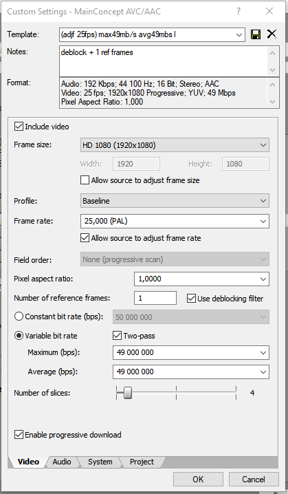

  16. 16 reference frames and 8 bframes is probably what's screwing up your playback. Many hardware decoders don't support that. Step back to level 4.1. With 4 reference frames, 3 bframes.
  17. I just set render that high because I do not want to have any compression blocks on video. But sure, I will try it.
Name:	render settings.PNG
  18. I also recommend you blur the source image a bit to reduce aliasing artifacts, strobing, etc. Try using x264's slow preset. That should give you video that will play on pretty much all devices.

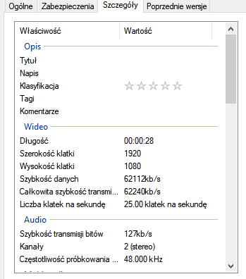

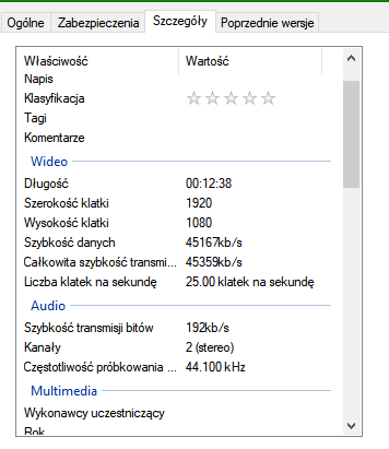

    My pc:
    AMD fx-8320, 24gb ram ddr3, gtx1070, rendering on SSD.
    And for previous questions:
    This is your render? Please provide some of the actual camera source also
    Yes it is actual few seconds render of whole 13 minutes vid.
    Stats attached
    Will try to do it!
Name:	vid stats.PNG
    Image Attached Images
  23. Member DB83's Avatar
    Jul 2007
    Hmmn. But the above properties bear no resemblance bitrate-wise to the sample you provided. Pretty difficult to form a valid opinion then.

  28. I did the playback via VLC with settings you mentioned and I recorded this via Screen To Gif so you can see that artefacts still appears.
    I will try to rerender project with x264, could not do it yesterday.

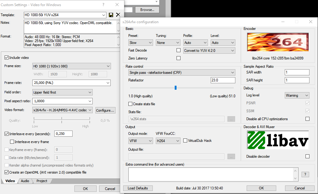

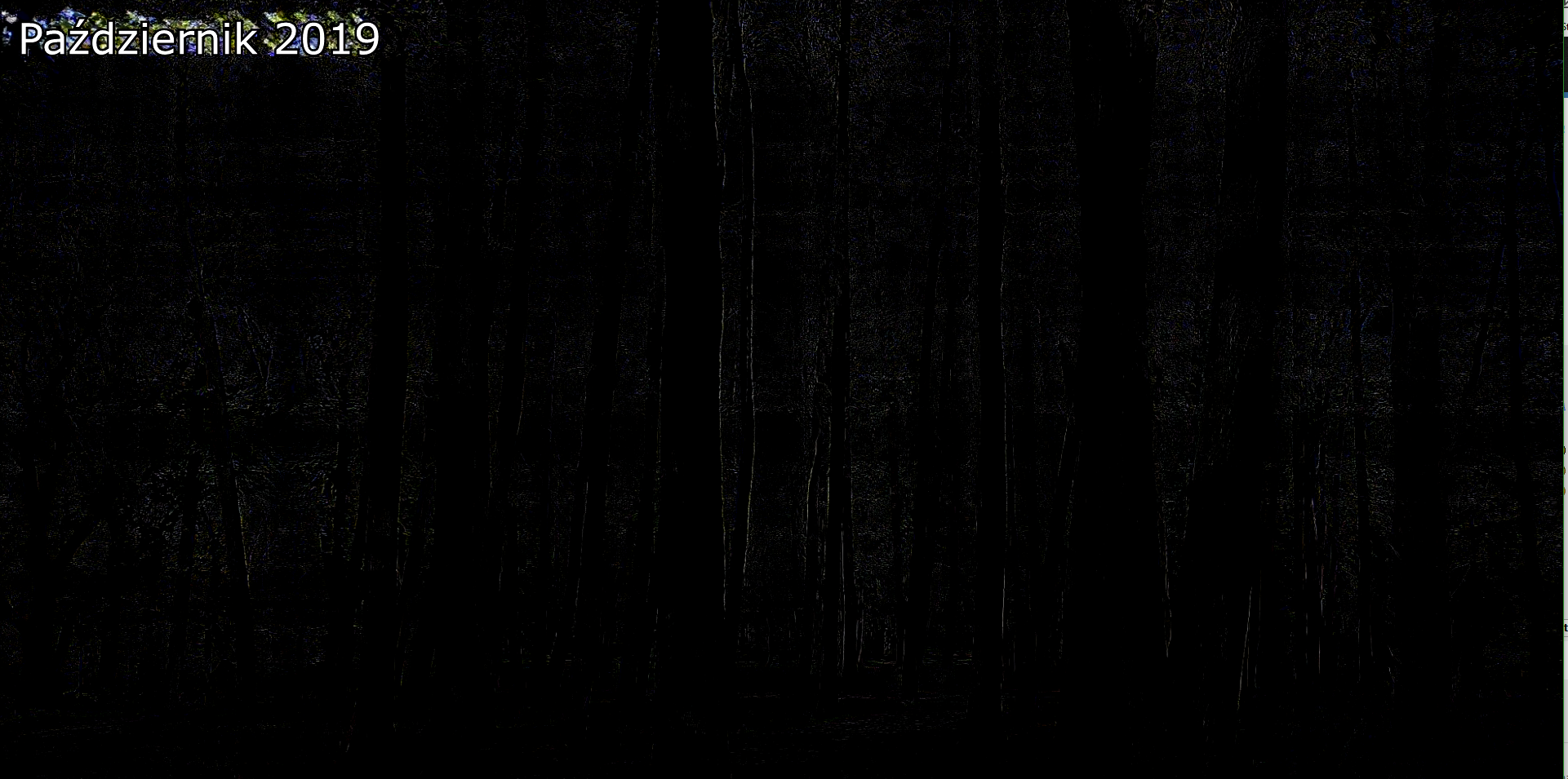

  30. I did render with attached settings, everything is almost okay. I see some interlace across whole video but mostly visible while transitioning between scenes. Is there something I can change to get rid of it?
