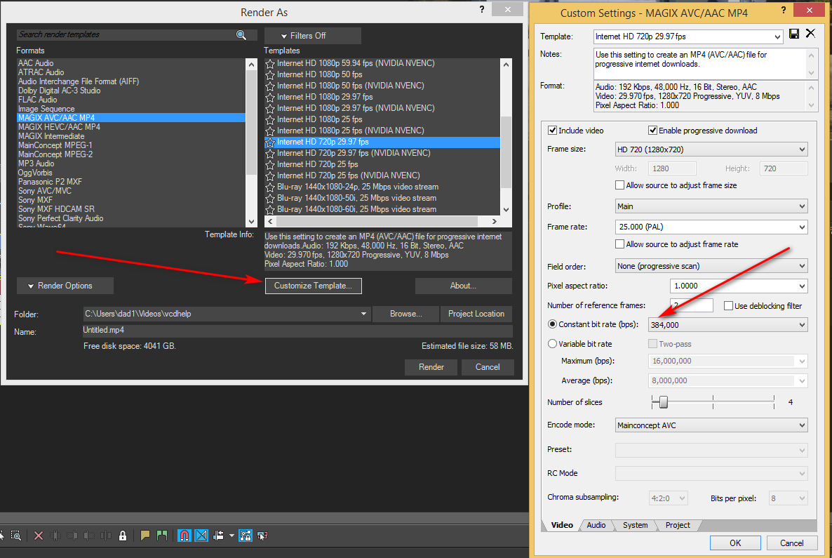

    don't change the fps or audio. change the bitrate the encoder uses. filesize = bitrate x time. there are online bitrate calculators you can use. https://www.3ivx.com/support/calculator/index.html
    [Attachment 52470 - Click to enlarge]

    it was as simple as you said. I Changed the Bitrate and now have a Video with 96MB and the same Quality as the original.. Thanks a lot!

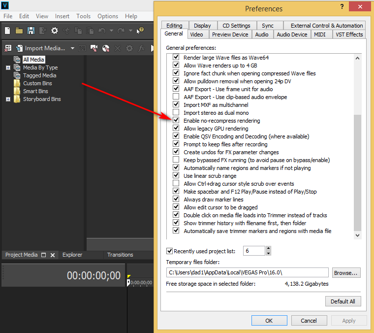

    Not for specific encoders but this has to be enabled
    Options => Preferences => General Tab => Checkmark Enable no-recompress rendering => hit apply
    Years ago and hopefully that feature was not broken - it was automatic if you had DV video loaded and encoding same DV format, DV template, same with HDV video and maybe some other video camcorder formats, not sure. Or sometimes even DVD mpeg worked, where simple VOB loaded for encoding was rendered with mainconcept template without re-encoding, I had to read a value in mediainfo and set bitrate for the same value and of course all values had to match. But in most cases doing this with mpeg2 file would not work anyway.
    It worked / works for certain formats like XDCAM, DV, DVCPROHD ,certain types of AVCHD, certain types of MPEG2, some lossless I-frame VFW video formats (e.g .UT Video)

    ??? smart rendering is still a part of vegas pro as of version 16(i use it)
    [Attachment 52482 - Click to enlarge]
