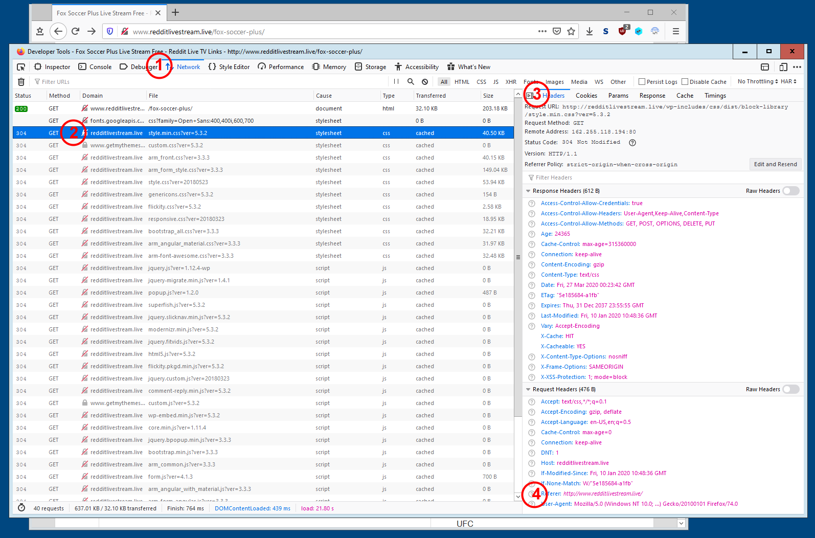

    Can you take a screenshot of where the referer field is in Firefox? I can not find it in the "Network" tab of the developer tools.
    Thank you.
  15. The stream isn't working now but the general procedure is to start developer tools in a browser (usually F12). Go to the Network tab (1), find the m3u8 url (you might have to refresh the page and/or start playing the video to see the url) and left click on it (2). In the details pane make sure the Headers tab is selected (3). In the Request Header pane you can see the Referer field (4):
    [Attachment 52481 - Click to enlarge]
    Since the stream wasn't working I just selected a random item for that image.
