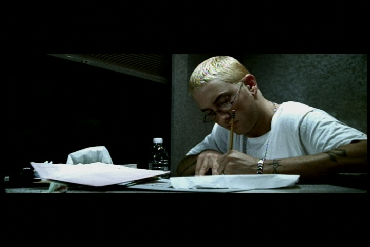

Below is a screenshot of a music video which I am trying to restore.
[Attachment 52421 - Click to enlarge]
As you can see, it has rain-bowing and dot crawl.
I have tried pretty much every plugin. Either they do nothing at all or they cause a significant loss of detail.
Does anyone has a script or plugin that can remove it while keeping as much detail as possible?
Sample attached below if you wish to do some experimenting.

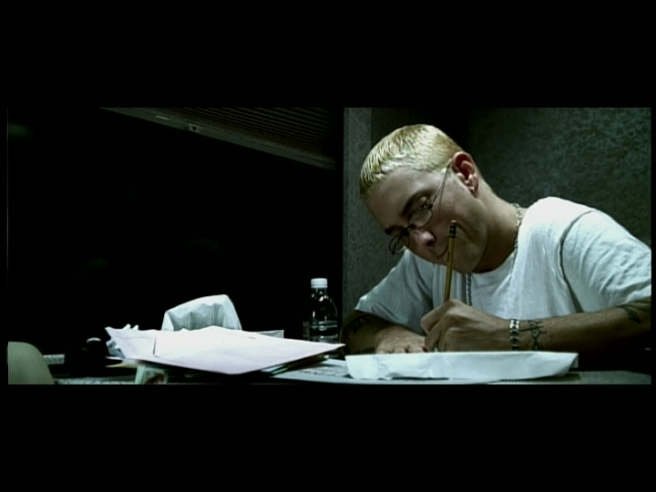

I think I have a pretty acceptable result now. It seems every filter in this script effects the dot crawl to some degree lol. TemporalDegrain2 surprisingly does a number on it. For future viewers, here is my script:
Code:MPEG2Source("1.d2v", Info=3) ColorMatrix(hints=true, dest=0, interlaced=true) checkmate() DeDot(luma2d=20, lumaT=20, chromaT1=0, chromaT2=255) tfm(mode=4) tdecimate() vinverse() BicubicResize(720,540) TemporalDegrain2() sharpen(.2)
[Attachment 52432 - Click to enlarge]
The rainbow is still there but its not as distracting as the dot crawl.Last edited by embis2003; 23rd Mar 2020 at 10:44.

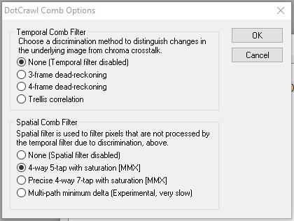

Hmm …, I am getting the artefacts in vdub with the dotcrawl.vdf filter as well for the part with high motion, but much less so with the temporal filter disabled. At the end one would have to pick what looks best in realtime playback scenarios.
[Attachment 52434 - Click to enlarge]
Or importing the dotcrawl.vdf in avisynth:
Code:LoadVirtualdubPlugin("dotcrawl.vdf","taco_dotcrawl") ...your source filter… AssumeTFF() converttoRGB32().taco_dotcrawl().converttoYV12() tfm(mode=4).tdecimate()Last edited by Sharc; 28th Mar 2020 at 03:02. Reason: importing in avisynth added
