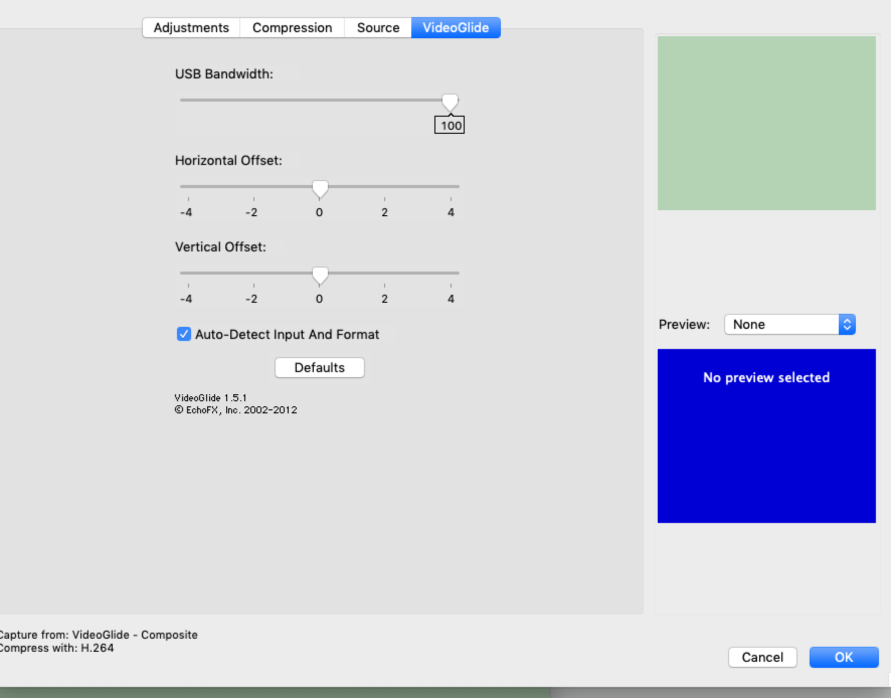

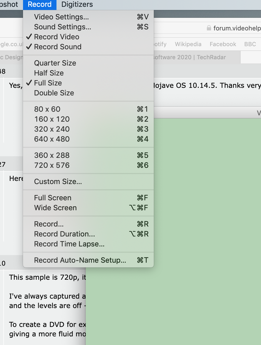

    Recently, I have captured a load of .mov files using EZGrabber VideoGlide Capture 1.5.1 (developed by www.echofx.com) software from my Hi8 tapes, via my Sony CCD TR920e 1997 video camera. I have no point of reference as to whether the quality of the captured film is poor ok, good or excellent, as I have not done this before. I am also, like so many other users of this forum, a novice of the tech and am in need of guidance. I have posed the question once before as to the basic settings I need to apply in the Video Glide Capture software, to give a good quality base from which I can then generate clips, stitch clips together, make clips in different formats etc. I am a stills photographer principally, having used high end slrs and dslrs for 35 years, shooting for picture library stock. I have taken Hi8 video over the years for fun, with out too much thought as to the post processing element.

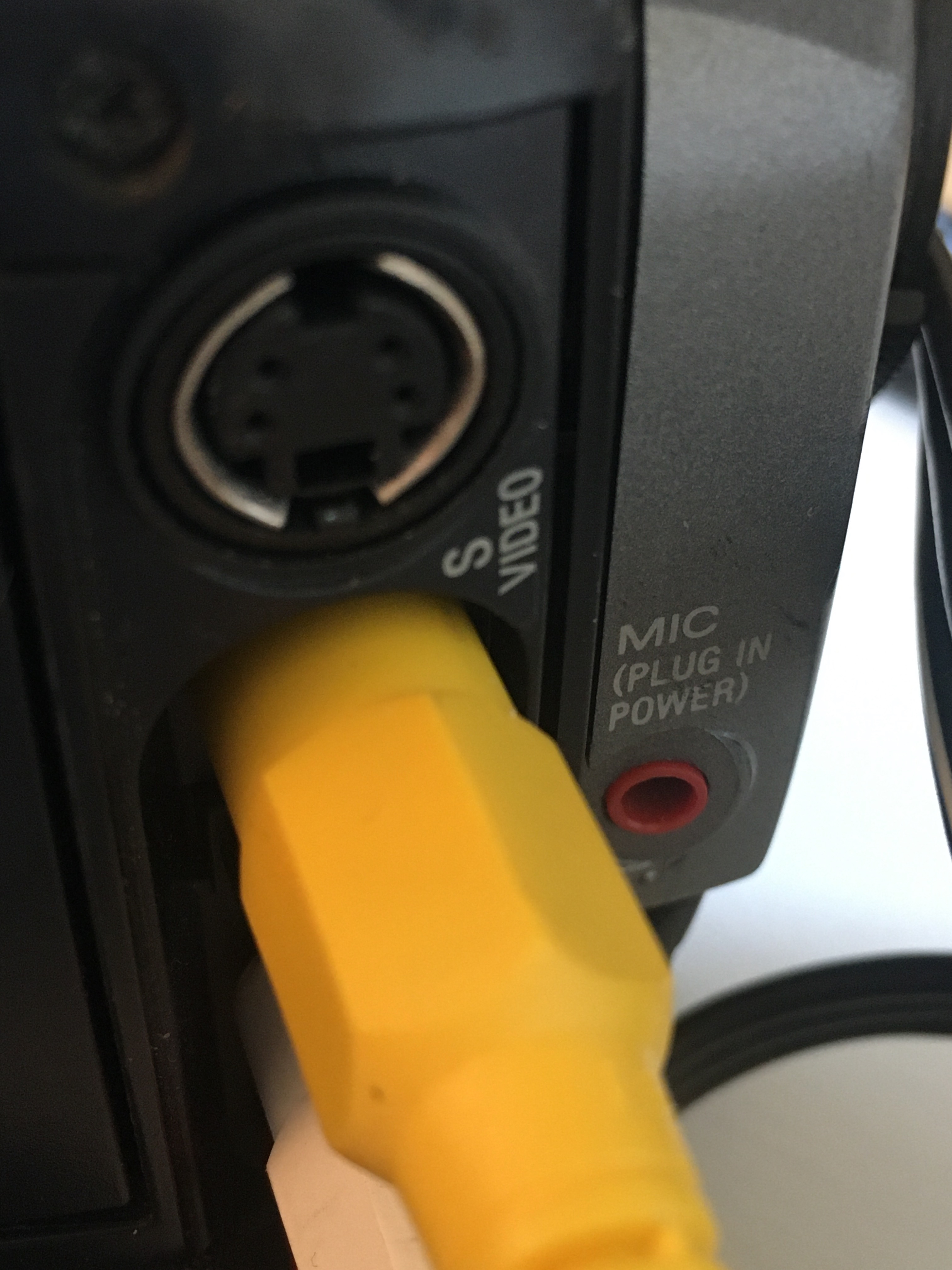

    The video camera has a an S-video slot, but I don't have an S-video plug or lead to connect it to the VideoCapture dongle, relying solely on the White, Yellow and Red cables. The results so far are IMO rather poor, grainy, blurry, unsharp, and peppered with what I understand to be the effects of de-interlacing, ie lots of tiny lines around the edges of content. As far as I can see there is no option in the 'settings' of the software, to either interlace or de-interlace, so I'm guessing the software is doing automatically. I have attached screen shots of settings that I have used,Image
    [Attachment 52390 - Click to enlarge]
    for information.
    Mar 2008

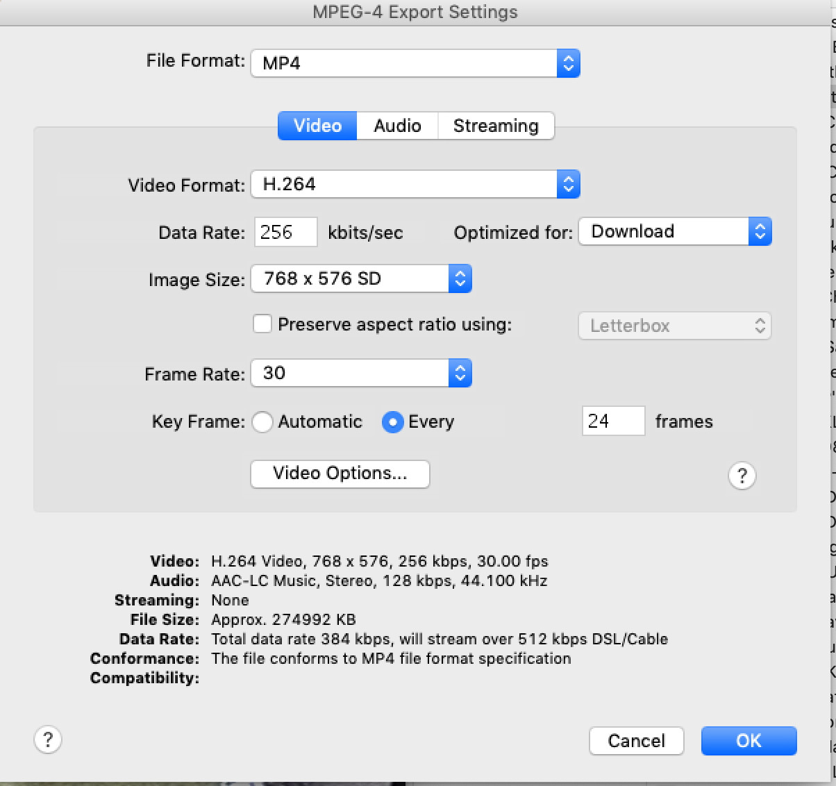

    As I kind of implied in the other thread, see if you can capture 720x576 at the original (25 fps) frame rate.

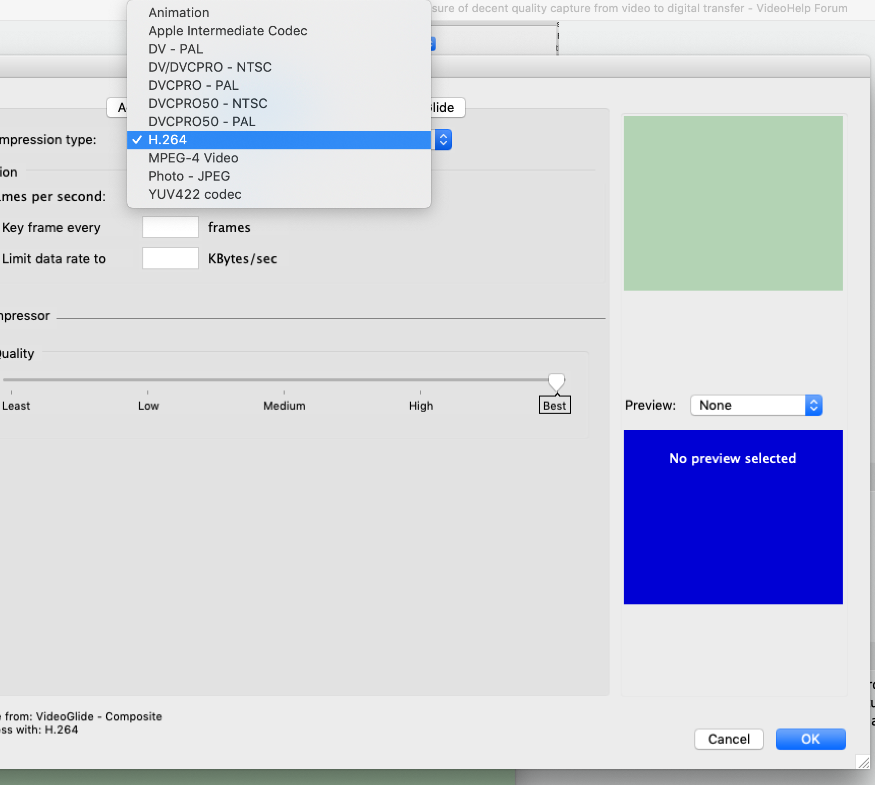

    In your image above, what other options are there for "Video Format", and "Optimized for",
    also what shows up if you click on "Video options"
  3. Yes, PAL video should be captured at 720x576 25 fps. You should see comb artifacts when capturing camcorder video -- it's a natively interlaced format. You need to set your h.264 encoder to encode interlaced. Actually h.264 compression shouldn't be used for capture. Use a fast lossless codec like huffyuv to avoid any detail loss. Worry about compression later. If you're capturing audio (even silent audio) don't use any audio compression. Use s-video cables whenever possible. Post a sample capture for more detaild analysis.
    Aug 2006

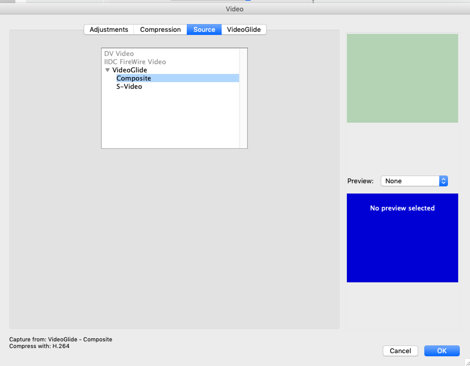

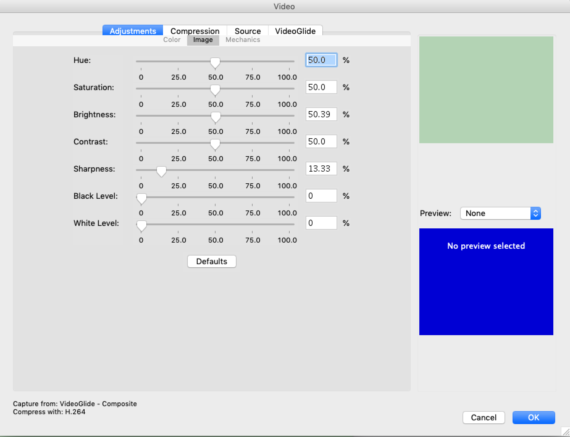

    Hi everyone, firstly may I wish everyone a safe transition during this challenging period we are all facing, where ever you are living. I am in the UK and thank you for responding to my thread. I have attached screenshots of the options available to me with VideoGlide, to help in the conversation.Image
    [Attachment 52400 - Click to enlarge]
    [Attachment 52401 - Click to enlarge]
    [Attachment 52402 - Click to enlarge]
    [Attachment 52403 - Click to enlarge]
    [Attachment 52404 - Click to enlarge]

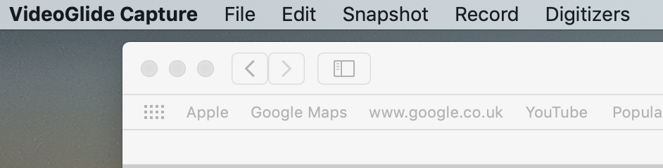

    I shall do as davexnet suggests and record some footage at 25fps, but to answer his other question, I don't have 'Video Options'. To answer jagabo, I don't have the option to encode interlace. I will look at huffyyuv and I will invest in an s-video cable and then I post again.

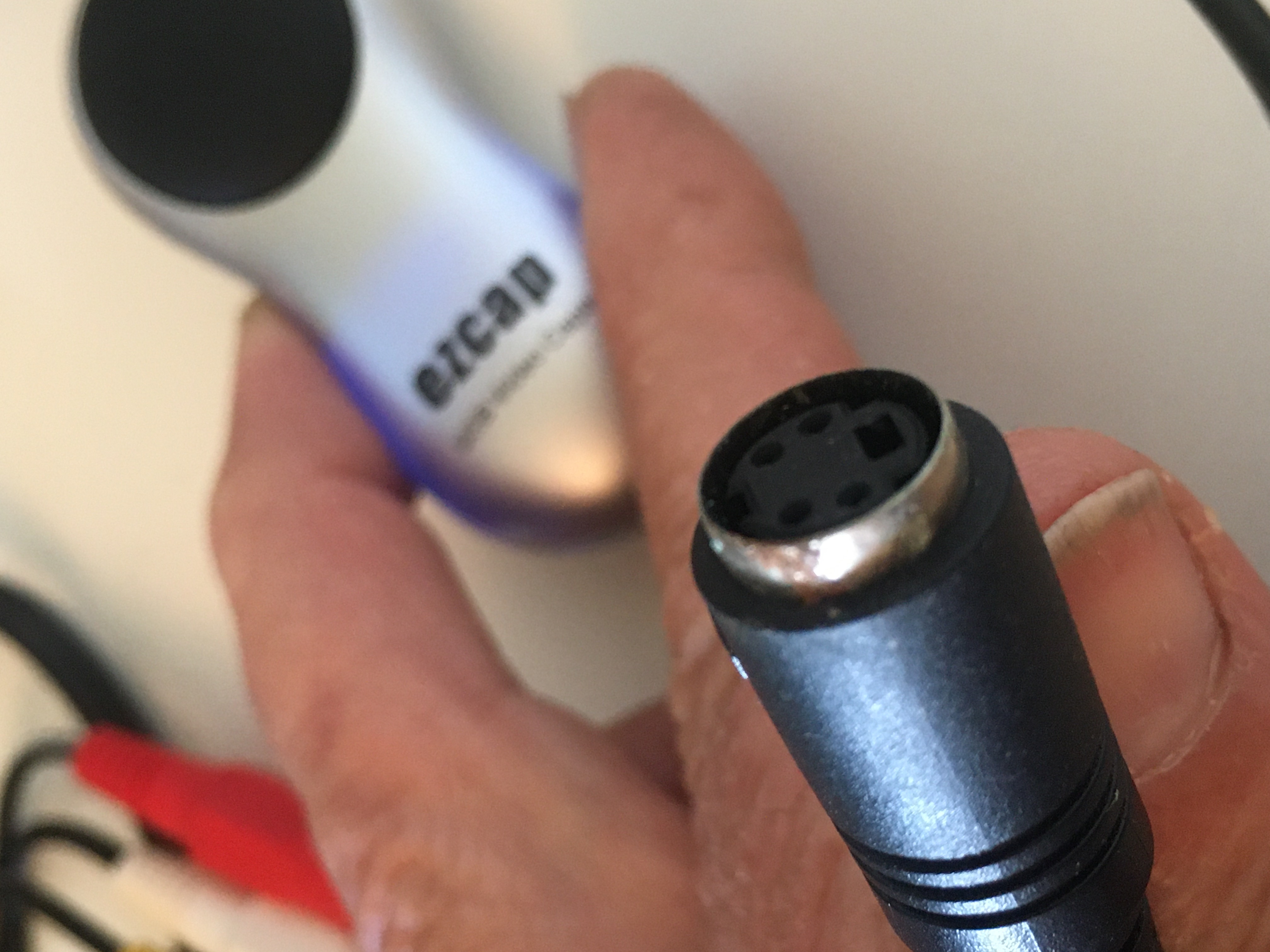

    I also have a query about s-video cables. I have attached 2 images go either end. One end is the camera and the other is the Video Capture dongleImage
    [Attachment 52406 - Click to enlarge]
    [Attachment 52407 - Click to enlarge]
    What cable do I need to buy in order to attach at both ends. plug to socket for both ends? Are they even available, or maybe a jack extension?

    I would try some of the other choices available, eg. dvcpro50. 720x576
    Capture 30 seconds and post it here

    Note also, dv50 codec is a lossy codec, as is prores, but prores is a much higher bitrate and is considered "visually lossless", while dv50 is NOT. Even dv100 is at a disadvantage compared to prores.
    Prores' equivalent quality level competitors are usually considered to be cineform and dnxhd and possibly edius hqx.
  19. Formerly 'vaporeon800' Brad's Avatar
    Apr 2001
    Vancouver, Canada
    The highest quality option is YUV422, which is uncompressed. But you'd need the storage and uninterrupted write speed to handle it.
    Animation is "lossless" but may force a conversion to RGB. Couldn't find definitive info.
    Have you had any luck getting ProRes to work?

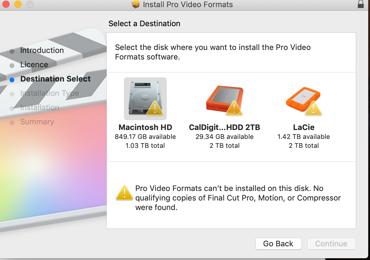

    Thankyou very much to both Scott and Vapareon for your research and effort looking for a solution, but having tried both the methods Scott suggests, I am no further forward. With option one, I get no further than Image
    [Attachment 52501 - Click to enlarge]

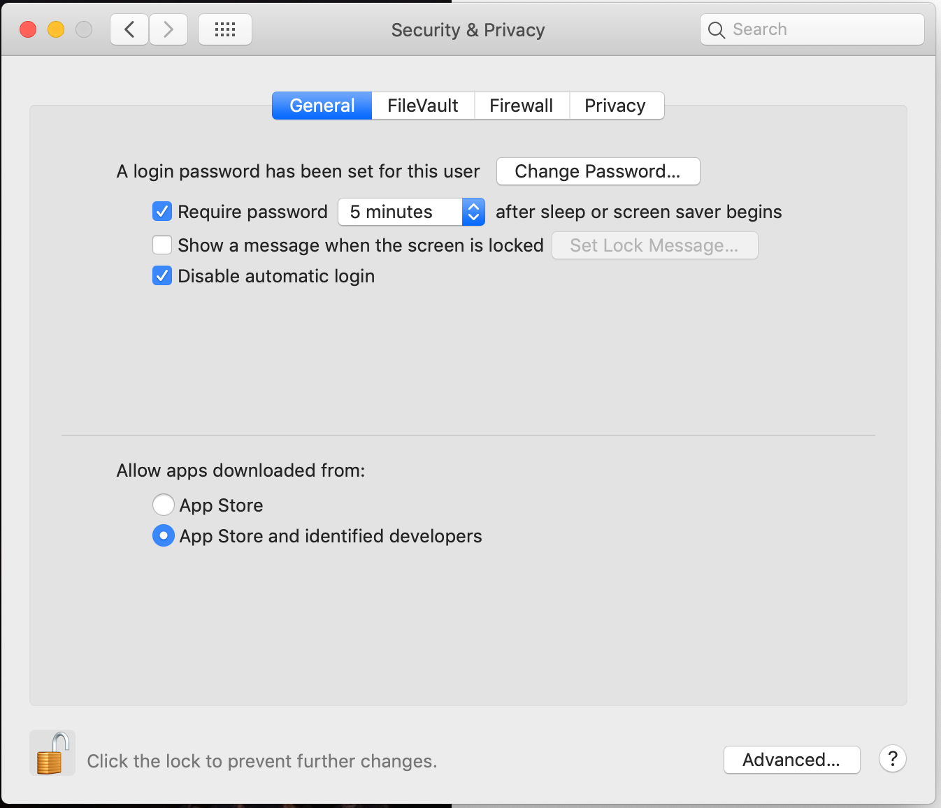

    this, then similarly with option 2 having followed the instructions I end up at the same dead end. I then tried option 3 on the link page https://support.apple.com/guide/mac-help/open-a-mac-app-from-an-unidentified-developer...0.14/mac/10.14.
    and tried to find the 'Open app anyway' button, stated as being in there, but there is nothing Image
    [Attachment 52502 - Click to enlarge]
    there, not even in Advanced.

    I have captured the same clip several different ways using the same EzGrabber Videoglide usb and software. All the results are pretty mixed but frankly I can't tell a huge amount of difference between them. I have also considered buying a used camcorder that has firewire to see if the results would be any better there. Is there any other usb capture software that might be better?
  22. Member
    Mar 2008
    Generally it's better to capture with the interlacing intact, it maintains the fluidity of motion
    from the 50 fields p/s. giving you more flexibility when you convert for your delivery format(s)
    whether it's a DVD, streaming to the TV, or PC viewing version.
    If you intend to upscale for use on the PC or where ever, you can use software (Avisynth) to de-interlace with good quality
    to create a 50 fps progressive file
    The Apple intermediate code appears to be deinterlaced, the DVCPro50 has the interlacing, top field first, 4:2:2 chroma sub-sampling
    to maintain more color information from the capture.
    I haven't looked at the others. I'm sure you'll get a variety of different opinions on this.

    Thanks for your input Davexnet, I guess the basic questions I would like to know the answers to are, with all these usb video capture products one can buy-Are they basically all the same? Am I going to get a similar result whatever I use? What IS the software used in the USB capture devices? Having used the s-video cable for this batch of clips, I can't see any appreciable difference between them and the composite ones, which leads me to wonder if I'm wasting my time looking for better quality
    Theoretically the S-video cable should give a cleaner result because it keeps the luma and chroma separate on two different wires.
    In practice though not everybody see the difference and some have had a better result with the composite
    The USB device contains a hardware chip that converts the analog signal into a digital stream to be further processed by your capture software.
    The difference is that HW chip, different brands/devices differ in the A/D conversion quality and/or other benefits, such as being able to maintain
    stability when the incoming signal degrades due to a poor tape, etc,etc.

    As a postscript to this discussion, I have been in touch with Echofx Support and have been advised that YUV422 codec is the best to use and then iMovie to de interlace. So that is what I shall do, accepting that this is a lossy method.
