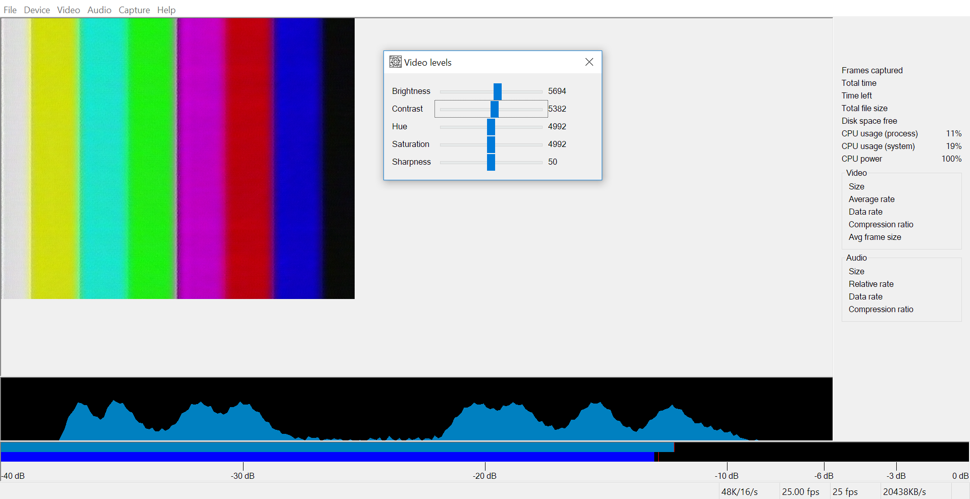

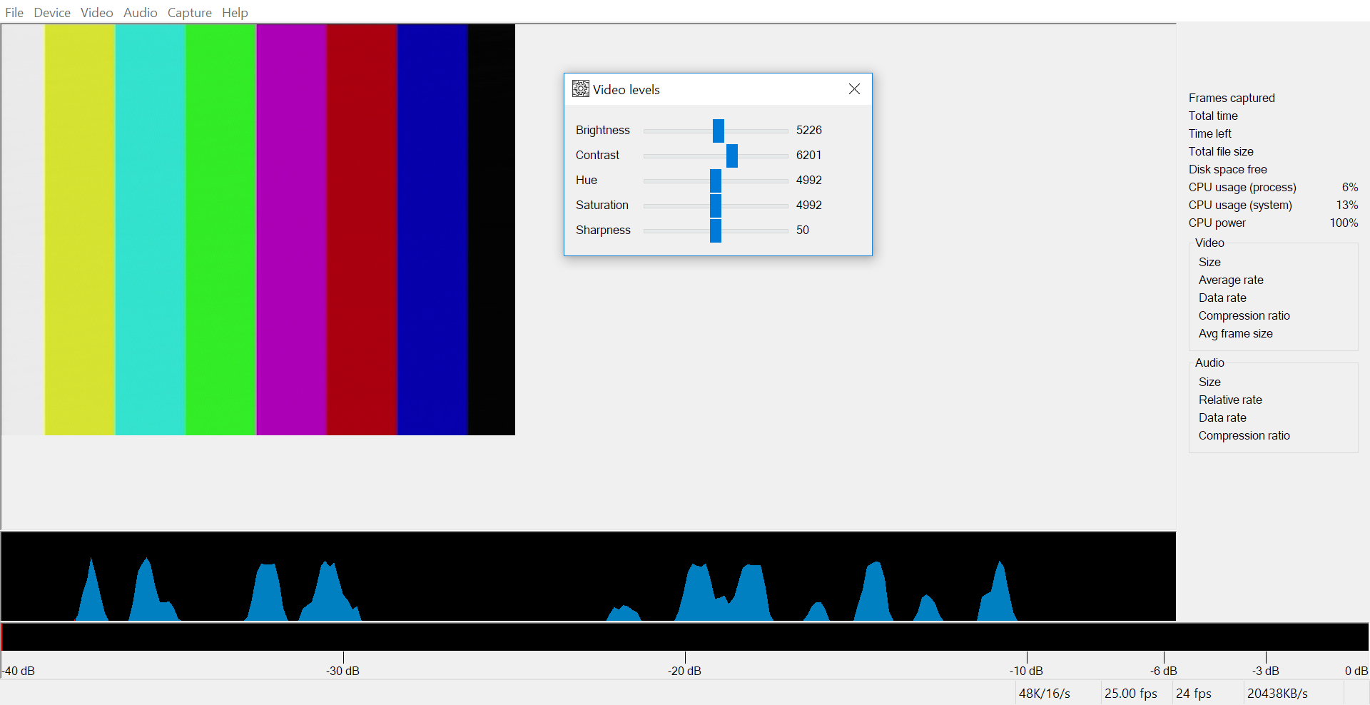

    Here are some colour bars then. Interesting to see the difference between the DVD source and VHS transfer in the two screenshots. I think the colours are fairly close, all things considered.
    I'm slightly worried about the audible harmonic distortion, though it's not something I've heard when testing normal VHS tapes...
Name:	Colour Bars (DVD).PNG
Name:	Colour Bars (VHS).PNG
