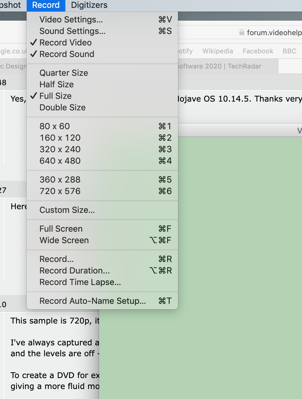

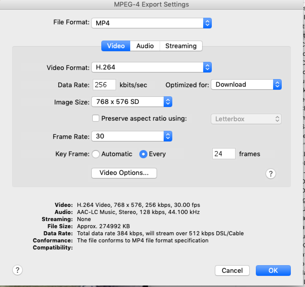

    [Attachment 52384 - Click to enlarge]
    [Attachment 52385 - Click to enlarge]
    From the capture menu, when I am due to digitise a tape, there are a number of options. 720p is the largest option available and I set the frame rate at 30. I've attached a couple of screen shots of what I've done. I would also say I have just started digitising another tape using a a higher frame rate of 50 and the difference is quite marked. It is sharper, the blacks seem much puncher and the general exposure seems right, not over exposed. I've read about what de-interlacing is, and I'm guessing that is something that has been done by the capture software as I have not changed that.

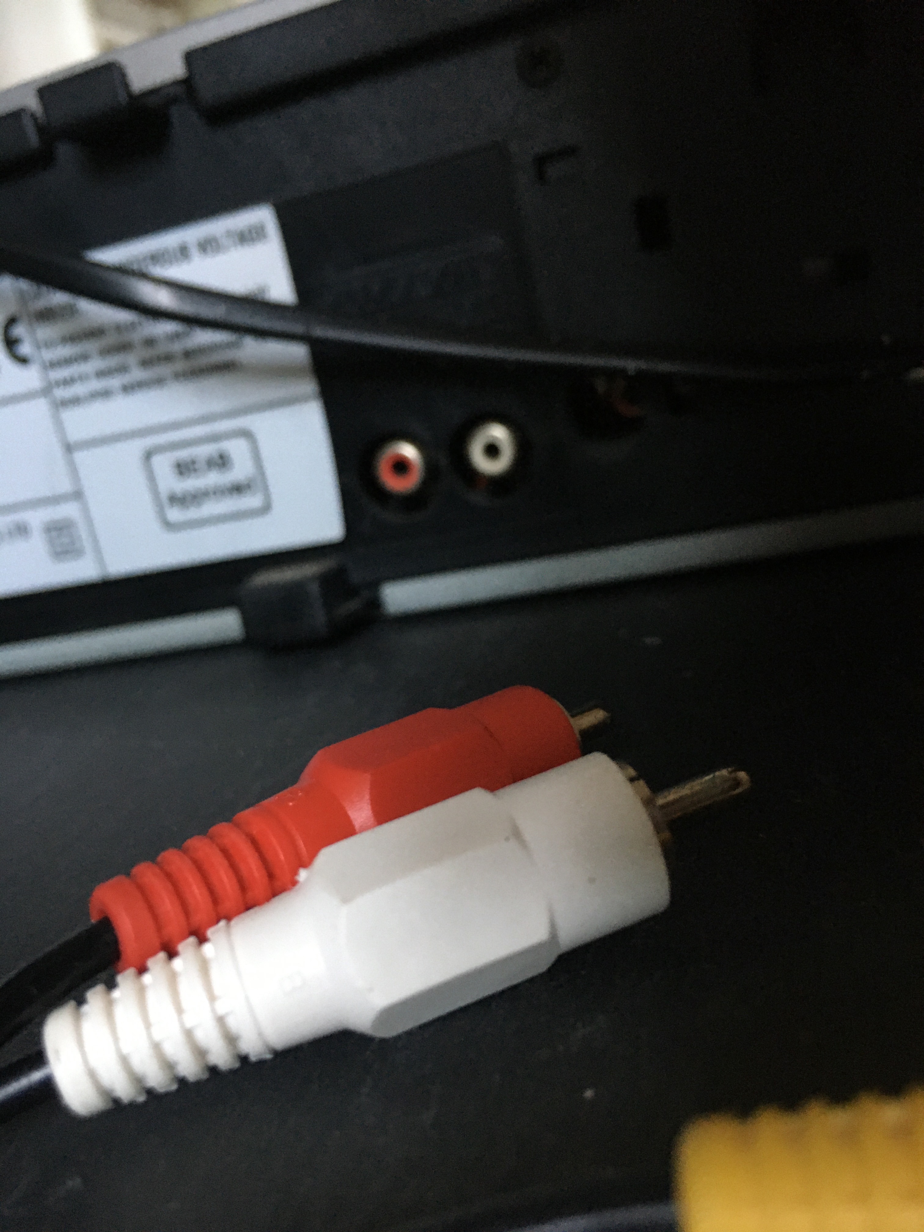

    Well, further to my exploits digitising my Hi8 tapes. I have now converted all 42 tapes to mp4 using iMovie and my Sony camera. The quality is ok for my purposes so I can now play around with editing them and making them a bit more contemporary! I also have a few VHS tapes that I would like to digitise as well. I understood the software I have been using to date, EZGrab, would do the job, but to my disappointment, it doesn't. It would seem simple enough given all the youtube clips I have watched and seen people doing exact same thing, but alas no. I have a standard VHS tape recorder. I even have the adapter where I plug in the three cables (white, red and yellow) and then plug that into the Scart socket on the back of the recorder. Alas, nothing. I tried plugging in the cables into the sockets on the front as well and still nothing. The process is the same isn't it? Image
    [Attachment 53316 - Click to enlarge]
    [Attachment 53317 - Click to enlarge]
    [Attachment 53318 - Click to enlarge]
    [Attachment 53319 - Click to enlarge]
    [Attachment 53320 - Click to enlarge]

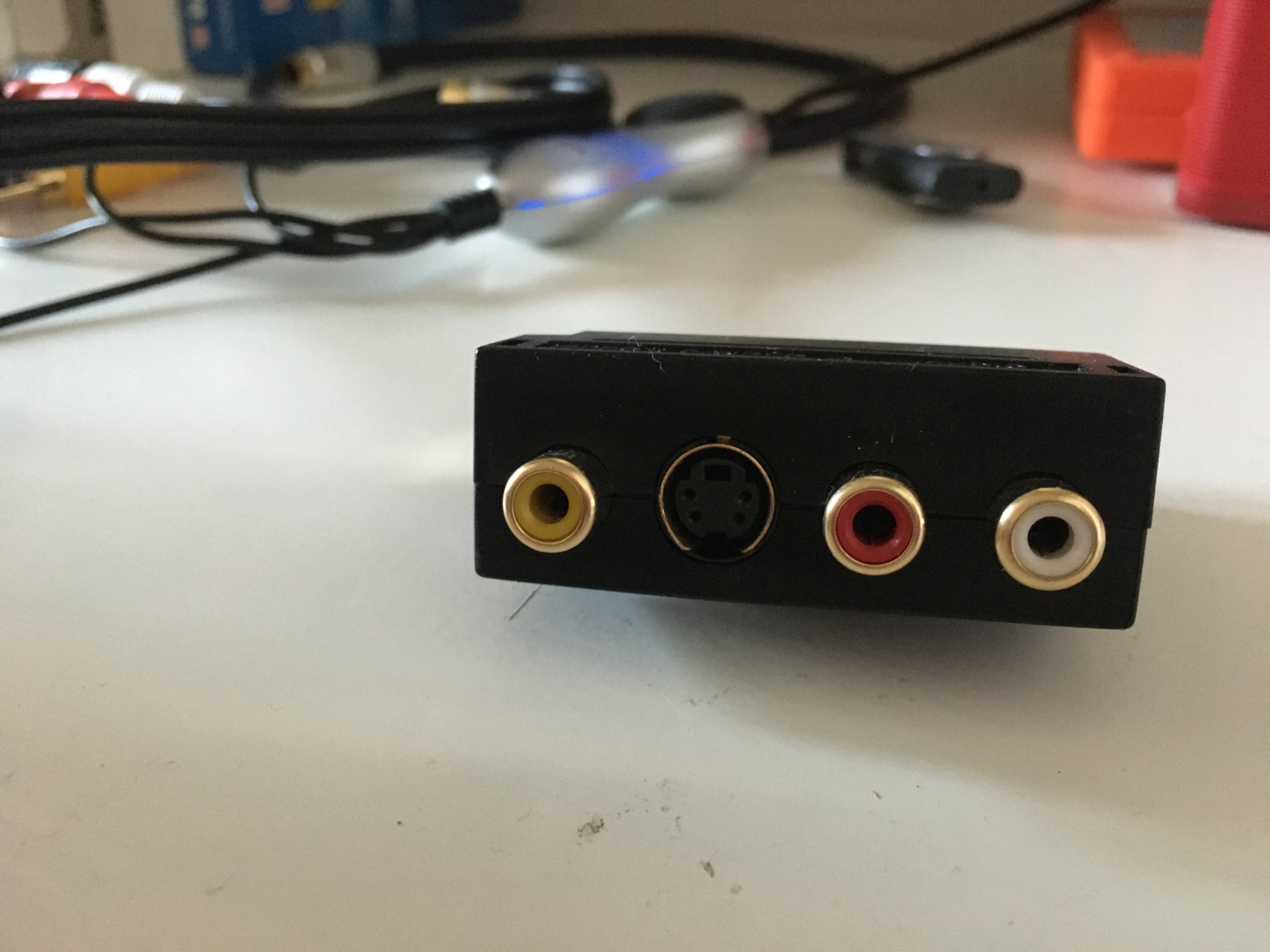

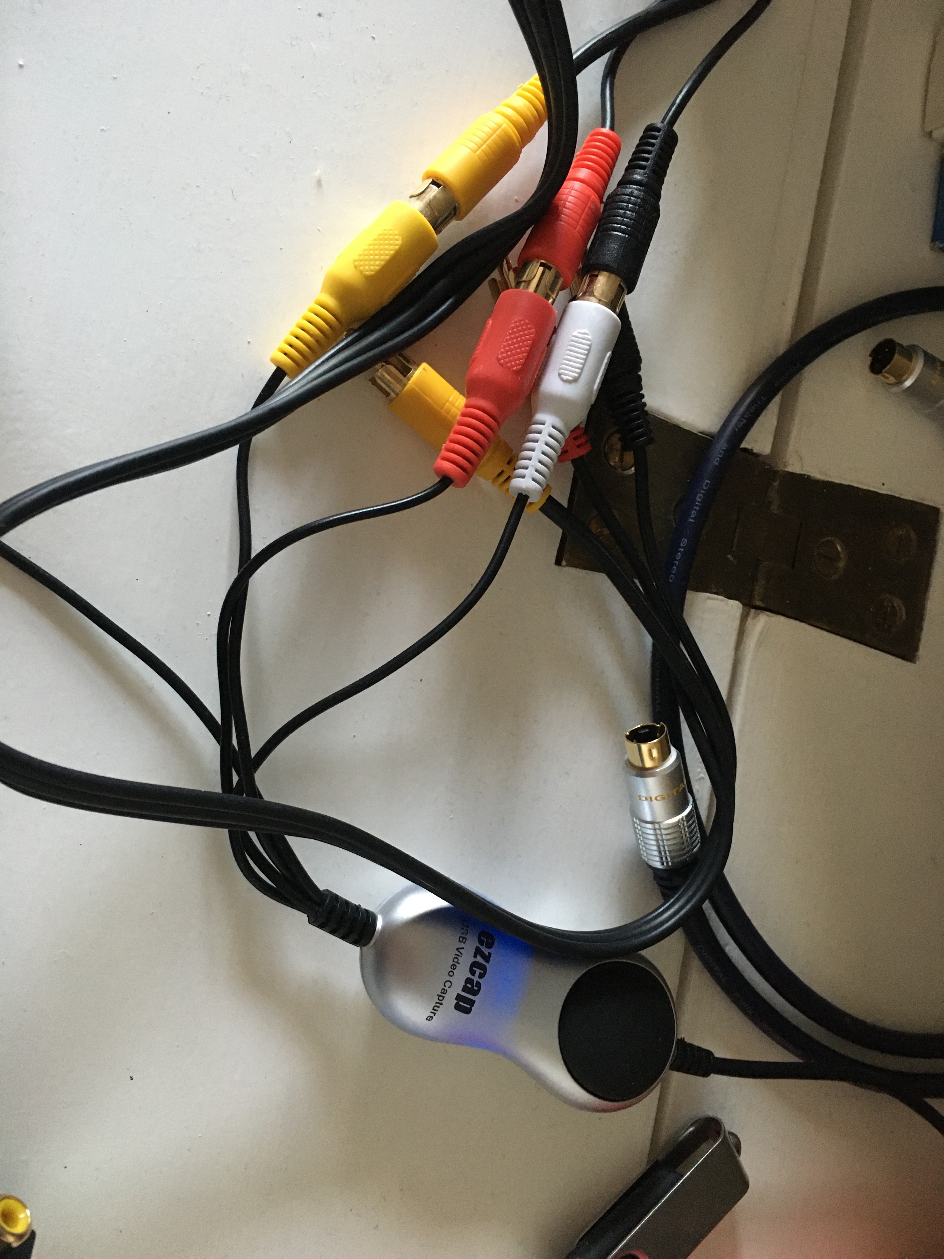

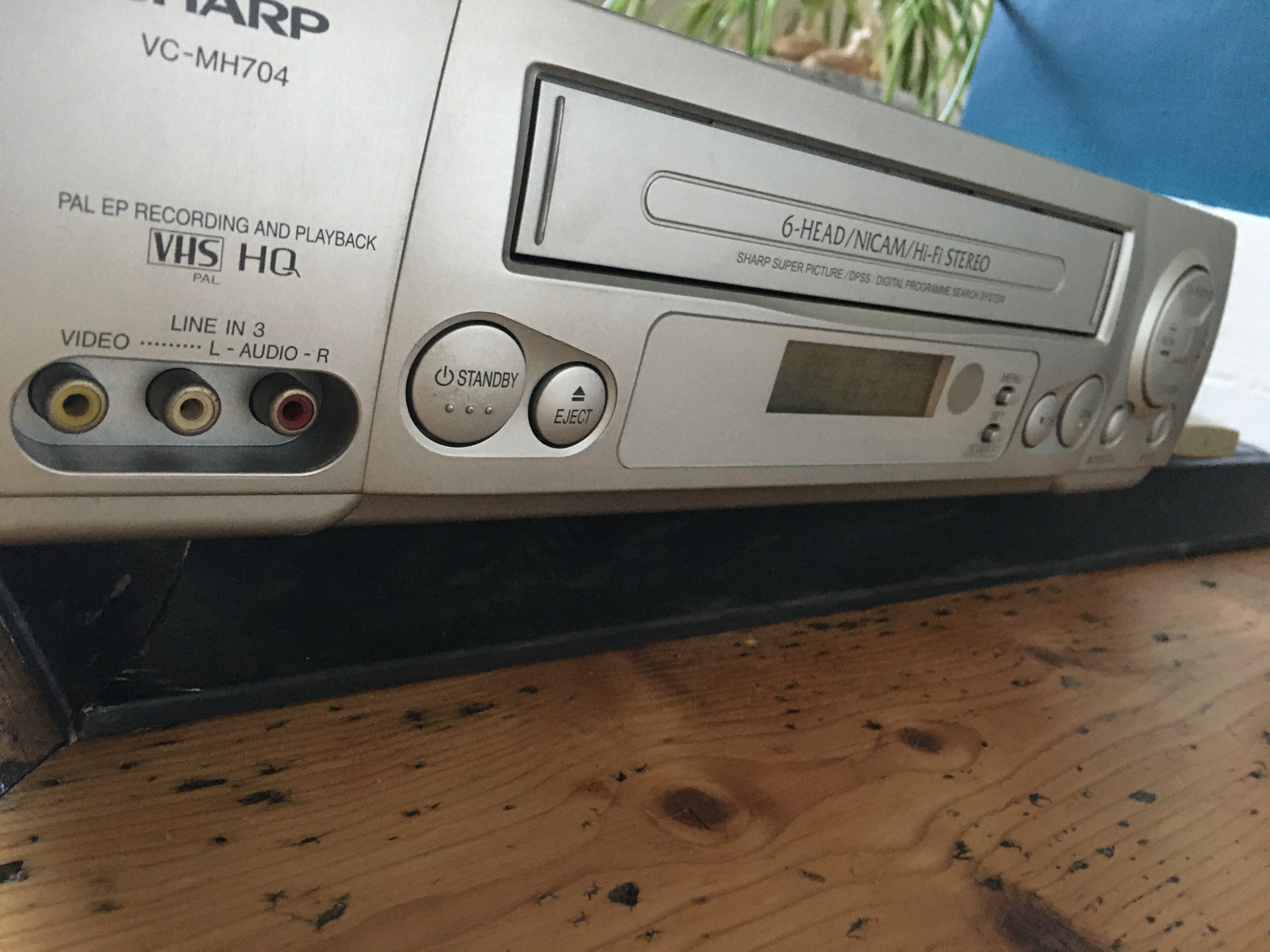

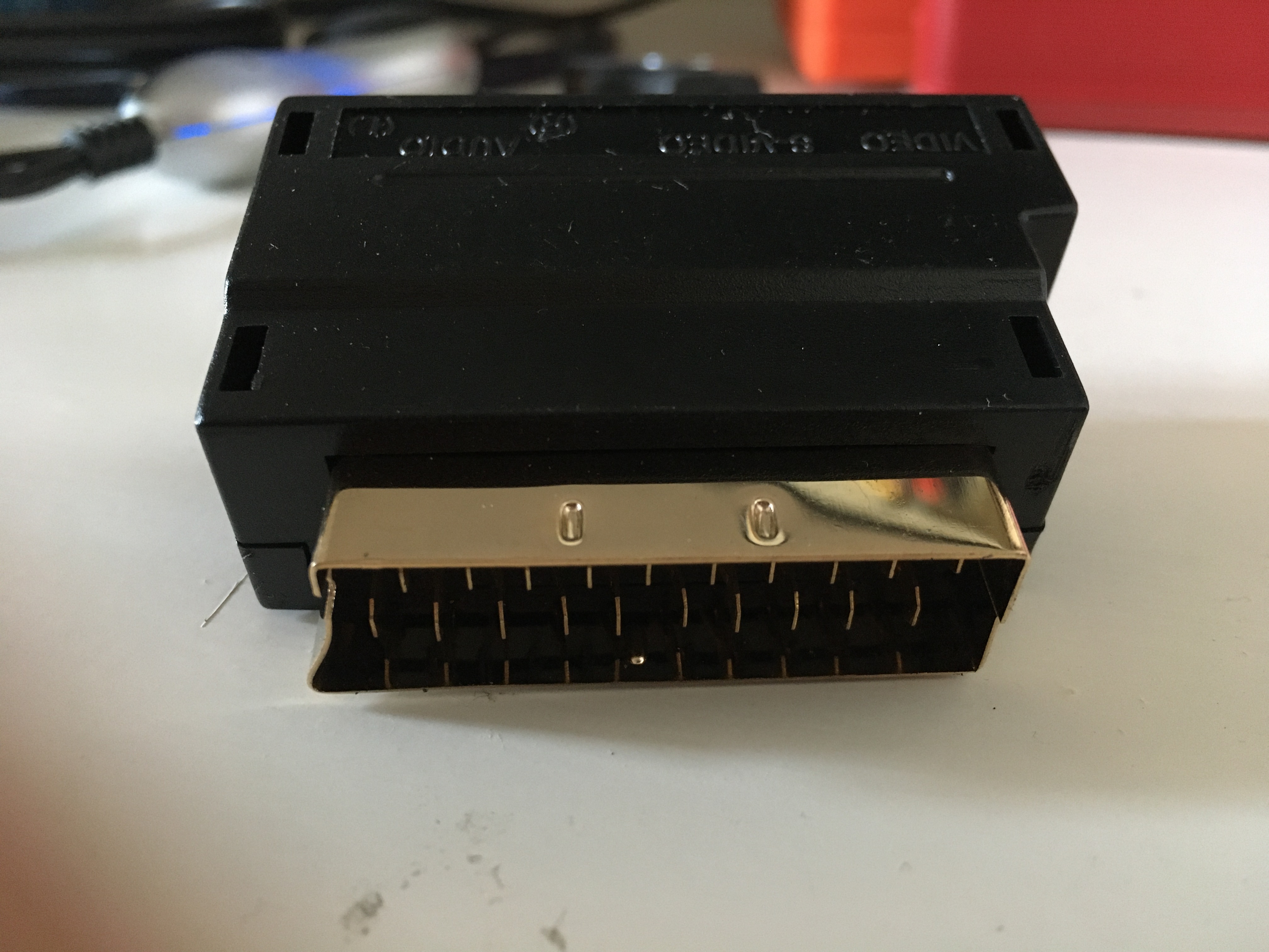

    Can anyone suggest what if anything I may be doing wrong? I'v included images of the kit for ease.

    I'm trying to connect my VHS VCR to my Mac via EZCap software and dongle, which I have successfully being using for weeks now, transferring all my Hi8 tapes. I am now trying to convert my VHS tapes from my VCR to the Mac. I'm not trying to connect my Sony camera to my Mac.

    connect the yellow - red & white cable to the video out (on the back of the vcr) then press the video input button on the remote to L2
    then play a tape and try capturing your tape.

    have you tried connecting to the L1 connection on the back of the VCR ??
    might also try pressing the TV/VCR button on the remote control
    try doing a factory reset on the VCR

    Hi October262, yes I have. I've tried every combination of the wires and the scart adaptor. I've pressed the TV/VCR button, as you suggested. Nothing makes any difference. I have no idea how, if at all possible, to do a factory reset to the VCR. I've had a look on line at the instruction manual but can find no reference to a 'Factory reset'. I have even contacted Sharp to ask for some guidance with that. I don't expect any assistance with the main issue, but who knows! I wait with low expectation, then I can't be disappointed!

    found the factory reset page for your vcr - https://servlib.com/sharp/vcr/vc-mh704-sm7.html?start=39
  18. Nikonitis
    Feb 2020
    Andover Hampshire UK
    October262, I am indebted to you. It worked! I had trawled the internet for ages with no success, so Thankyou. I reset the VCR, a blue screen appeared with the clock and date settings ready for adjustment. As soon as I had inputed the right time and date etc, pressed play, the video started playing. Amazing! I am now in the process of recording. And to be fair, the results thus far, are not that different to the results of of my Hi8 tapes. I would be interested to try other software to compare quality, but for now this will do. At least I have a result!
