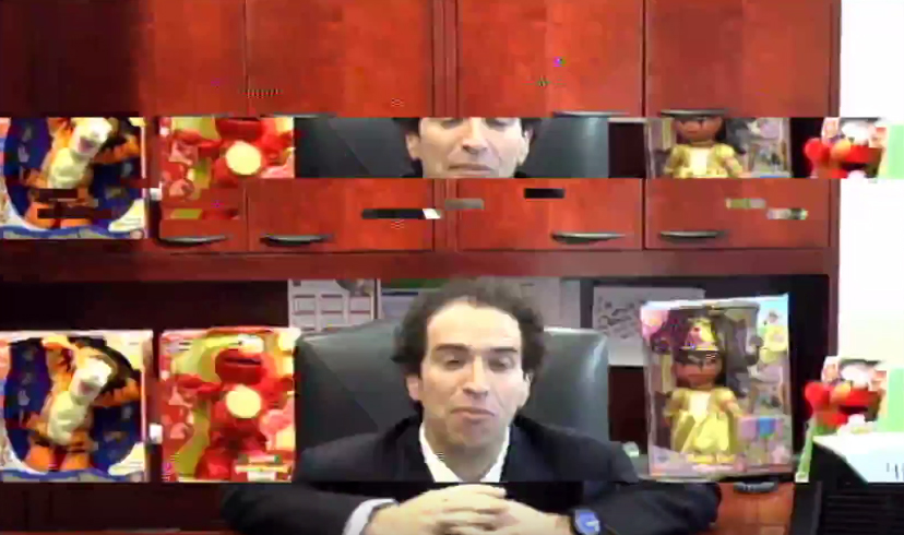

    I have been going through alot of old DV tapes and most of them are working fine. But there are a handfull of them that have a bizzar distortion. I'm not super familure with DV trouble shooting so i dont know what this specific type of error or distortion is called. Can anyone help?
    Sample Video capture of problem starts at 00:10
    https://youtu.be/BMVdSgvN6Sk
    [Attachment 52350 - Click to enlarge]

  6. Is the distortion continuous or intermittent? Does the tape appear to be playing at normal speed or is it sped up or slowed down? Are you certain these were recorded as DV and not DVCam or other similar flavor?
    (And your capture method is a nightmare. You should always use firewire for DV. Though it appears that is not the source of your problem.)

    the distortion is continuous, and it looks like the normal speed. the video link will show you what i see. All the tapes have MiniDV printed on them. Could a DVCAM format be put on a MINIDV by a DVCAM camera or VCR?

  12. Member Cornucopia's Avatar
    The answer is yes, miniDV is the consumer format, but kind of really the shell size. The smallest size usable with DVCAM and DVCPro is equal to the the consumer format's size, so it could be that they were used inappropriately.
    However, it shouldn't have been able to be put on a consumer tape - (if memory serves) there are little flagdoors that help determine compatibility.
    But even if dvcam or dvcpro is put on one of the standard minidv tapes, a regular consumer minidv deck CANNOT play back dvcam nor dvcpro, unless they specifically, explicitly advertise as such. Both formats have a completely different track pitch and tape speed.
  13. Didn't notice your YouTube link before.
    Looks like the camera is trying valiantly to lock onto the sync and fill in the gaps. There's very little pixel breakup or static which is promising. You need to dig deeper into the speed issues already suggested -- PAL/NTSC, SP/LP, DV/DVCam. You're in L.A., you can surely find another camera or deck to try.
    Based on your YouTube I'm leaning more towards LP/SP right now. LP requires finer tolerances for proper playback.

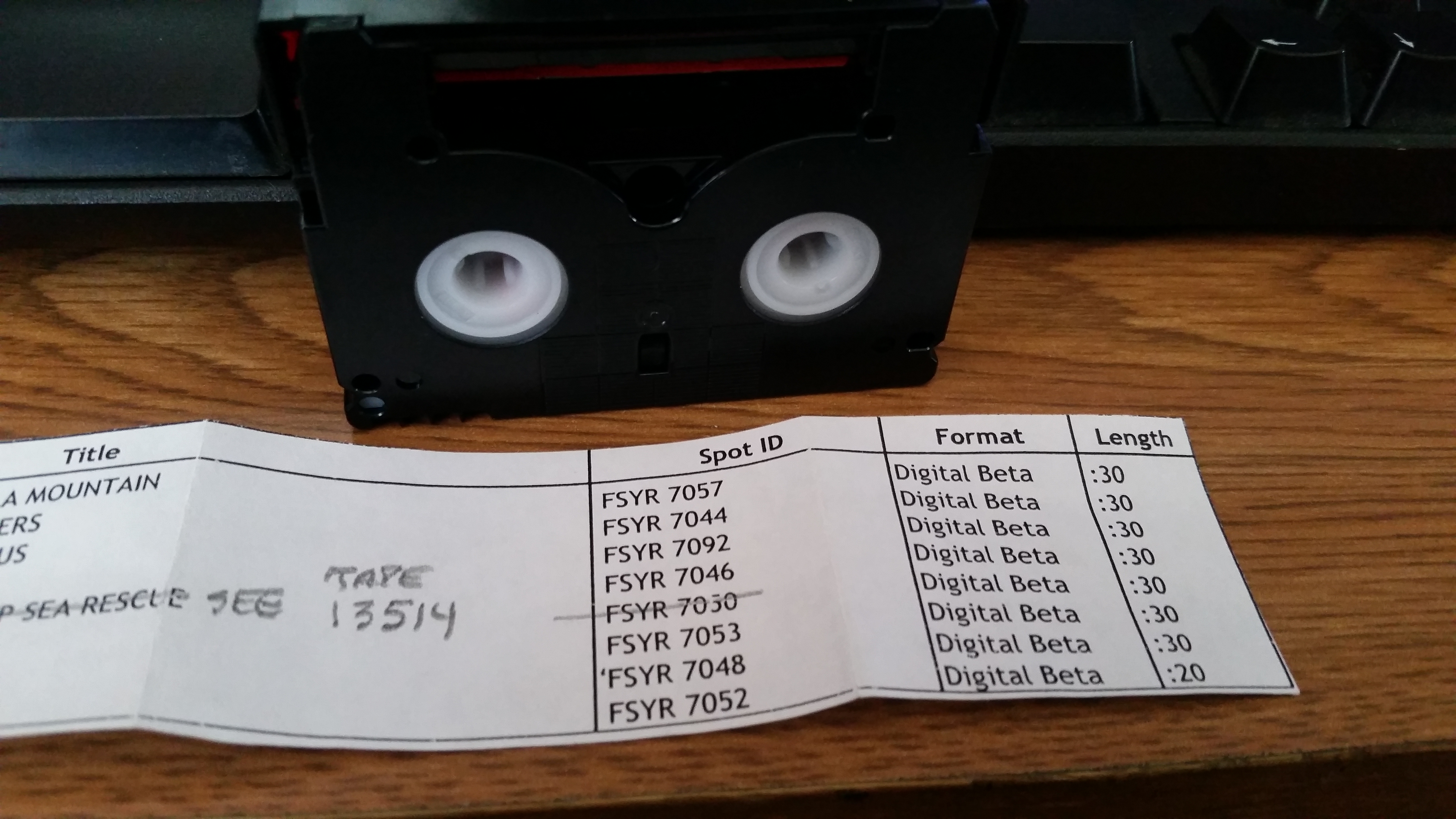

    So, just an update. The tape formats are "digital beta"

    [Attachment 52582 - Click to enlarge]
    no, i found a label on one of the tapes ( i have a stack of them) its marked as digital beta. thats the first and only clue ive found as to what they are. not trolling.

  20. Formerly 'vaporeon800' Brad's Avatar
    Apr 2001
    Vancouver, Canada
    i found a label on one of the tapes ... marked as digital beta. thats the first and only clue ive found as to what they are.
    If the tape has the MiniDV logo on it, it's MiniDV. That little printout is probably just noting the source format that your copy was dubbed from (Digital Betacam aka Digibeta).
