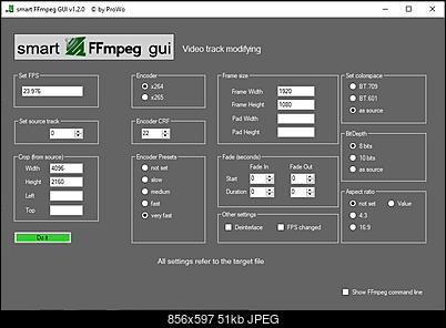

  6. You can resize it and do 10bit to 8bit reencode with my smart FFMpeg gui
    https://forum.videohelp.com/threads/395425-New-small-GUI-for-FFmpeg

  7. Prowo, man, we all love to shove our beloved creation to everyone, but if you do this too much, it becomes a pollution, especially if you do it without any explanation.
    Besides almost any GUI can scale down like that,
    how do you set error diffusion in your GUI, dithering from 10 to 8 bit and how do you set downscale method?
  8. Originally Posted by _Al_ View Post
    Hi _A|_
    only meant to help
