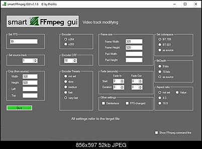

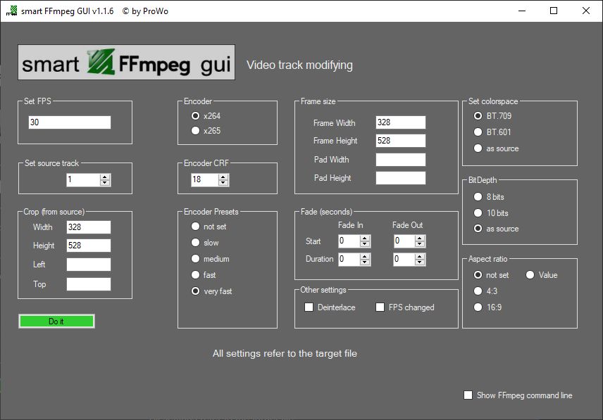

  13. You can crop the black borders with my smart FFMpeg gui https://forum.videohelp.com/threads/395425-New-small-GUI-for-FFmpeg
    Modify video track, select as source file your IMG_5504.mov (select all files first, to the right bottom), target file is automatically selected, next, yes without crop detect, next, (on the next screen set all like picture).
    Do it, after the reencoding has finished click Main to return to the main screen.

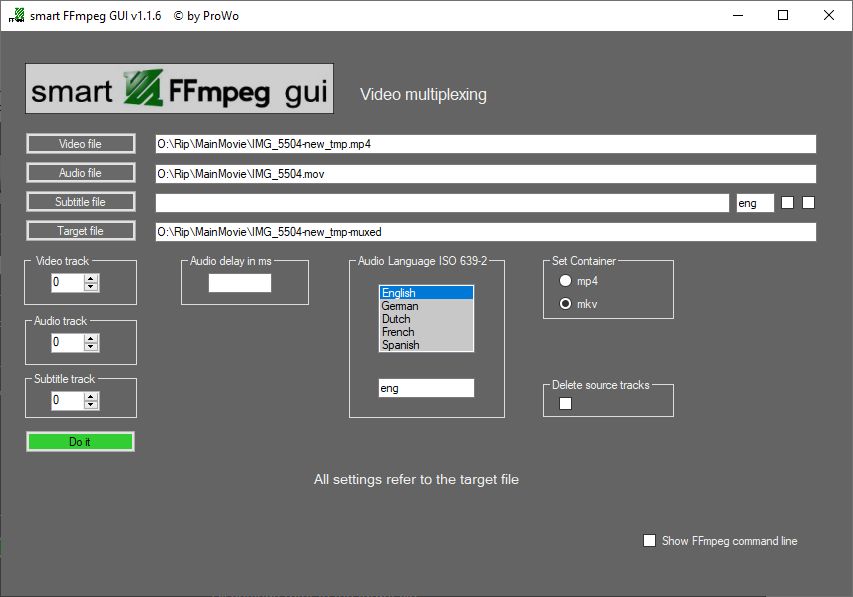

    Click on Multiplex and set all like picture, do it. The IMG_5504-new_tmp-muxed.mkv is your result.
