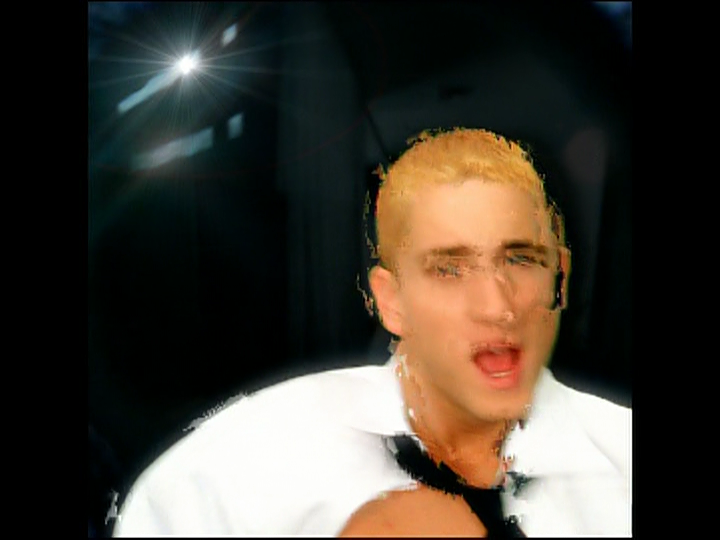

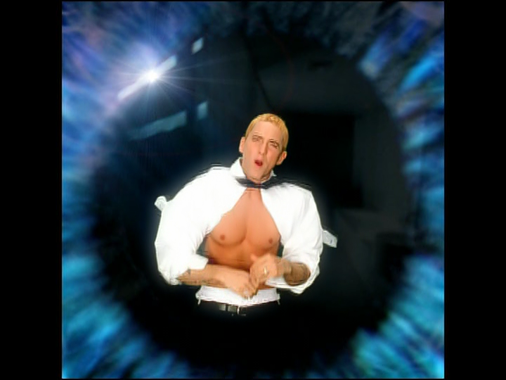

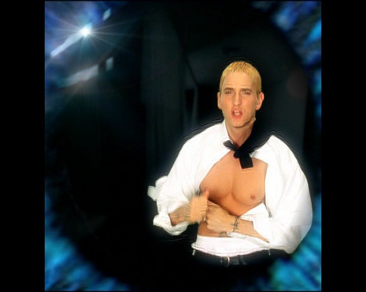

  1. Took a jab at restoring an old music video again... everything was going good until I hit a roadblock. I do not know how to remedy these three artifacts seen in the pics below.
    1
    [Attachment 52297 - Click to enlarge]
    2
    [Attachment 52298 - Click to enlarge]
    3
    [Attachment 52299 - Click to enlarge]

    It seems the second one helped slightly for the "breaking (?)" artifact, but otherwise no change.

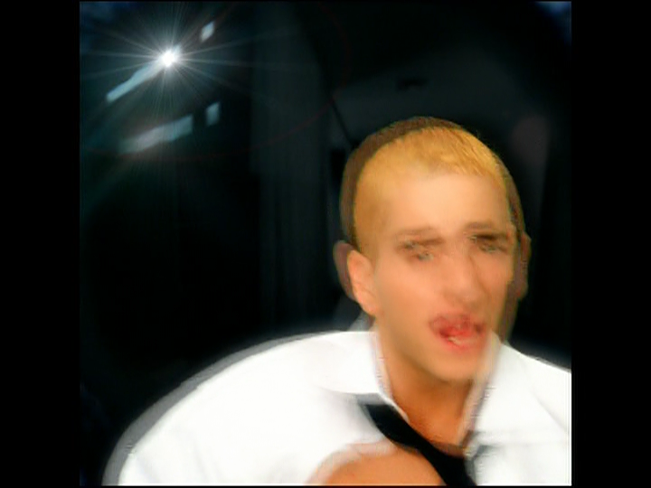

  15. To get rid of the blending start with:
    QTGMC() # or Yadif(mode=1) or your favorite bob deinterlacer
    SRestore()
    That leaves artifacts like these (especially visible over his shoulders):
    [Attachment 52334 - Click to enlarge]
    You can blur those away if you can figure out how to isolate them

    Yes! Tried it out seemed to have fixed the blending. Thanks. Only problem is now I get a bouncy or jerky type motion sometimes which fluctuates depending on which field order I assume...
    EDIT: If I use Yadif instead of QTGMC, the jerkiness goes away.. but my golly does Yadif look like trash compared to QTGMC.
  17. What source filter are you using? For MPG/VOB you should use DgIndex to build an index then open the video via that index file with Mpeg2Source("filename.d2v"). That source filter is very good at handling out-of-order frame requests. QTGMC() in a situation like this is very likely to make out-of-order requests. Mpeg2Source() will automatically set the field order too. But your source is TFF so it wouldn't hurt to put AssumeTFF() right after Mpeg2Source().
    Also, SRestore() can take several/many frames to lock onto the unblended frames. It doesn't work well if you random seek around the video in an editor. But it should work well when you encode the video from start to end.
  18. Originally Posted by jagabo View Post
    Ah, yes. That makes since. I rendered out the video and the jerkyness is gone. Great! I guess that only leaves the weird artifact you noticed before. Very strange artifact... mosqutioNR has a slight effect on it but its still very visible...
